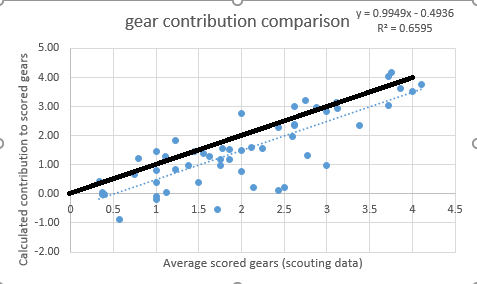

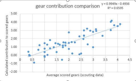

I will opine, based on comparing OPR to our team’s scouting data this year, that OPR is a rather poor robot metric for steamworks.
I think “total points” OPR is a poor metric, but OPR along individual segments of the game (ex. auto, fuel, gears, climbing) has been pretty inline with our scouting data at both of 254’s events.
Even gears?
It certainly seemed like it for us at Iowa.
Weeks 1thru7 World Component OPR](https://www.chiefdelphi.com/media/papers/download/5048) based on qual match data, all on one sheet.
This isn’t what I’d call good, to be honest. Two teams scoring 2.5 gears have zero calculated contribution?

I think it’s worse than that given that not all robots are created equal. For an example, at/near the end of quals at our first event, we had gotten at least auto movement plus climb or auto gear every match (plus we gear cycled). That gives a minimum of 55 points per match. However, our OPR was ~42. If we say that gears average to around 20 points each, and we got about 3 teleop gears per match (I should really ask our scouting team for this data), OPR was 75 points too low.
Here’s the same chart with y=x drawn. It helps to show the undercounting of gears, which is inevitable. From the regression equation, on average is 0.5 gears, but it looks like for 13 teams its a gear or more.

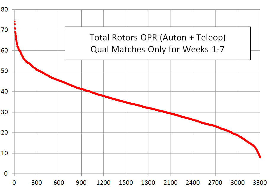

Thanks again, Russ. I added auton + teleop gear OPRs and plotted distribution. Mean is ~32, and 90th percentile is ~50.
Another sharp inflection upward at the high end – 99th percentile is ~63.

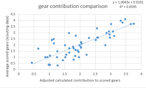

You are looking at the graph wrong. The linear offsets can be easily adjusted out. Here is the same data, just with the axes flipped and a linear adjustment performed on the calculated contributions. Notice that the R^2 value hasn’t changed, so I haven’t changed the data. The standard deviation of errors is 0.6 gears, which gives us a 95% confidence interval of ±1.2 gears. ±1.2 gears seems perfectly reasonable to me, especially when you consider that some teams (like ours) often chose to stop scoring gears when we reached 3 rotors and other teams chose to continue scoring worthless gears.
