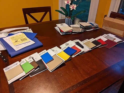

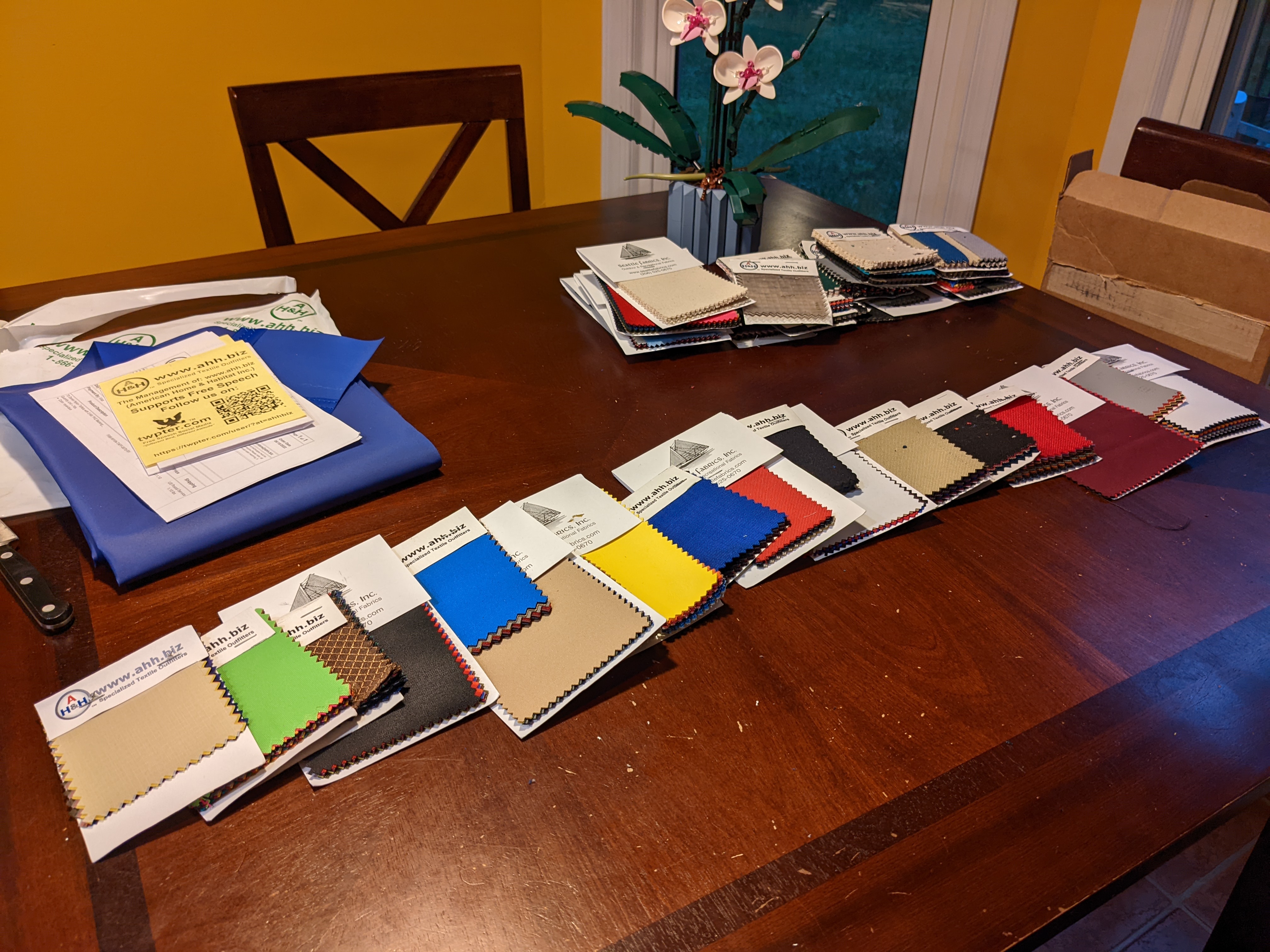

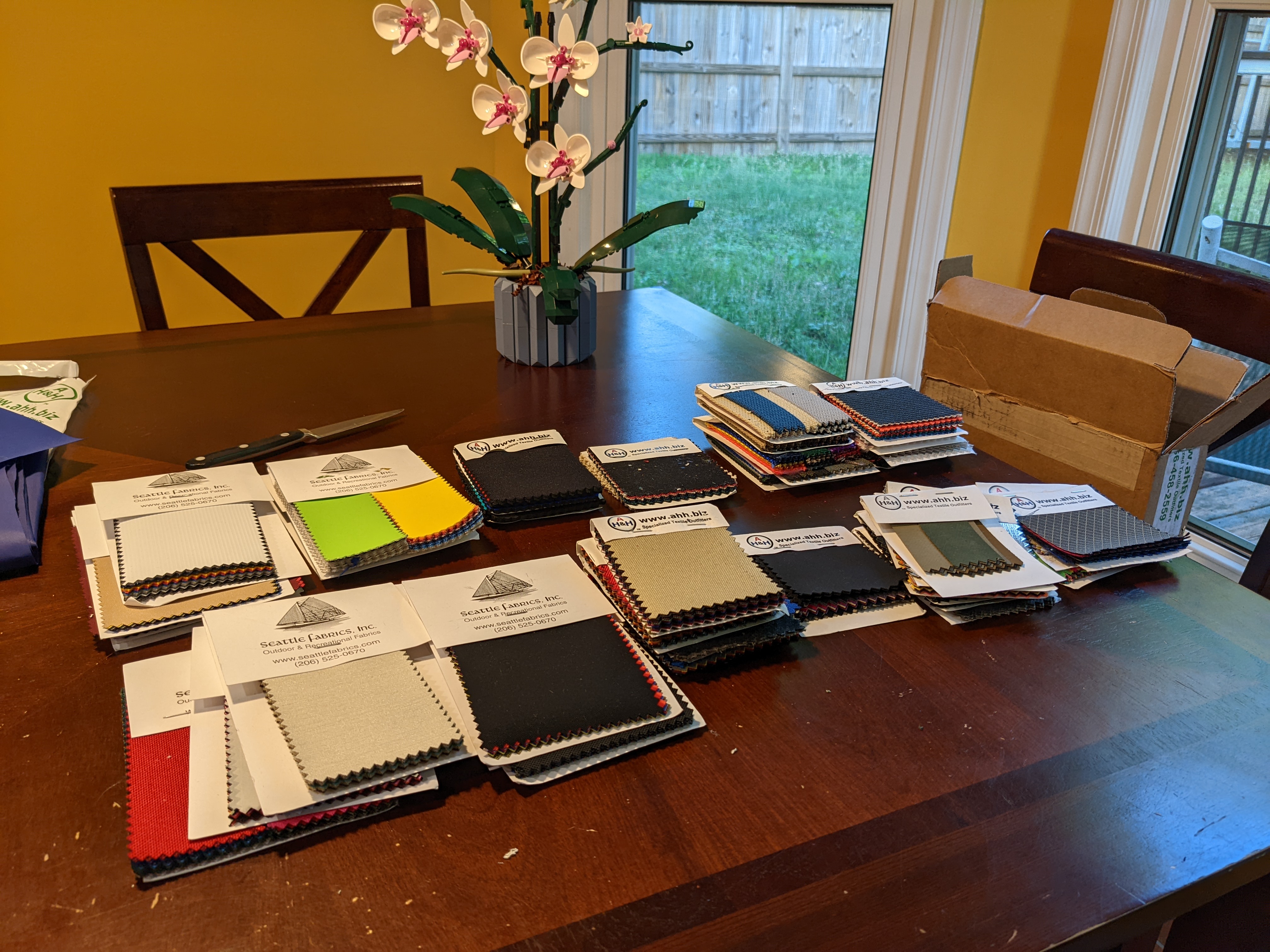

To kick us off, earlier this week I bought 40 books of fabric swatches from two of the biggest weird fabric stores.
In my first pass through the books, to get familiar with them, I first downselected the books where the fabric was available in both red and royal blue colors. I then ripped out a piece of 1000D cordura nylon. Then I ranked the books (subjectively) on the basis of slipperiness versus the scrap piece of 1000D cordura, from slipperiest to stickiest. Here were my results:
  • 400D nylon pack cloth
  • Wrong side of heat sealable Oxford
  • 70D PVC backed nylon taffeta
  • Diamondback composite nylon ripstop
  • Heat sealable Oxford
  • WeatherMax UV resistant polyester
  • Marine grade upholstery vinyl
  • 500D cordura nylon
  • Wrong side of 70D PVC backed nylon taffeta
  • Sur Last urethane coated polyester
  • Neoprene wetsuit material
  • Taslan nylon
  • 600x300D PVC backed nylon
  • 1680D urethane coated Traveler
  • 10 cotton duck
  • 1000D cordura nylon
  • Wrong side of 400D and 500D cordura nylon
  • Wrong side of 1000D cordura nylon
  • Wrong side of 600x300D PVC backed nylon
  • Micro suede polyester
  • Vinyl coated polyester
Here are the books arranged roughly in that order:

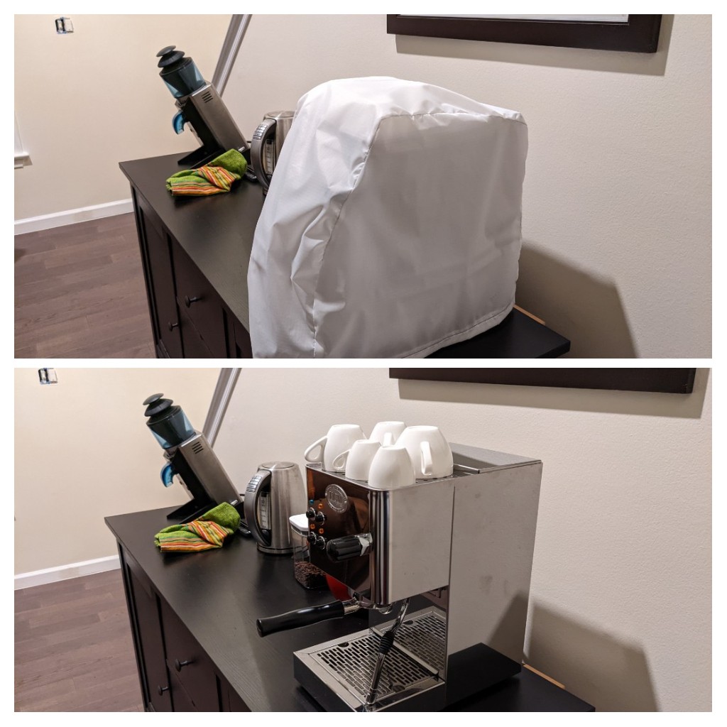

One of the weirder fabrics I came across recently is C-3 Fabric, a tight-weave polyester with a strand of carbon fiber running through it in a grid pattern [1], to give the fabric static dissipative properties in cleanroom environments.
I considered acquiring some to make a cool-looking equipment cover, but just went with regular ripstop nylon instead.

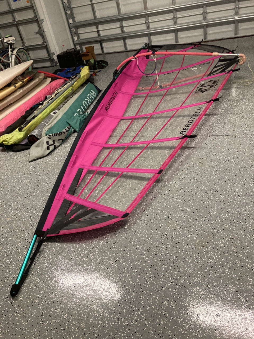

I interact with a lot of modern sail materials. Although I suspect that these days many of them no longer qualify as “fabric”.
As far back as the early 1990s, high performance windsurfing sails were being made with sheets of Kapton film rather than fabric. I still have a bunch of these and they are still going strong.
North Sails started molding sails using a technology that they called 3DL (3D Laminated) technique where the sail was constructed on a molded shape and individual rovings of carbon fiber or kevlar or other fibers were laid down by a gantry type machine (much like 3D printing). These rovings are laminated (heat set) between a thin mylar film coverings on the front and back surface to lock the shape in place. In 2010/2011, they developed a new technique that they call 3Di where, instead of individual rovings, the sails are made by laying down tapes. The sails are still molded on a 3D form using heat to lock in the shape, but the process no longer requires the mylar films as the sails are actually a proper composite construction of fiber and resin.
Since these sail materials are properly defined as fiber reinforced composites, I suspect that they are not purely fabric any more (and would certainly not qualify as bumper material).

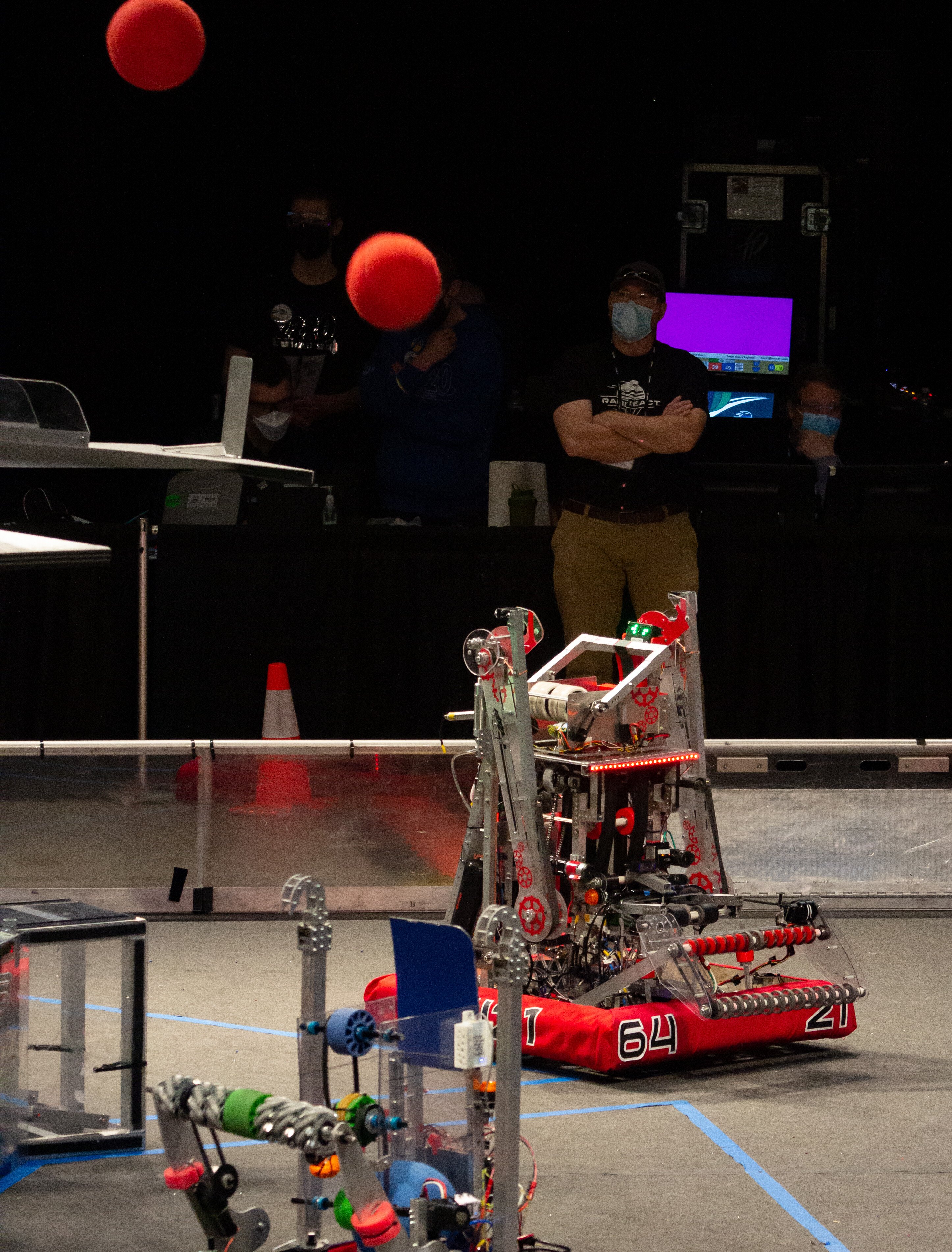

I have no idea what fabric team 4481 was using this year but they had the shiniest bumpers I’ve ever seen.

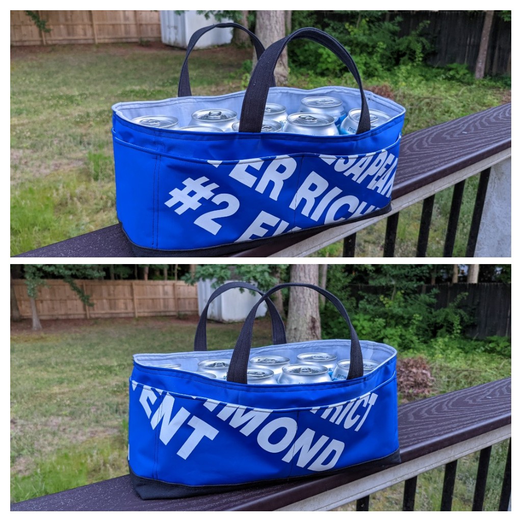

PVC backed nylon taffeta is by all accounts a weird fabric, so it definitely deserves to be discussed in this thread.
It’s also a fabric that every FRC participant sees (and some get to touch!) at every in-season competition we attend, so we’re quite familiar with it already.
Here is some of the material in an atypical application:
You made a beverage cooler out of a blue banner?
I love it.
Thanks! It’s actually a lil tool bag that might replace the one we keep on our robot cart. Soda cans for scale.
This was a misprint banner that was replaced for us later in the season.
