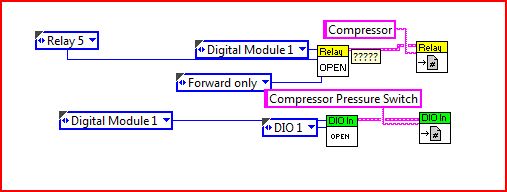

Yesterday our code was working fine, but today in the morning when we added in our compresor code EVERYTHING STOPPED WORKING!, we get communication we can deploy our labview code successfully we didnt change anything at all (software/hardware). Everything as in: the Launcher, ball grabber, all autonomous modes, everything!::S
We get the following errors in Diagnotics panel:
FPGA_DIOReadPWMValue.vi>> BuildDashBoard Data.vi >> Robot Main.vi
<Time> 14:58: 50 02/12/2012
FRC: The <b> Digital MOdual </b> is invalid or not found. Make sure to set <b> Digital Modual </b> to either <b>Digital Modual 1 </b> or <b> Digital Modual 2 </b> and ensure the modual is plugged into the spot you specified.
Please take a look at our code :frowning:
Please and Thank-You

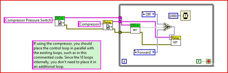

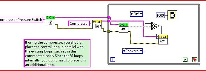

if your compressor loop is in teleop then the loop never exits and hangs up robot main. I would suggest simply using the compressor pallet tools provided to create code like http://www.chiefdelphi.com/forums/showthread.php?t=102830
What the?
Why don’t you just use the provided Compressor VIs?
