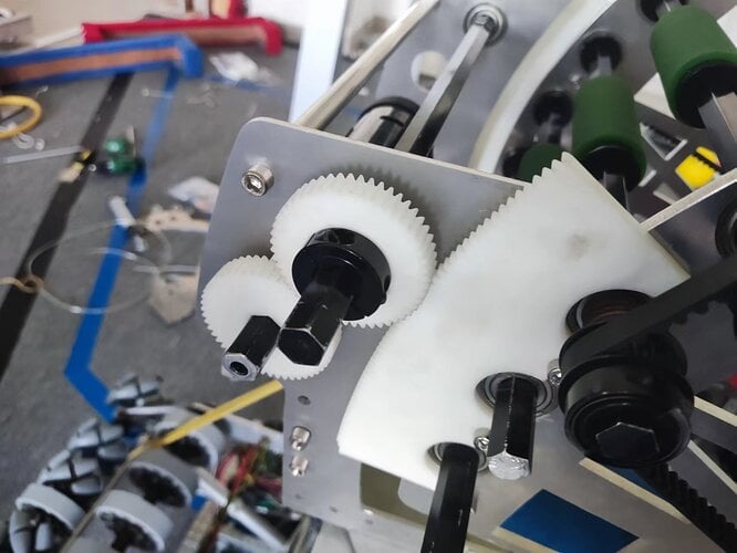

However, when l set 50% output to the 775, it seems that the 3D printed gears on the hood is broken. However, when l try to use a ratchet wrench to move the hood and it can be lifted up. Is that the normal case? (l think it’s strange😂

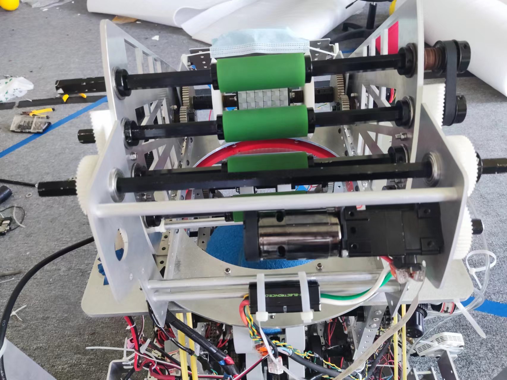

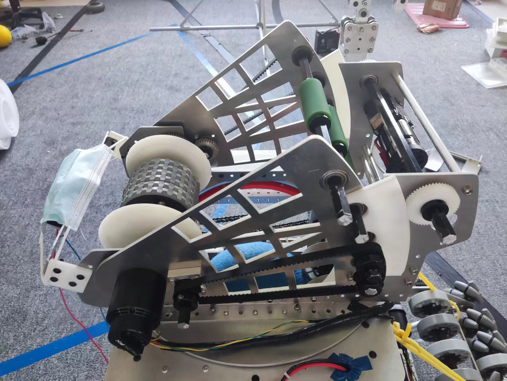

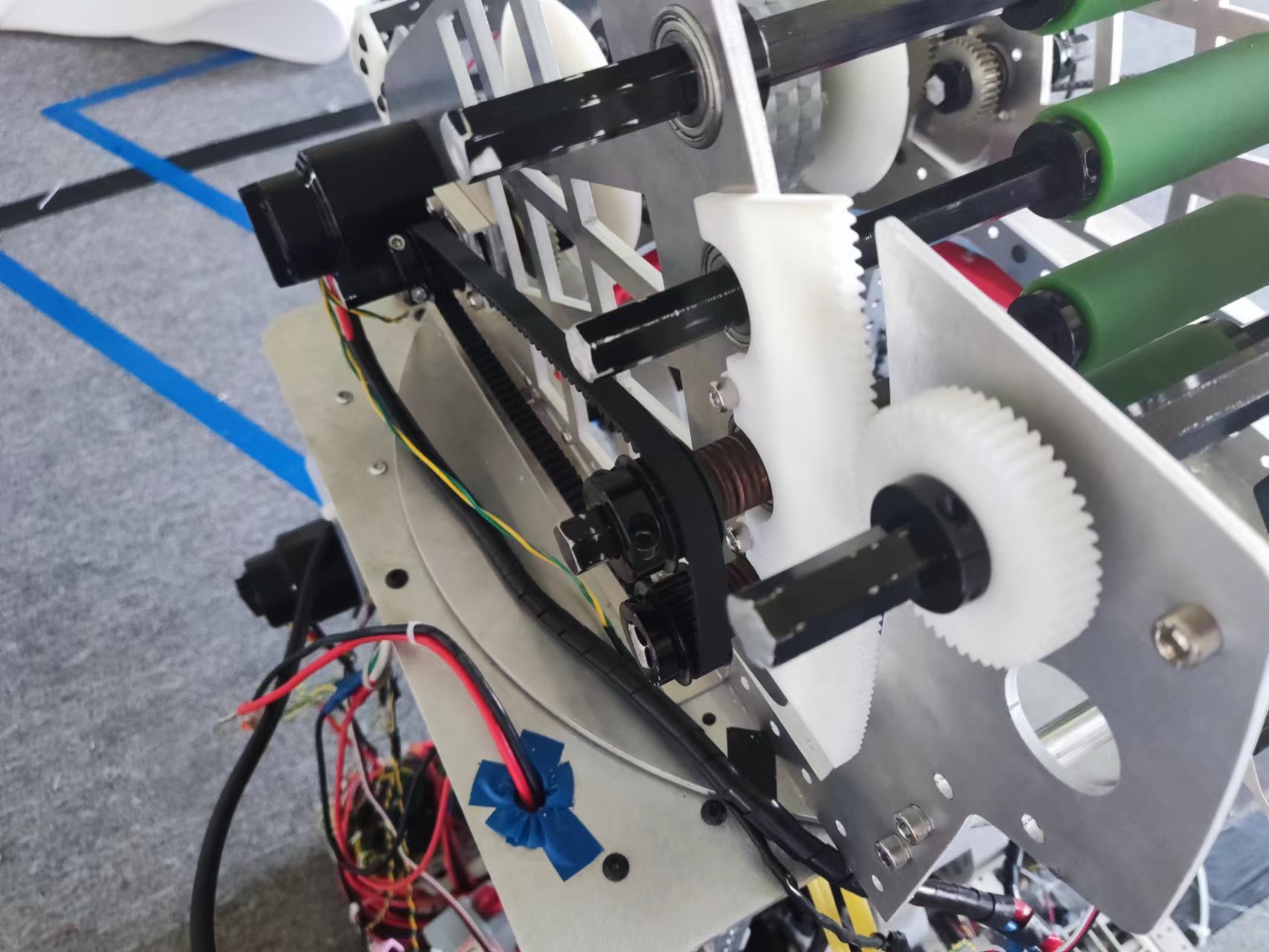

Hi, these are photos of our hood and shooter. Can you help me confirm whether this shooter can shoot a ball out theoretically?

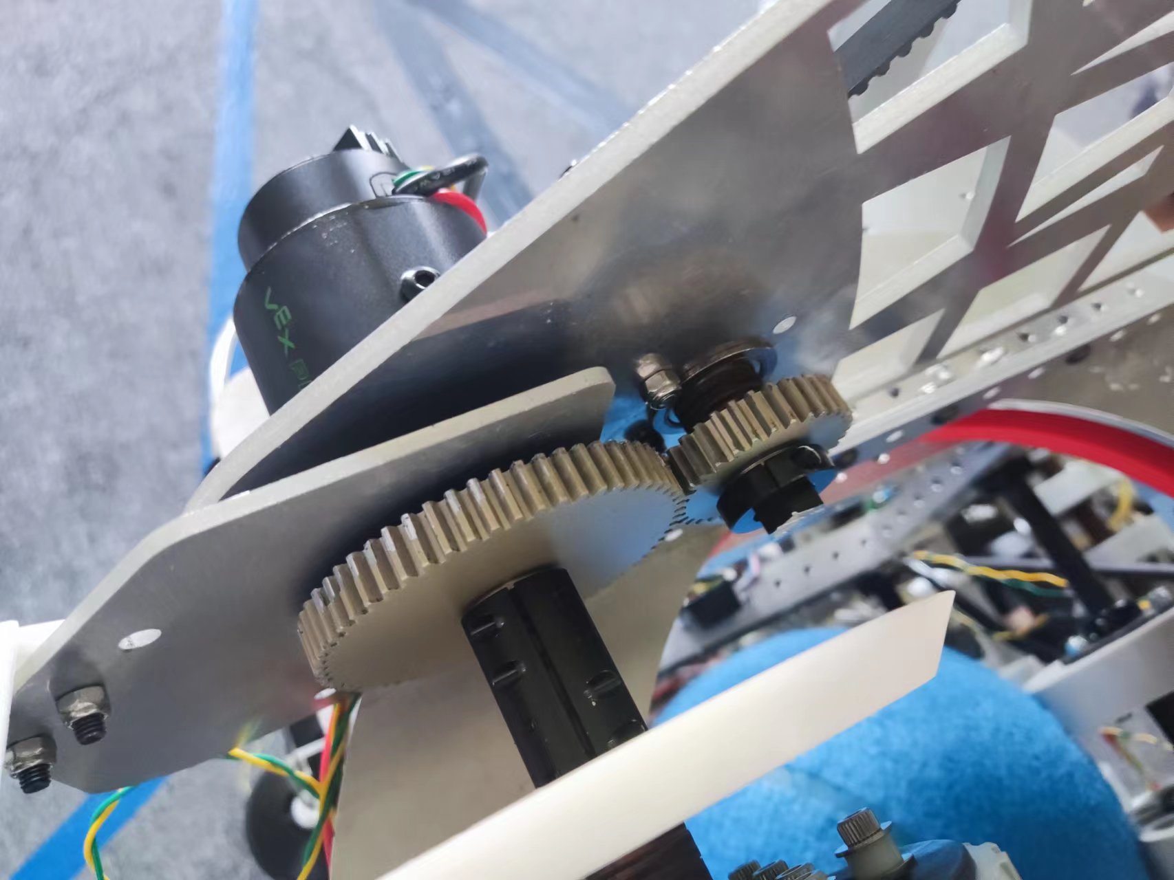

Try removing the gear installed on the output shaft of the VersaPlanetary with the 775 motor.
Test if you can move the hood mechanism by hand.
Then test if the tuner software can make the output shaft of the VersaPlanetary spin.
Make sure the shaft is spinning in the proper direction. If the hood mechanism is already at one end of the travel and the motor is being commanded to make it go past the mechanical limit, it may start breaking things like you have described.
Do you mean this gear shoule be removed?
l have tested it and the hood mechanism can be moved.
Besides, it seems that our shooter mechanism can’t shoot out the ball, but l think there is no problem with the shooter mechanism. Can you help me with it?
