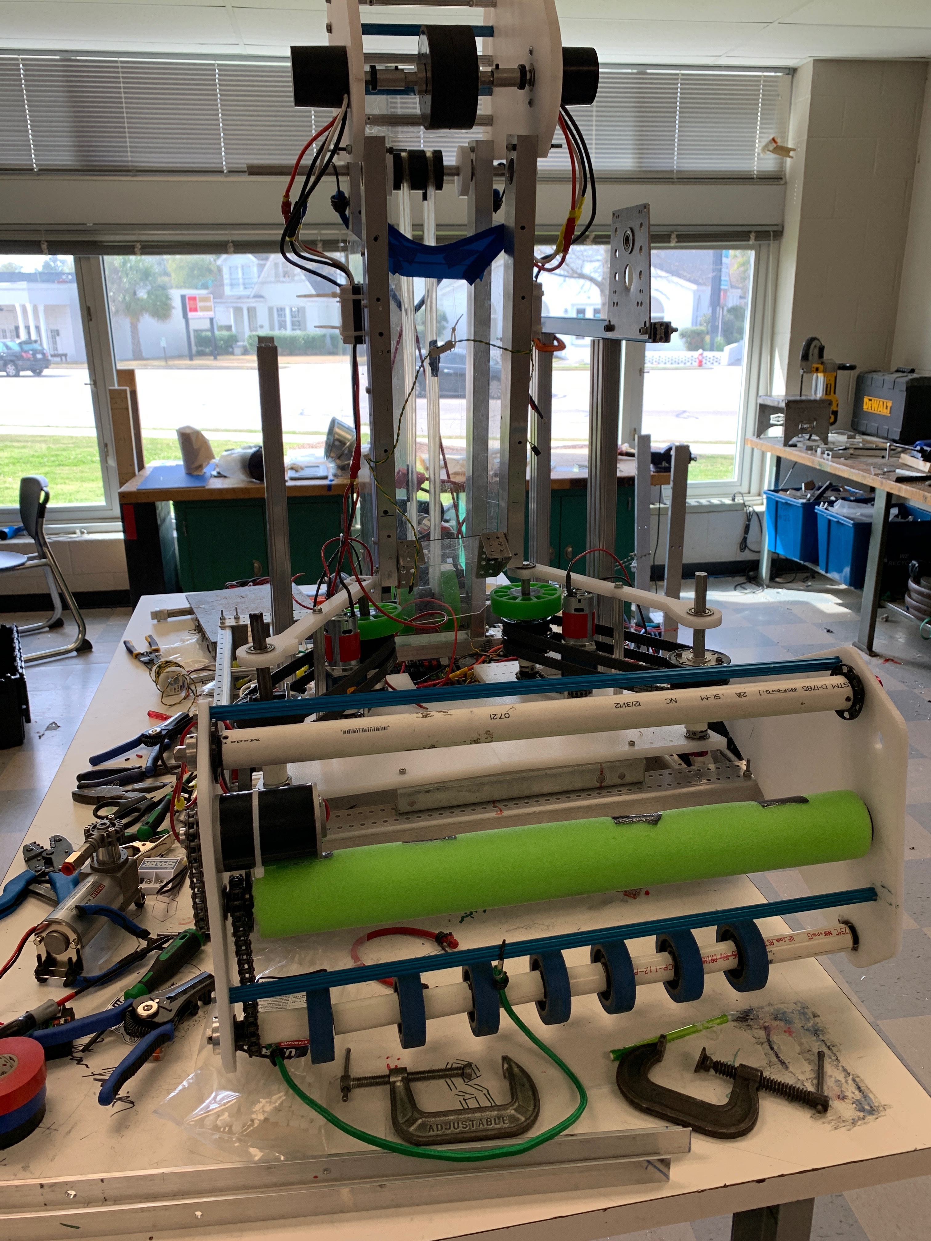

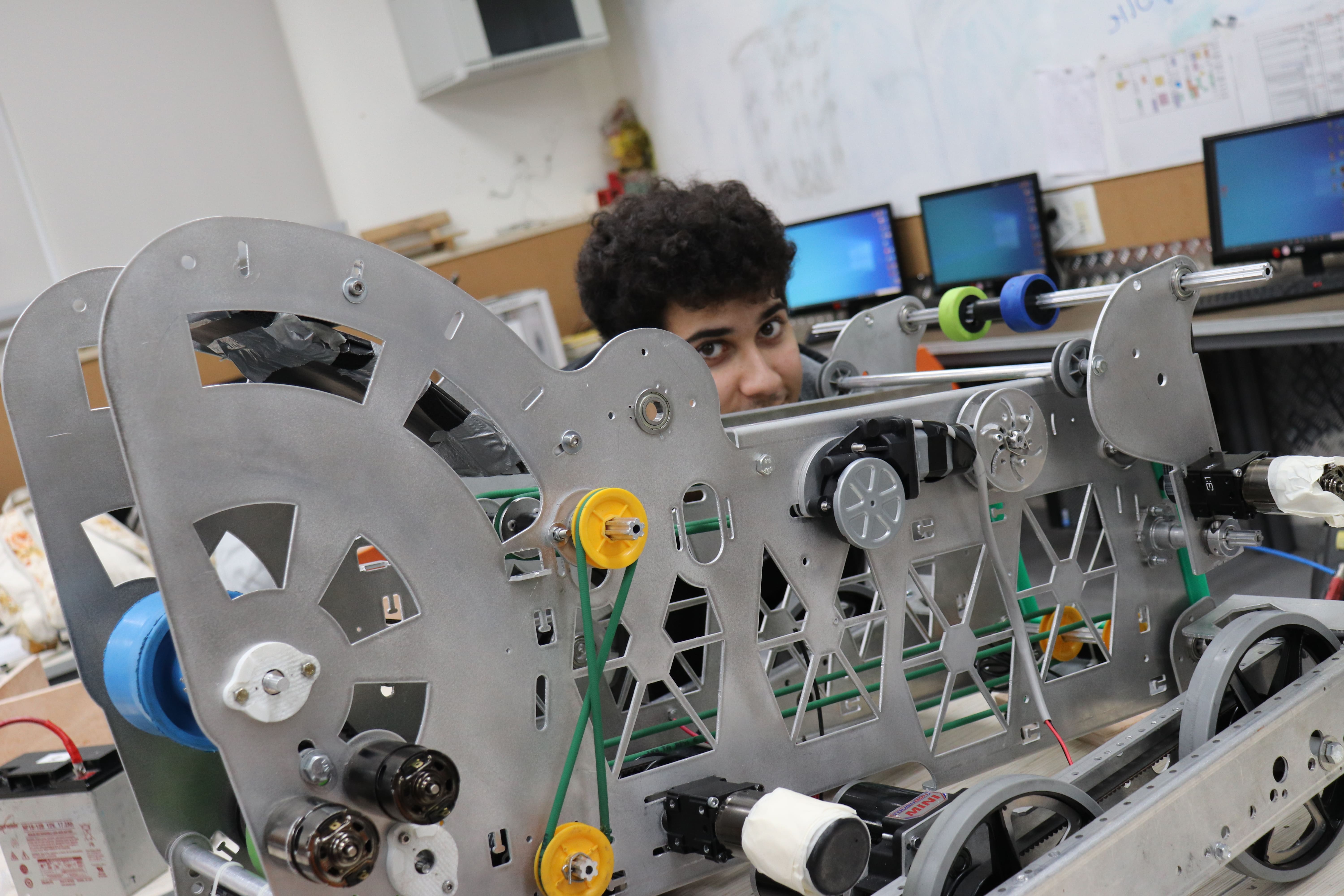

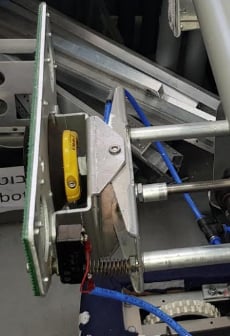

For a few years I’ve preached the gospel of Sam’s Club cutting boards, which brought back memories of GUS using similar ones to make parts over a decade prior. They’re $9 for a 15"x20", just-under-1/2"-thick piece of very durable polyethylene plastic that cuts like wood. You’d pay double at McMaster for a similarly-sized piece made to tighter tolerances.
In 2018, we used them as cube intakes arm plates…then when our cart’s caster pulled through the mount at Smoky, we bolted through another one as a rescue.
In 2019, it became our hatch grabber. (I don’t know why I don’t have a picture of it mounted properly, but it was originally mounted to the wrong bar.)
In 2020, we made a bootleg GreyT shooter out of them while prototyping. Our friends on 2815 then took some and cut them to the original drawings on their Xcarve for both of us to test with. While our design paths diverged in the end (we decided to dump low), the final 2815 machine not only had a cutting board shooter hood but also cutting board intake and conveyor plates.
Best of all, it’s only about ten minutes door-to-door from our shop to a Sam’s Club so we never have to keep a big stock.

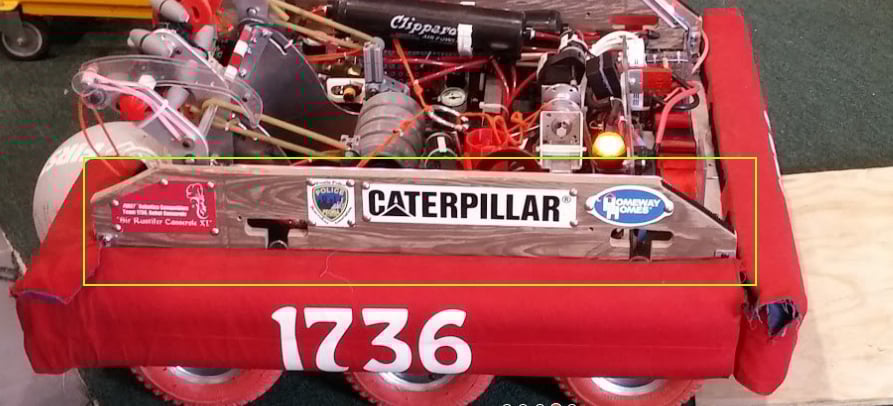

The “weird part selection” story that goes down in history in our team.
  1. Someone decided that we needed extra guards on the robot to protect it as we navigated obstacles (particularly under things):
Fair requirement.
Someone decides to make them out of wood. ~insert comments about WOOD BAD here~
Someone says “well, at least paint it”.
So it got painted.
To look like older wood.
Well, it ended up going well with the theme, so we kept it.
But, whenever someone has an off the wall idea, it always gets compared to “that time time we painted wood to look like wood.”

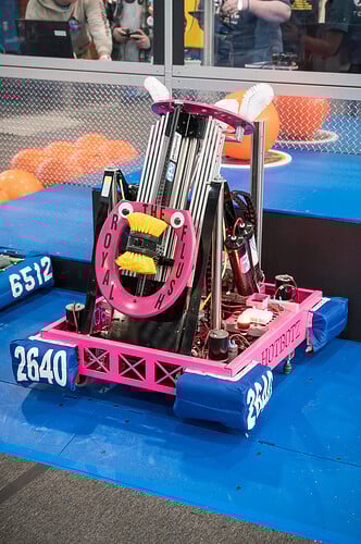

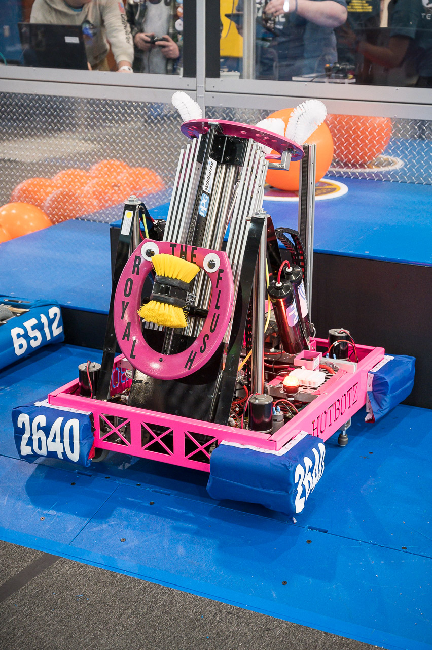

My favorite so far has been Hotbotz (2640) and their 2019 robot. It’s hatch mechanism consisted of two scrub brush heads and a toilet seat. It also had three toilet brushes and another toilet seat as parts of the cargo mechanism. The whole thing was named, appropriately, The Royal Flush.

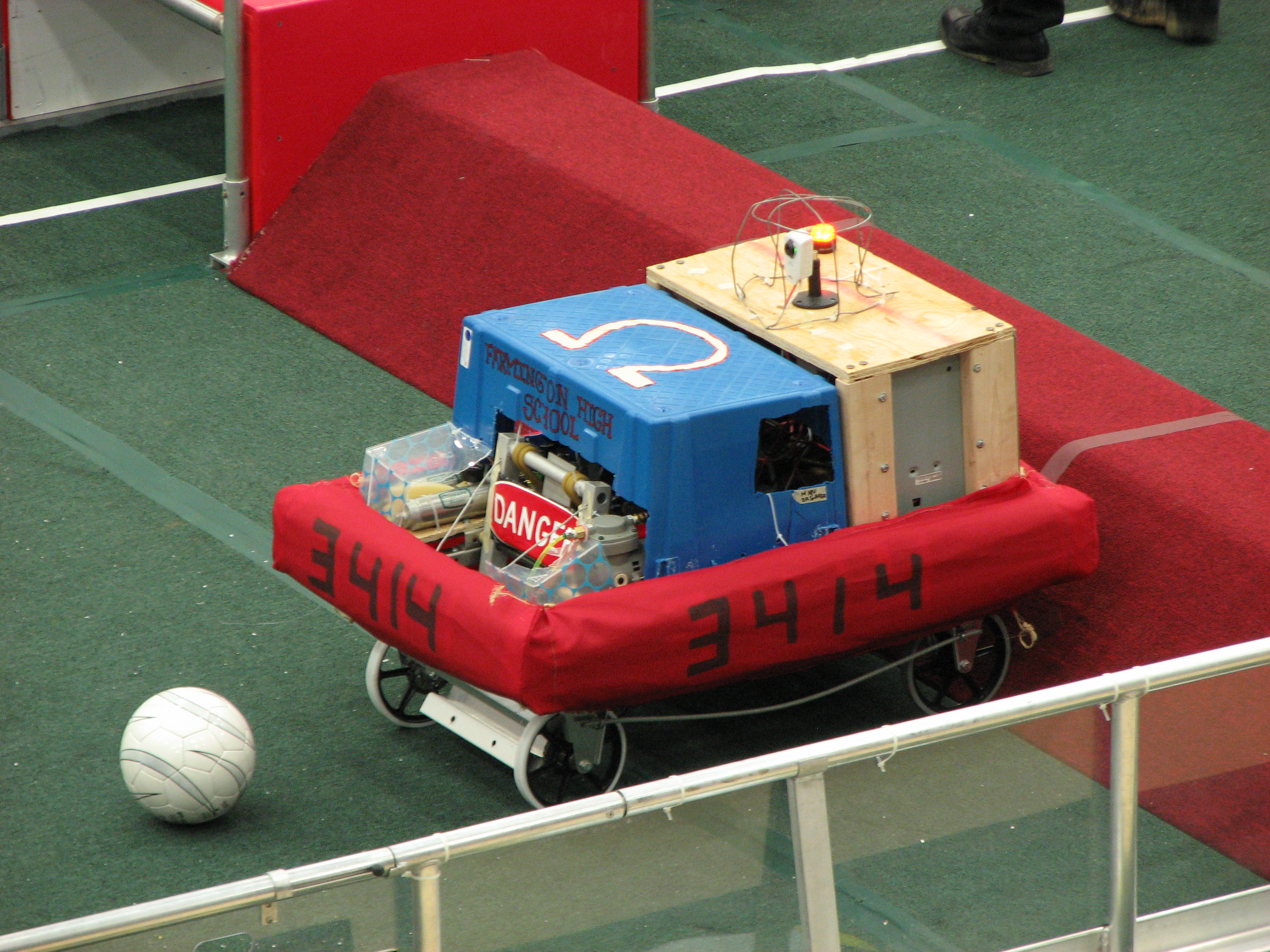

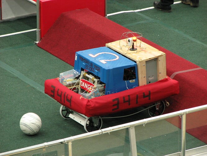

Kit of Parts tote on our 2010 robot rookie year. We needed something to protect the electronics and hadn’t heard of polycarb yet (not that we had the budget to buy any).

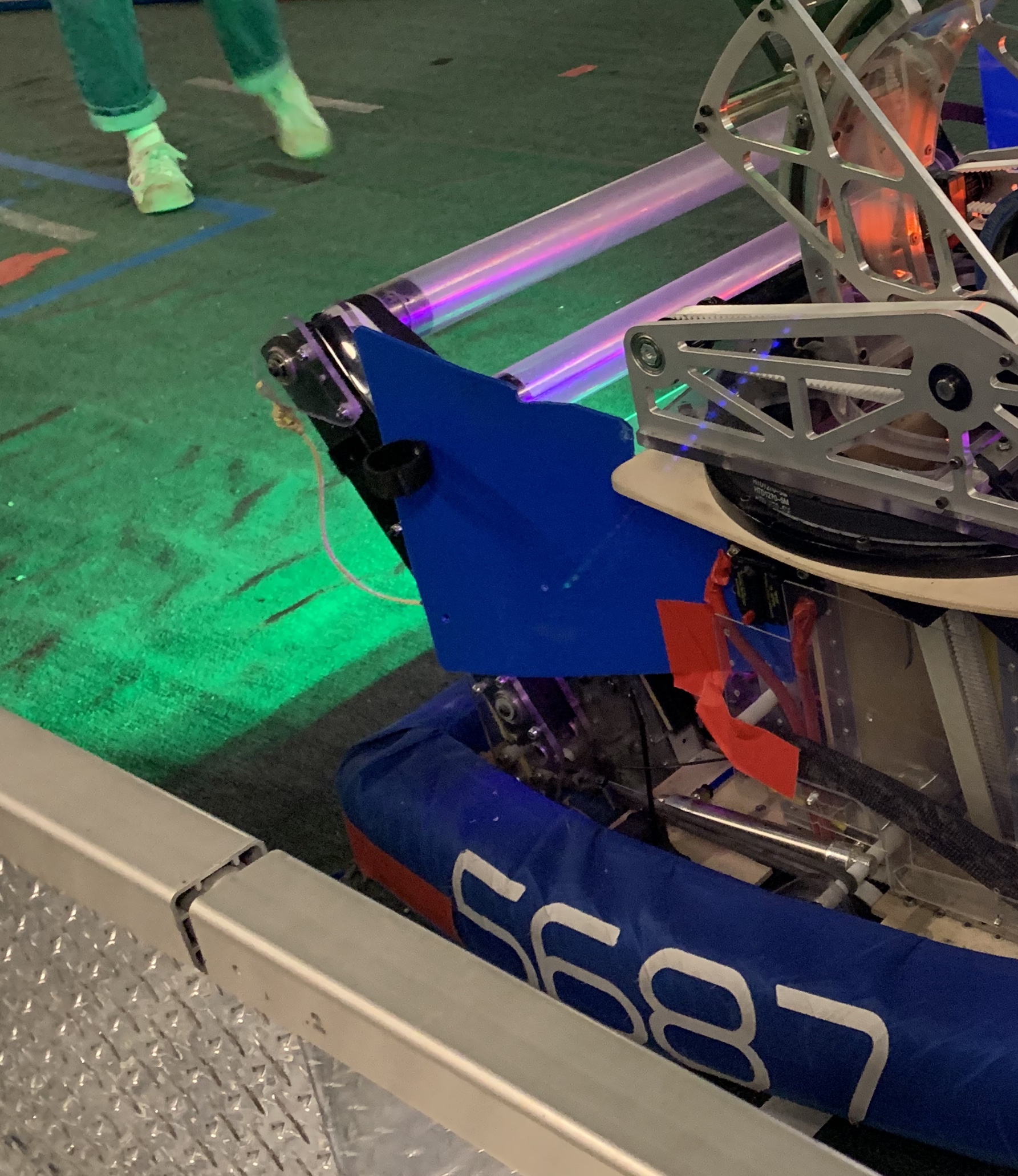

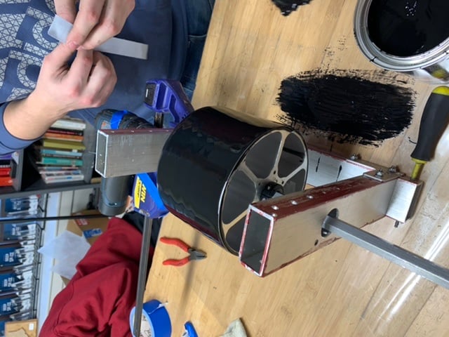

We covered our flywheels in flex seal this year after we had a failed (and slightly scary) attempt with urethane. The flex seal has actual had some pretty good results and had the season continued we probably would have used it at competitions.
We also used recycled polycarb from last year’s cargo ship to make fins that prevent balls from coming out of our hopper

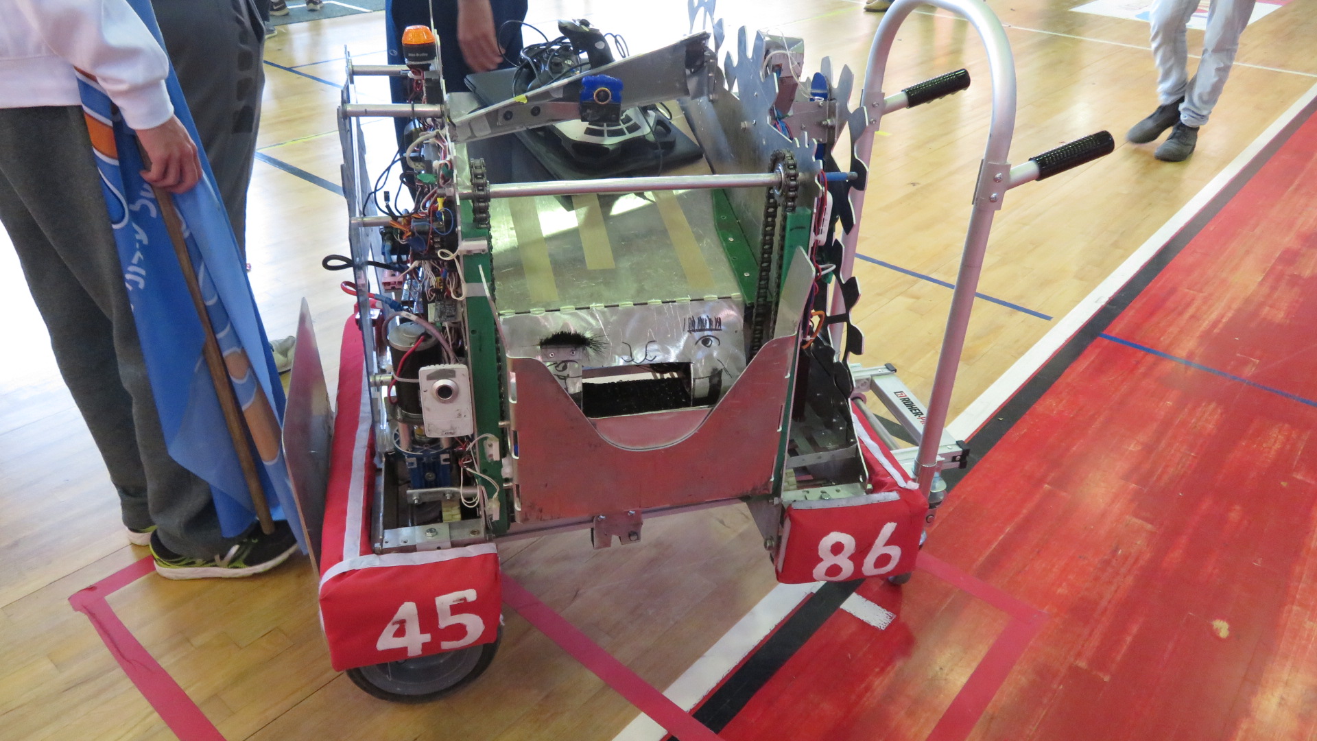

Edit: we also used a shopping cart for our week 0 robot Carl

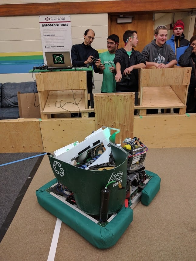

A trashcan, that actually was surprisingly effective

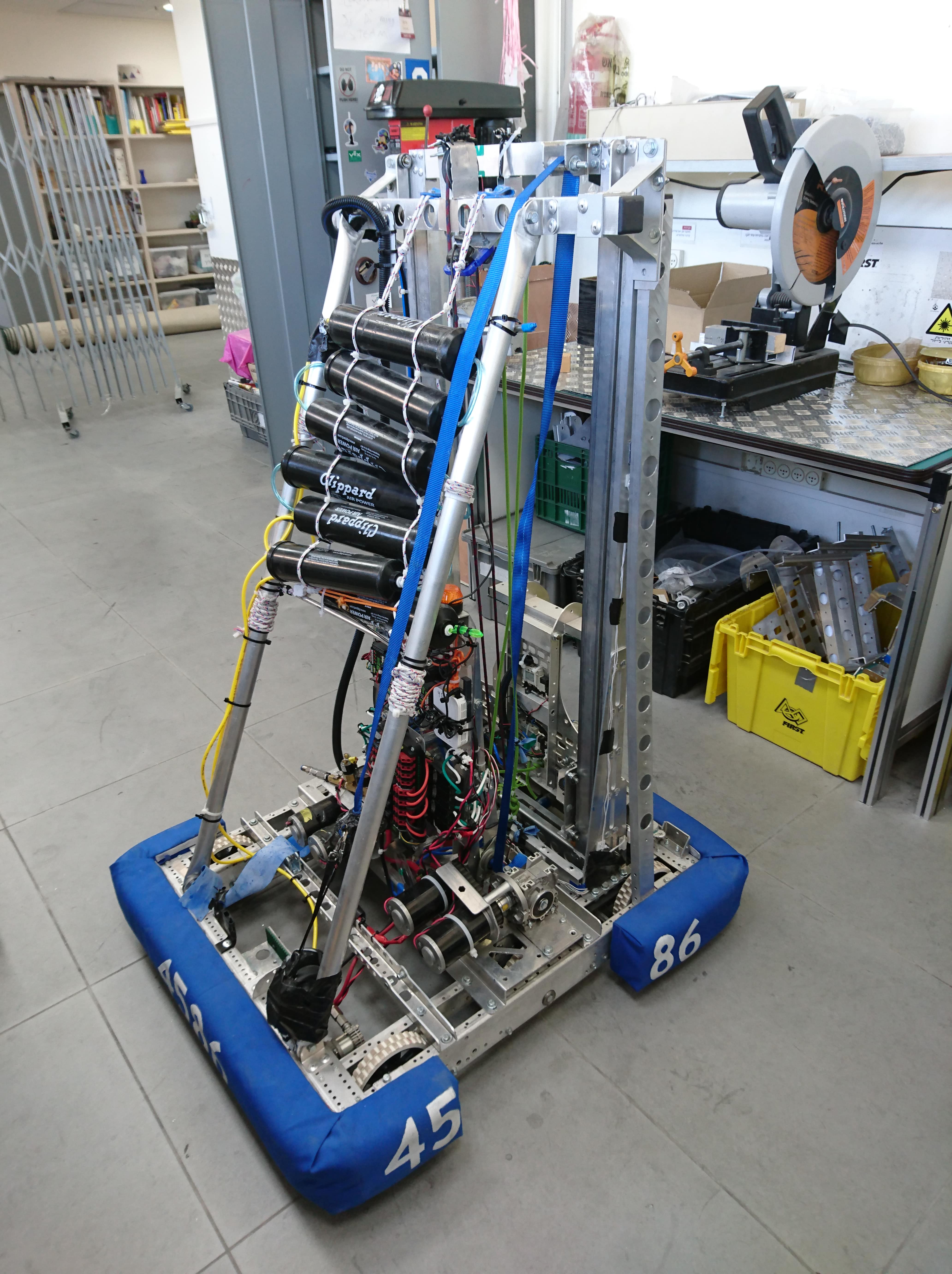

Our team specializes in weird items in our robot

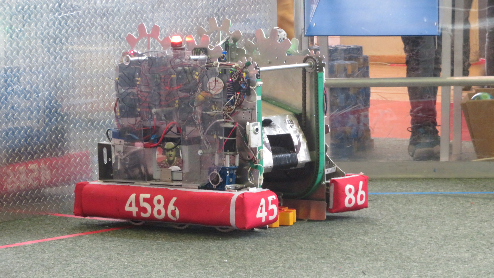

2017(Offseason): We had brush like part that was made from a part of broom to slow down and stop the gear from falling down the slide. We also drew a face around it
2018: We had 2 dog leashes (buttom of the bot, covered in ductape) that pulled the climb rope (in blue) so it wont get tangled when we move the elevator up and down

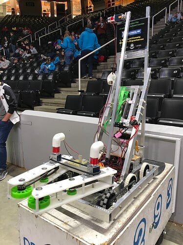

2019: We had surgical syringes pulled by pneumatic piston to create vacuum (more like suction) that held the hatch panel. Worked extremely well.
Side image
Front image
2020: Our cannon wheel, the one that shoots the power cells was a blue V shaped wheel that is used to sort Avokados on a conveyor belt. We ended up replacing it with a 4 inch HiGrip wheel as it couln’t really handle the speeds that we needed.
Can’t wait for next year!

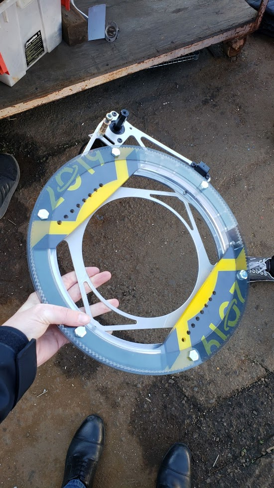

The pulley on our practice bot’s turret looks familiar:
(It’s admittedly not that weird, but @Billfred’s routing-things-into-robot-parts post reminded me.)

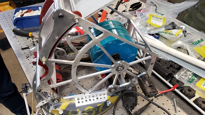

It’s a pity the shooter didn’t make the cut.

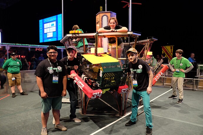

Well it was added later in the season, but after our first Semi-Finals match in Tesla, 2017, we managed to get a gear stuck in our hopper. Since we determined that it can not happen again, and lost us the match, I believe 2084 remembered they had a mattress sale sign in their pit from a fundraiser they did, and gave it to us to chop up and cover the top. In the end, we ran through the rest of Tesla and Einsteins with the mattress sign. I think the sign is still sitting on the shelf somewhere. We made a better cover for IRI and WMRI.

Also a trash can. (Or rather a “recycled” blow-molded polyethylene hopper, as we marketed it to judges) :slight_smile:
