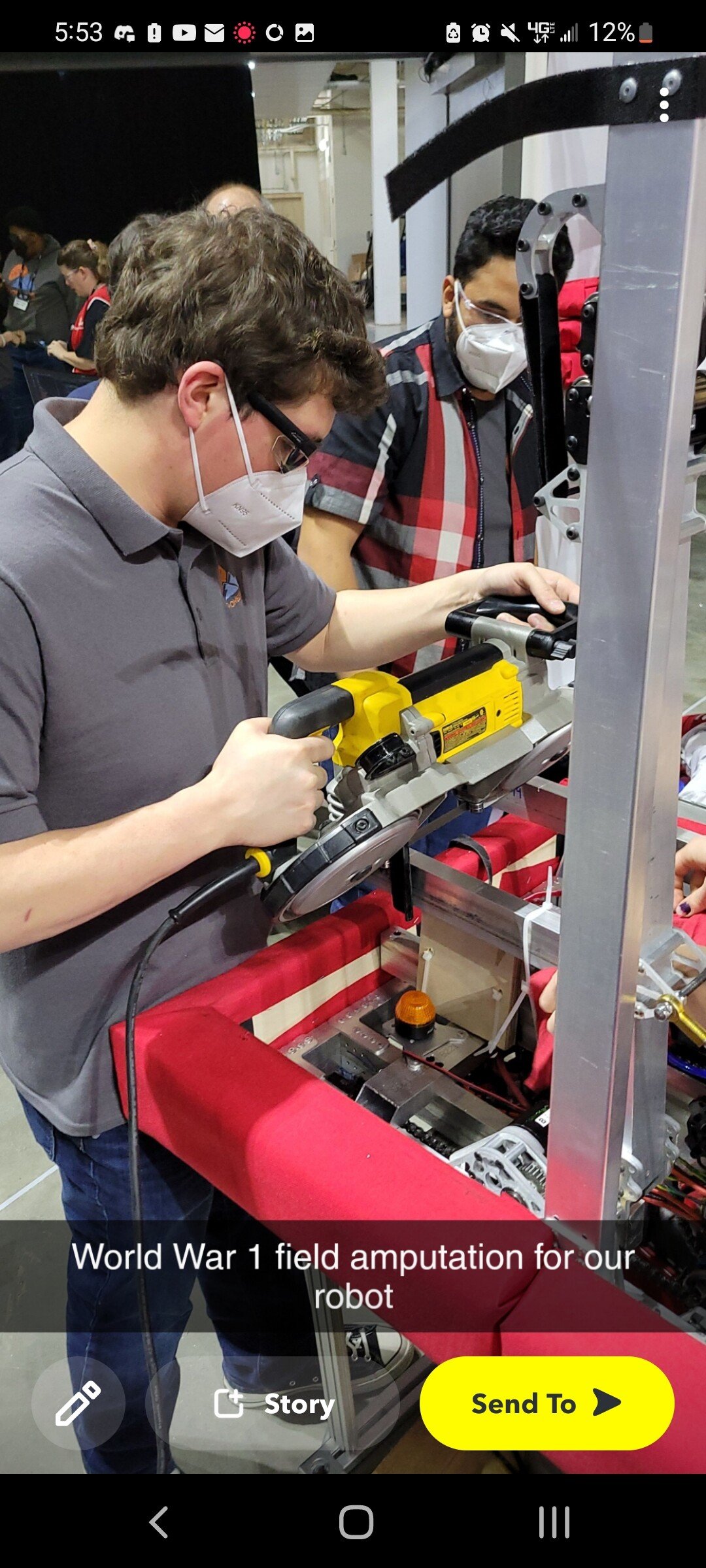

Occasionally at events you’ll see a robot that’s too tall. I’ve seen a portaband used freehand more than once to solve the height problem. Once on one of my high school team’s bots.
I think I’ve heard of a few RI’s that bring a portaband to events for “just in case” robot shortening.

Appropriately in the horror stories thread. Any time you see a portaband at an event that isn’t on a stand, it is guaranteed to be a horror story in some way or another :joy:
