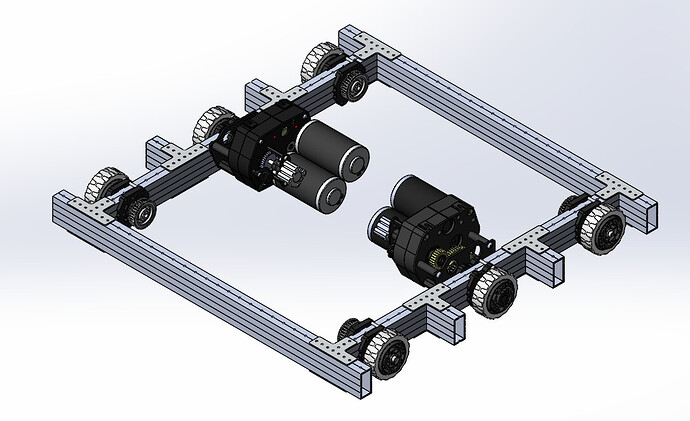

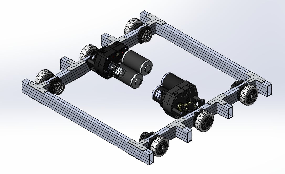

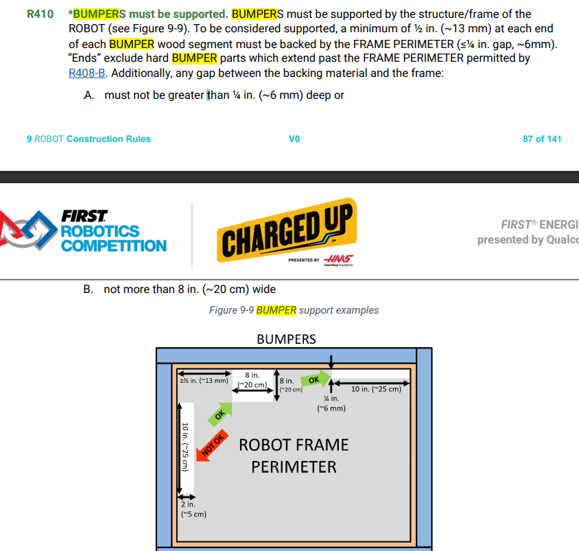

My team is planning on doing west cost drive this year. Does the wheel and shaft behind the bumper count as robot frame? It is my understanding that R410 is not explicitly saying the bumpers are mounted to the robot every 8 inches but has something behind them every 8 inches.
Wheels don’t count. Here are some options for legal bumper backing:

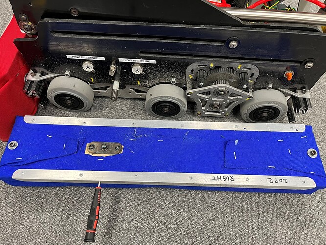

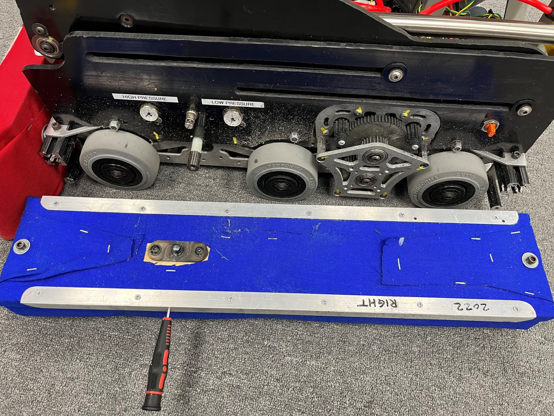

Here is a picture of the side of our 2022 bot. We used the gearbox as a bumper “support”. It didn’t touch but was closer than a 1/4 inch. Didn’t have any problems with inspection but if your bumpers don’t look or feel well attached/supported they will look closer and tell you to fix it. You want inspection to go as smooth as possible.
Please be sure to also read the blue box associated with R410 for clarification on the intent of structure/frame.
Also, R101 specifies that the FRAME PERIMETER must be fixed and not articulated. Wheels and axles would not be considered “fixed” but would be articulated.

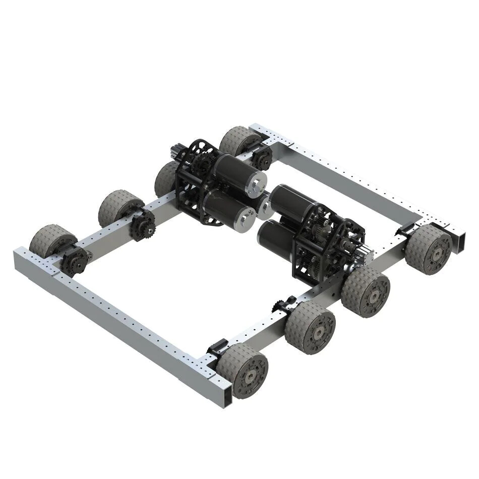

This is one of my pet peeves of the WCD. Vendors show you plenty of photos of cool-looking drives, all of which are illegal because of this rule. See, for example:
This right here has to be one of the more elegant solutions to that rule. Leaves absolutely no question, and gives plenty of mounting surface for lots of things.

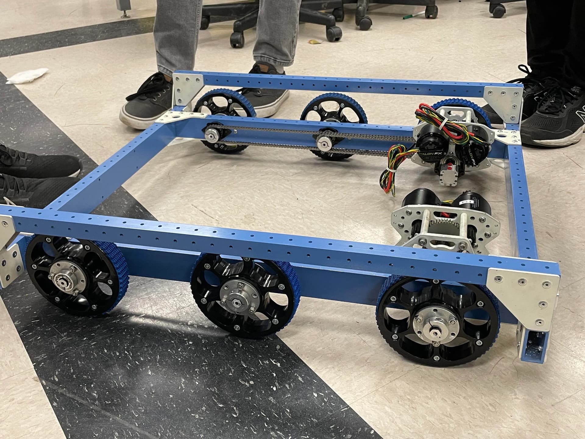

Skip to about 8:30 in this video and you can see a few different ways we have handled this in the past. You can do the closed wheel well easily as pictured above by other teams or you can run angle/tubing across if you wish to open up the wheel well.
We also did this last year from our build season thread to upgrade the design and this worked wonders for us. We did not even add the stiffening brackets shown by the end but if you wanted to get those, they are simply off the shelf tube plugs and gussets for the whole system.

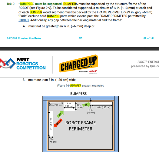

I have to disagree here, the rules are not ambiguous and in fact are very specific. 8" max unsupported as per the rules (R410) and pictures shown above. As to WCD, WildStang has used it in the past and we add structure between the wheels to satisfy the rule ( as shown above in the second drawing by nuclearnerd). I am not a fan of the structure that is at the top limit of the bumper as it allows the bumper to rotate during collisions and damage the drive wheels. Flexible material like a piece of lexan or a simple aluminum bracket do not satisfy the R410, “BUMPERS must be supported by the structure/frame of the ROBOT (see Figure 9-9)”.
