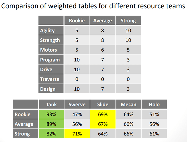

This is a bit outdated (2011) but it’s still on 1114’s website and it’s a good representation of when you should invest in which drivebase:

There has been a clear preponderance of the advice that swerve is not the right choice for the OP’s team. I totally agree. However, there may be other teams reading this thread that aren’t as resource and experience limited as the OP, and are asking the same question.
