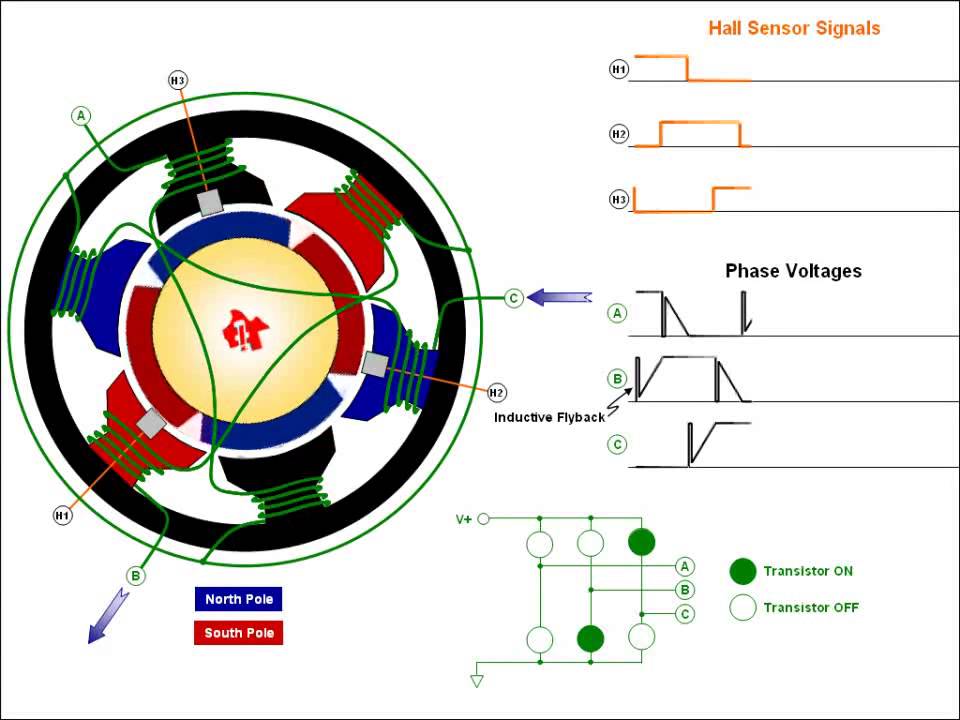

I’d take this a step further and say it’s actually part a parcel of all brushless motors. There are 3 lines running to the motor. Each line will be turned on and off in a sequence like so:
The square pattern of the halls is directly comparable to the phases of each line. Because of this you can technically have RPM control of any brushless motor at high speed by counting the time between each rising/falling edge. At low speeds this is less accurate. You can also get the analog strength for better accuracy
