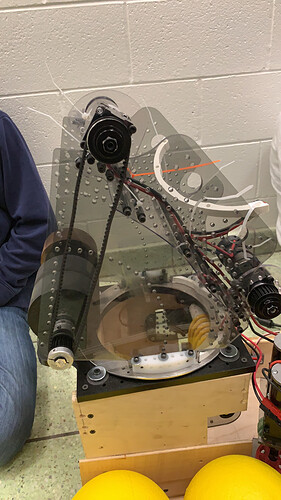

Part of my advice would depend on what tools you have available.
If you have CNC capability design your shooter side plate with as much adjustability as you can. Increase and decrease the amount of pinch you have with your shooter wheel and your hood. Design it so you can change your wheel easily. Design it so you can change the hood material easily. All of that will help you dial it in quickly. You’re unlikely to get everything right on your first try.
If you don’t have CNC ability I would still try to achieve the things above but it will be more difficult. Consider printing 1:1 drawings and use them as templates with a drill press and a band saw.
Our first side plates this year looked like this:
You can see some of what I’m talking about. Lots and lots of testing and documenting what worked informed our “final” design that looked like this:

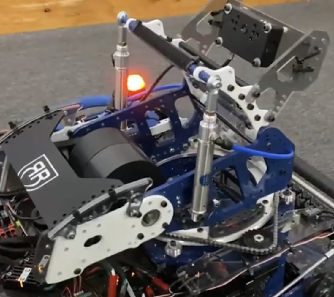

Please don’t think of it as “calling you out”. IMO, a successful team has both "what would win everything” people and “how can we get to good as fast as possible” people.
Based off (best guess) of team resources and experience, I just want to point out a few things:
  • Shooters and turrets are different mechanisms, don’t worry about a turret for a proto, if at all
  • Don’t even begin to worry about mid-match variable shooter geometry (hoods, flywheel axle offsets, etc) until you have gotten a “rigid” geometry prototype working. Compression on the ball and surface velocity of the flywheel(s) is really where you should be spending your time
  • Do some sketches of the ball trajectory from the location(s) you are interested in shooting from. Do this so you know the way you need to start adjusting variables for dialing things in within the tolerances of your shooting location (even if you want a single shooting location it is best if your alignment can handle a foot or three of offset from nominal, this will help massively with speed of cycles
  • Be aware of what your manufacturing capabilities are. Sometimes identical or perfectly symmetric parts can be a huge bear to make manually, so small inaccuracies in a prototype may make huge differences in the comp copy.
  • Same thing as the point above except for materials, if the proto is compliant in one axis do your best to replicate that in the comp (or at least be aware of how compliance in the proto transfers to a rigid comp copy.
  • Lastly, the first proto can be pretty simple, two pieces of plywood with bearing holes (screw the pieces together & drill holes as a matched pair to keep things aligned), some 2x4 standoffs to set the distance between the plates, and some angle to hold some thin polycarb hood geometry. don’t go overboard. (or use the match drill technique for a dual wheel shooter)
