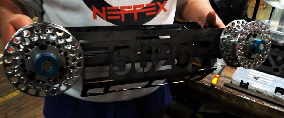

Milled aluminum trolley wheels. The drilled out holes are for, depending on your perspective, extra grip on the pipe, desparate attempts to get down to 125 pounds, or just because they look cool.
5826
