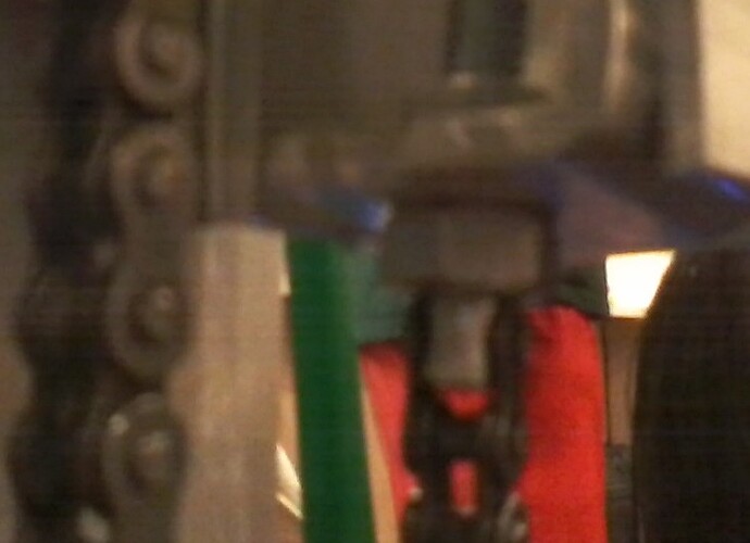

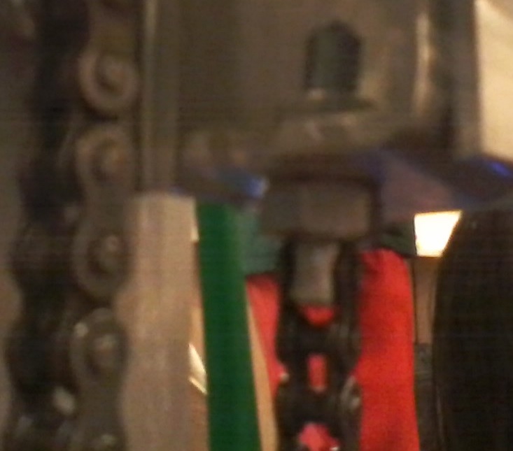

25 chain. We’re linking the chain to a glide by cutting the head off of 1/4" bolts, making flats on the shank (whack it with a hammer, careful not to mash threads), drilling a 3/32" hole in the middle, and forming a link of the chain into that hole using a Dark Soul tool(Vex sells a similar chain tool). The threaded bolt end allows a tensionable connection to the glide.

Any pictures of this handy?

Do you have pictures of your tensioning solutions. My rookie team is looking at adding one and are stumped at this point.

Hopefully this should link externally without you needing an account. If not I’ll upload to imgur later.
so ours is very similar to Lil’s but our tensioning sprocket is free hanging down from the top with 2 pieces of angle aluminum and then springs to pulling it towards the interior of the robot keeping it tight
