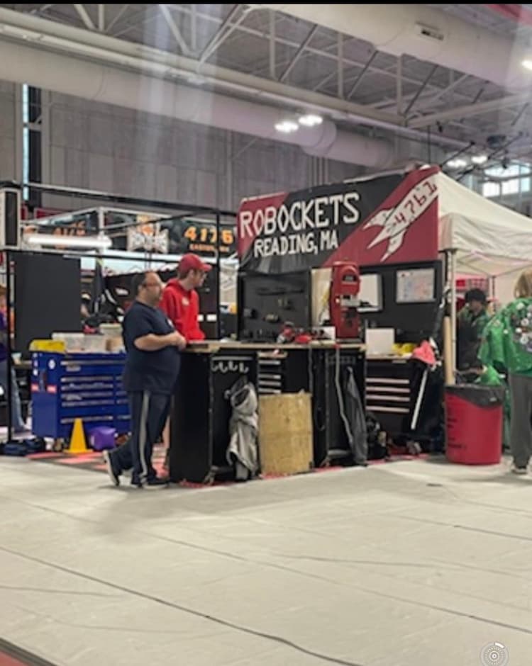

We have some custom shelves for our hardware trays with coat hooks on the back. They can be a bit hard to get to, but they keep coats out of the way pretty well.
Post a pix?
Had to stalk the team instagram, but you can see them decently well in this picture.
