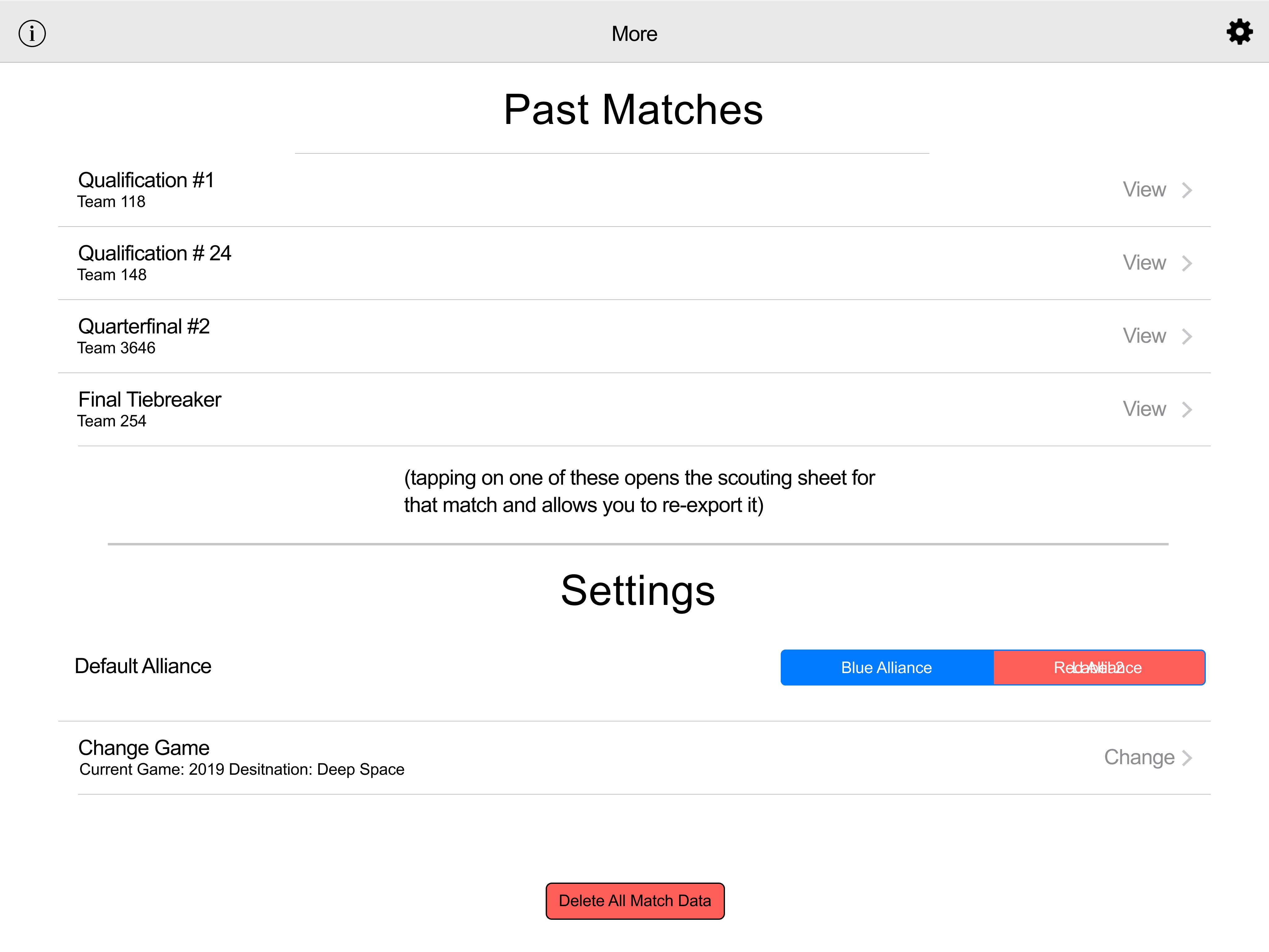

Our team is currently developing a visual scouting app that will export the data into an excel spreadsheet that would be airdropped to a laptop and then copied over to a master spreadsheet. Here is our prototype of the UI (this is for last year’s game, and the prototype is obviously not complete): https://gnsrobotics.com/eric/m.png
https://gnsrobotics.com/eric/all.png
