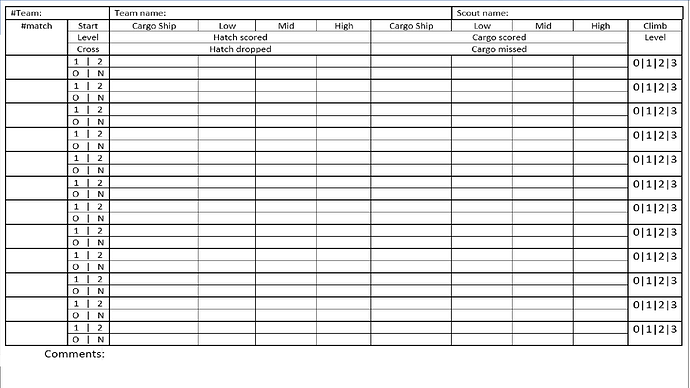

That’s the scouting sheet my team will use this year.
We use the comment zone for specific caracteristic like collecting hatch on the ground.
Each sheet is dedicated to 1 robot so it’s easier when you enter your data in exel.
We also have 1 or 2 students that makes a top 5 defensives robots list.
The rest of the scouting can’t be done base on match observation.
