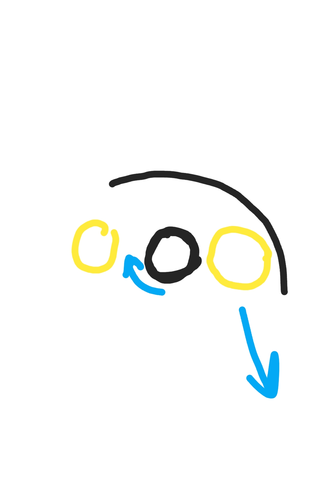

What do other teams mean when they refer to the "hood" of a shooter
I have never heard of that term and I have not seen pictures of the hood either. What is the purpose of a hood?
Thanks
A hood is the fixed outer shell of a one-wheeled shooter. Shooters with two wheel axes do not have hoods. Most commonly, this shell is above and concnentric with the wheel, and resembles a hood, hence the name.
A shooter can be designed with a single rotating wheel with an opposing curved plate. The ball rolls between the wheel and plate until it ejects. That plate is often called a “hood”, as it ends up on top of the robot.
Do you mean the wheel is on the bottom and there is a hood on top?
