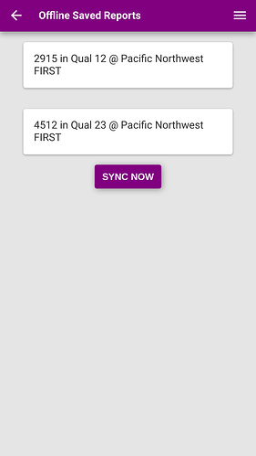

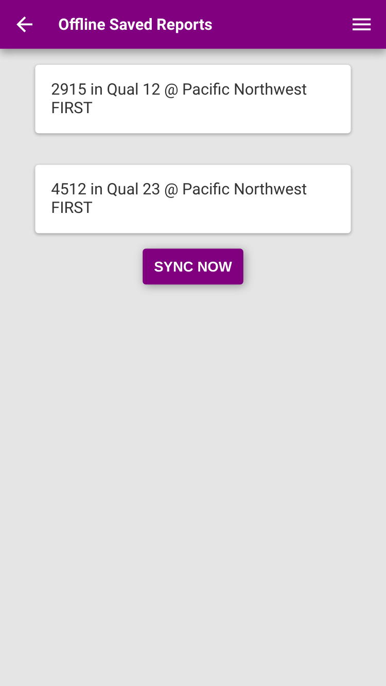

Peregrine is a PWA which can operate offline (on supported browsers), store reports in html5 web storage, and then magically upload them to the server when you open the app while connected to the internet. Most of our events have cell service anyways, but it’s a good backup if there’s a shoddy connection or something (e.g. scout all morning with shoddy internet in the stands, go outside and upload reports at lunch).
It’s the lowest friction solution I’ve seen (reports get synced in the background, all you’ve gotta do is visit the app with an internet connection after working offline).
Wow! I know in research last year for “form type apps” to scout Infinite Recharge, the biggest issue was that the services often promised offline compatibility but never completely followed through. It looks like this web app has nailed it looking at the original post you linked!
My first thought for my app (now developed using Xamarin) was to make it a web app as we use Amazon Fire tablets primarily to scout our teams. I was worried about the difficulty to implement the features I really wanted into a web app, but this looks like it hit a lot of them quite well. I’ll check it out more in depth to see what I can do to make my app’s communication more smooth.
