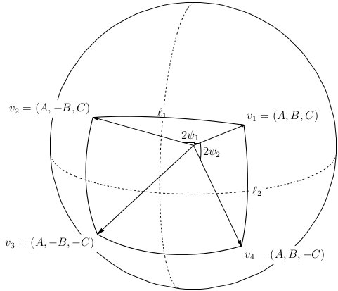

The reason that vertical angle doesn’t work when you robot is at an angle is that your camera image is a rectangle, but the projected section of 3D “real world” points at a given constant range is spherical:
So as your camera rotates along the “equator”, non-equatorial points of constant latitude actually appear to move higher or lower in the image. You can also see this effect by looking at your cell phone camera while you swivel in an office chair - look at what objects you can see at the extreme top and bottom of the image as your turn. Things that appear at the top when they are in the center (left to right) disappear completely when you turn a bit and they would be in the corners. So there’s a coupling between the x and y coordinates that needs to be taken into account!
The math to deal with this is straightforward but can be unintuitive. Think of tx and ty as the angles of a vector in 3D polar coordinates. Now figure out the x, y, and z components of that vector. If we say that “z” is the vector “into” the image, then we can assign it a unit length (1.0) for now. “x” would be 1.0 * tan(tx), and “y” would be 1.0 * tan(ty).
Note that this vector is not normalized; length is >1.0 unless tx and ty are both zero. To normalize, divide each component by the length (sqrt(x^2+y^2+z^2)). This normalization accounts for the spherical issue that couples x and y angles.
If your camera is not mounted perpendicular to the ground plane, now is when you’d want to compensate for its pitch (so if it’s pitched up 30*, you want to rotate your 3D vector down 30*).
Finally, your goal is to find the intersection between this 3D vector and the (known, constant) height of the target. The length of the base of this triangle gives you range. As an example, here is our 2019 code for doing this (note that what we call x,y,z may be different than your convention).

Since we do our alignment by turning until tx=0, it looks like that would make “x”=zero in your example. Following that through the process you suggest, we’d end up with a “z” of 1.0, an “x” of 0.0, and a “y” of tan(ty), so our normalized coordinates will always be
x = 0.0
y = tan(ty) / sqrt(tan(ty)^2 + 1)
z = 1/sqrt(tan(ty)^2 + 1)
Does that seem right?
Yes, and you can simplify it further using the trig identity:
sqrt(tan(x)^2 + 1) = 1/cos(x)
We get:
x = 0
y = tan(ty) / sqrt(tan(ty)^2 + 1) = tan(ty) * cos(ty) = sin(ty)
z = cos(ty)
This is already normalized since sqrt(x^2 + y^2 + z^2) = sqrt(sin(ty)^2 + cos(ty)^2) = 1 no matter the value of ty. So when ‘tx’ (and therefore ‘x’) is zero, you can just use the ‘ty’ angle directly without having to do any correction for the value of ‘x’. The reason to use the 3D vector is to get a precise range estimate when the target is off center left/right.
So what you’re ultimately saying is that if we’re off to the side, but turn until tx = 0, we can find our range coordinate (z) by just taking the cosine of ty? And if our camera is tilted 16 degrees up, then we will add 16 to the ty?
Exactly
Great, thanks! After looking through your code, I see that you’re taking the top corners to build your vertical coordinate in the viewplane, and then using that to scale your output. Is there any reason you chose to go that route over using ty directly? Also, I see a number of references to skew throughout your code, but I can’t find what you’re using it for. Is it just data collection? Thanks again!
ty is the center of the target facing the camera. This may not be the actual center of the vision target due to perspective effects (nearer parts of the target appearing bigger, etc.). Measuring the top corners ourselves lets us determine the actual center of the target.
