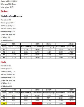

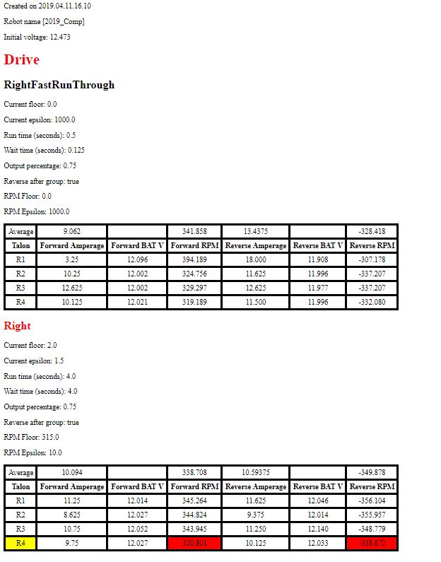

Our programmer @maccopacco could explain it better but we have it setup where the robot can detect missing sensors, motor controllers, etc, and let us know to troubleshoot. We also have a drivetrain test that will let us know what condition our motors are at (775 Pros) to tell if we burnt one up, and if everything is working fine.

Tagging of what Type has mentioned, we absolutely love the Motor Checking Utility we created a year-ish ago.
Our coaches are big on having numbers behind our claims, so that if per say the programmer burned out our drive motors in a bad auto routine (sorry @Type), we can show the progression of the decay of the motor and prove it isn’t fit for competition and therefore worth our budget to replace it.
We’ve also identified some pinions that had misshapen teeth, loose gearboxes, and tons of other fun to fix things with this tool.
