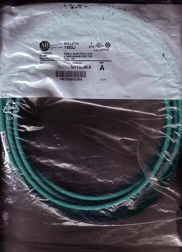

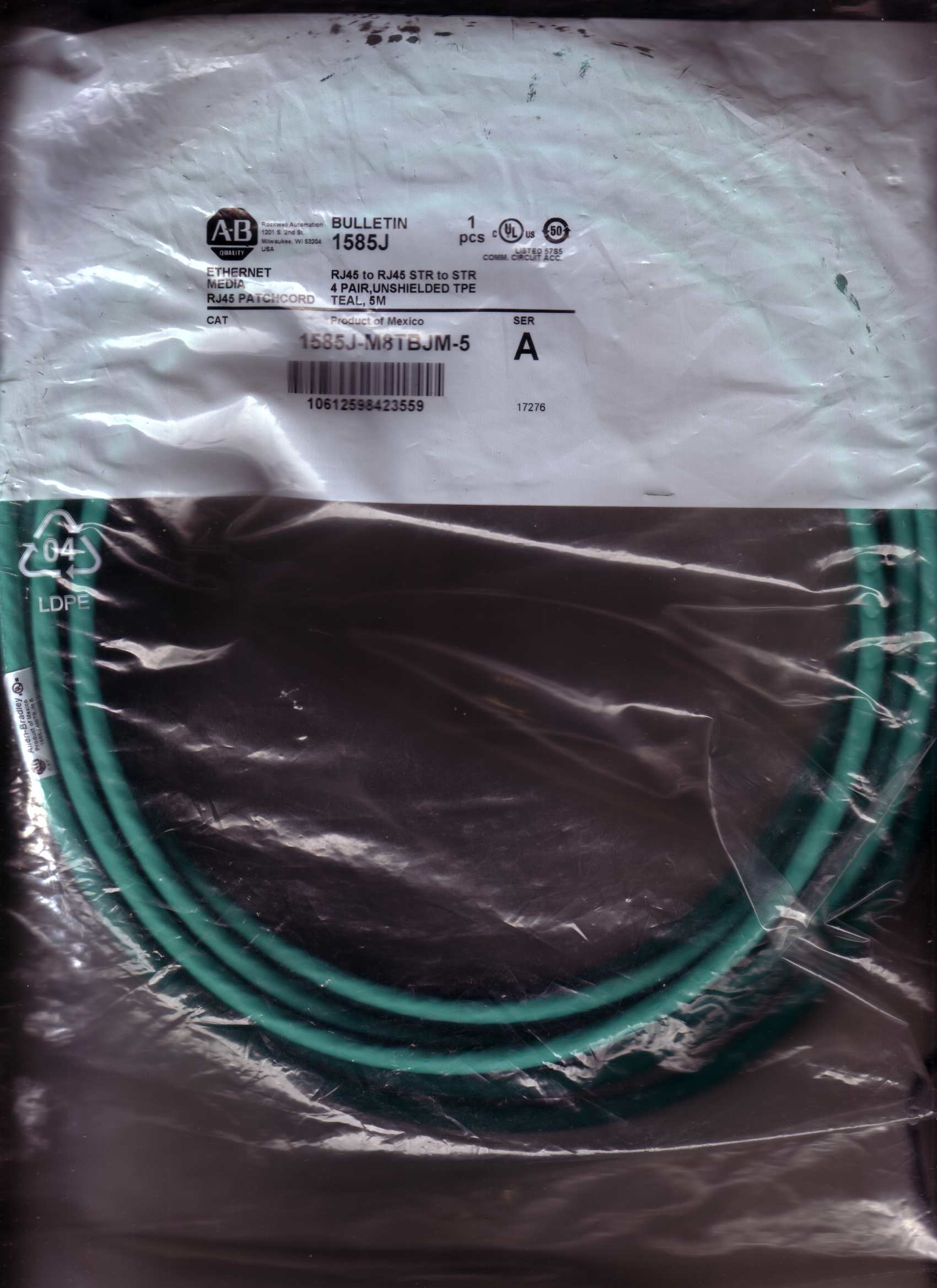

Here’s the label from a past Allen Bradley field cable if that helps. This one’s a 10’ cable, but the field also uses longer cables of that type.
Just one example online, although this one is probably a little short unless it’s for on robot use:
https://www.radwell.com/Shop?IgnoreRedirect=true&ItemSingleId=48684062&scid=scbplp48684062&sc_intid=48684062&msclkid=37ce813e2af018878d7be3b9203a7e88&utm_source=bing&utm_medium=cpc&utm_campaign=SC%20Shopping%20-%20In%20Stock%20-%20Brand%2FNumeric%20-%20Bing&utm_term=4580909046059676&utm_content=SC%20-%20In%20Stock%20-%20Brand%2FNumeric
cutsheet: Allen-Bradley 1585J-M8TBJM-5 :: Connection Cable, EtherNet, 8 Conductor, RJ45 Male to Male, Teal :: Rexel USA
