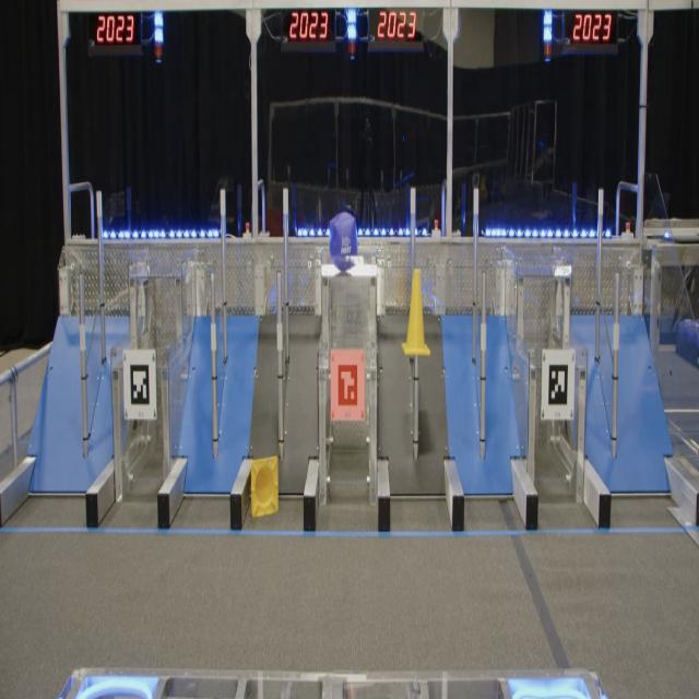

I don’t want to dilute the LimeLight training effort, but if anyone would be open to collaborating on a set of tagged training images, let’s do it!
We have had success with this workflow for detection with bounding box.
Upload and Label in Roboflow.
Build Dataset on Roboflow.
Export to TF Record.
Convert to TF Lite. Axon 2022 or TF Lite in Google Collab(How to Train a Custom TensorFlow Lite Object Detection Model).
Upload Model to wpilibpi.
Using the basic inference python script from last year you can easily test the model on your device and see the labeled bounding box detection in action.
I was wondering if labelling could be partially automated using a tool like this, or maybe using a basic blob detection routine. But then I think, if an algorithm could reliably auto-label the images, there would be no need to train a net.
Still…
Here is our dataset with 300 labeled images.
We will be adding about 100 more cone images early next week to help improve detection of non-upright cones.
