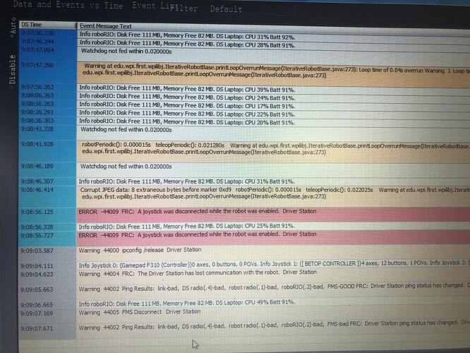

What happen with 6987 in finals 2 when they drove off hab 3? Almost seems like when they backed into the drive station wall a encoder got messed up or something? Anyone have any insight as to what happen?
They were lagging the entire match.
Ok I was wrong. Just got information after the team landed in China. Coach confirmed it was connection problems with the field. Their joystick lost connection.

There was a connect error that we lost two joysticks connection at that time.
However I still don’t find it strong enough to explain why our robot just rushed out of the HAB. Maybe our drivers were too nervous to operate correctly that moment. Whatever the reason. It’s still our fault that cause this final 2, or maybe even the whole finals to lose, my apologies.

Thank you. I just want to find out the reason our robot behave like that, and trying to make sure it won’t happen again. Love you guys and hope we could meet & play next year.
