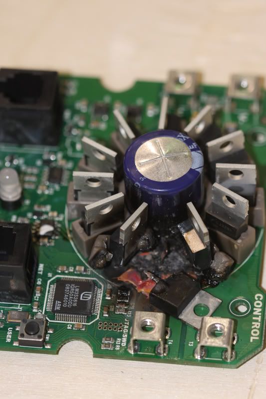

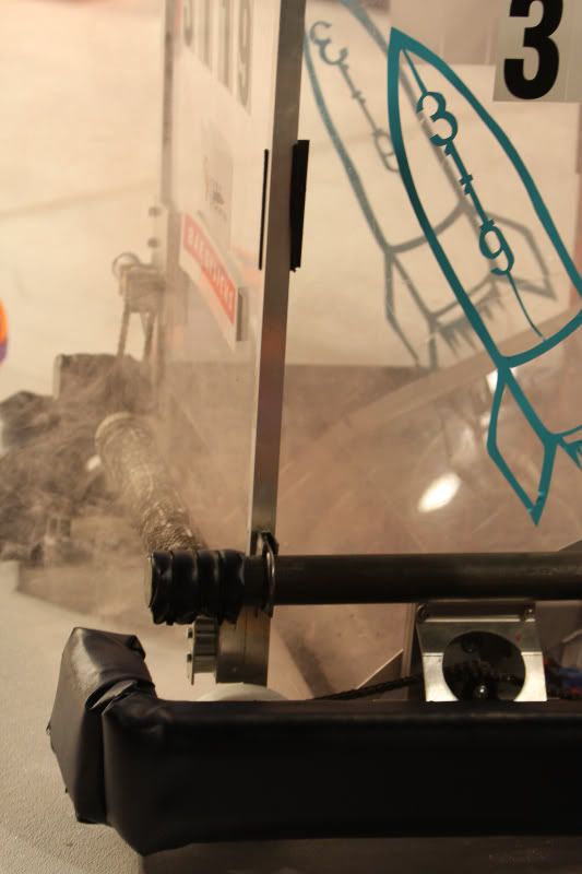

On our practice day at the Michigan State Championship. Our robot began to smoke during a match. At first I thought that the robot had caught on fire because it was so much smoke coming from it. We then took it off the field and mentors from so many different teams cam to our rescue. Even volunteers for the event came to our pit. It turned out that it was a piece of aluminum shaving that fell into the Jag which shut down the fan and caused it to overheat. I really appreciate the help that came from the teams and volunteers( especially team 1718 for the new Jag).
Has any teams had any similar problems???

For years First Teams have assumed that metal cuttings have found their way into victors and caused them to short out and fail. Now the same assumption is being attributed to the Jags. I submit that some of the failures have been from metal but, a far larger number of failures are Fet heat related. Our speed controllers are hard switched and subject to avalanche conditions. That combined with the higher switching frequency and switching losses in my opinion are the reason for many of the failures.
Well actually some of the mentors that helped us out believed that it was caused by a shortage in the power distribution. We really never came to a full conclusion to if it was really the metal or the shortage.
a shaving causing a short inside the jag or stopping the fan that results in te jag overheaating could have shown similar results, you are right. The fact that a single mosfet is blown leads me to beleive that your shorting idea is the way to look, because overheating would have affected all the fets.

I have seen enough failures to recognize a metallic short as a cause in many failures in either Jag or Victor. The good news is both controllers have FETs that are capable of higher currents than we demand. Although there is some good protection of the boards, a metallic fragment or a lot of filing dust causes a nice path between the gate and source. That said, the Jaguar one direction only failure is not one of these that appears to be caused by metal. The gate driver chip is failing without a FET failure. Everyone should remember that the fan blows down against the FETs so any metal on the top gets moved by fan action. In the Jaguars, the fan runs whenever there is an output and for up to 10 seconds after the command ends. The Victors run all the time.
