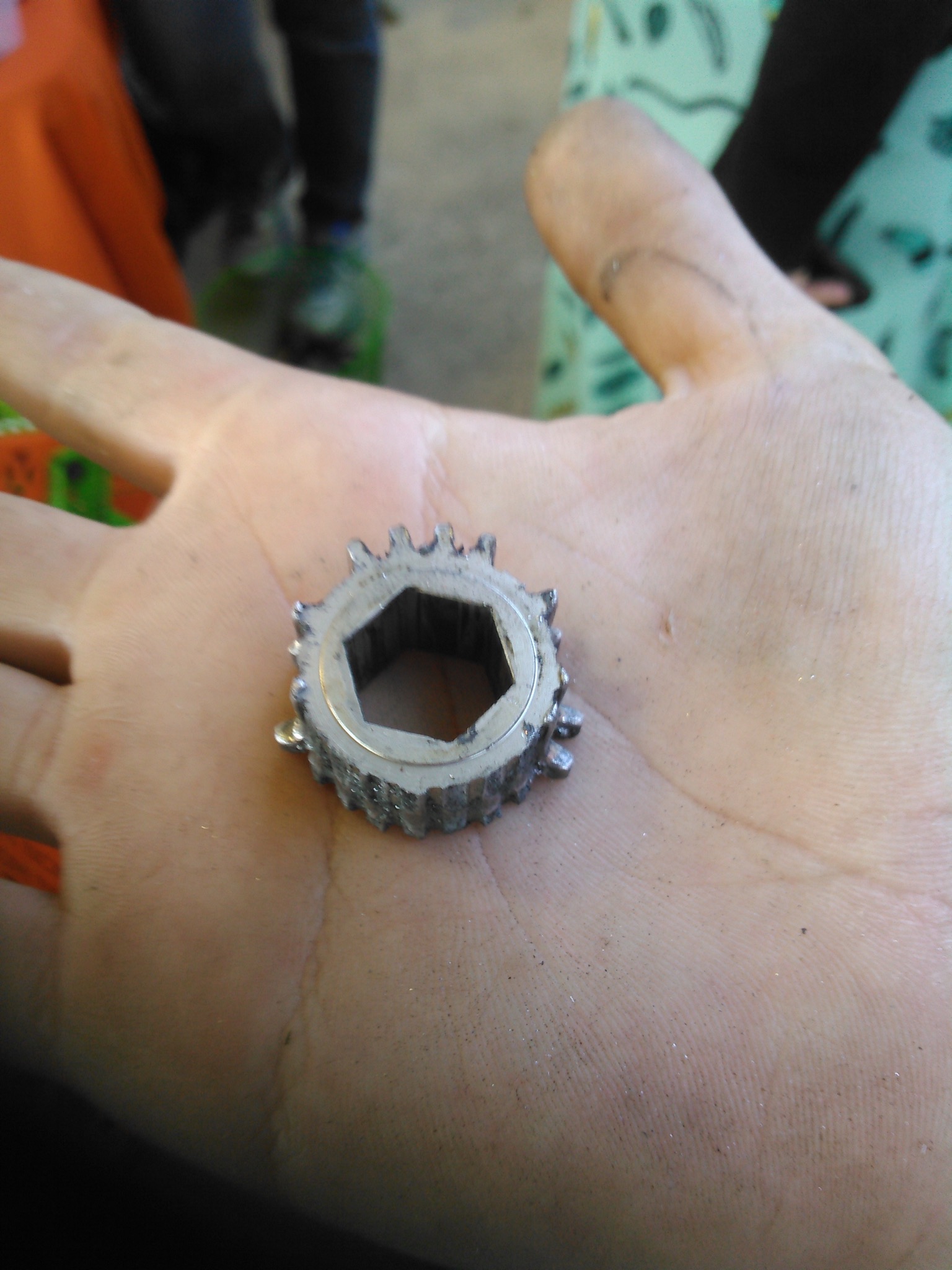

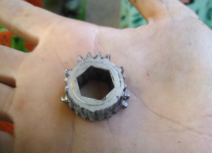

It didn’t happen till the off season, but we completely destroyed a ball shifter gear. Other damage includes innumerable broken chains, 3 destroyed intake plates, and a bent frame rail.
The gear on the other side hasn’t lost any teeth yet but is showing a pretty bad wear pattern so we’re replacing both.
Is that 1/2" hex to 3/8" hex on the same shaft? Based on the shear it looks like the step up to a larger size may have helped make the near perfect shear point.
Looks like the 5/8" step down to the 1/2" hex on the WCP Dog Shifter output shaft.
Regardless, this Step down is the exact spot to expect a failure on the part.
Gotcha - didn’t see the slot at first.

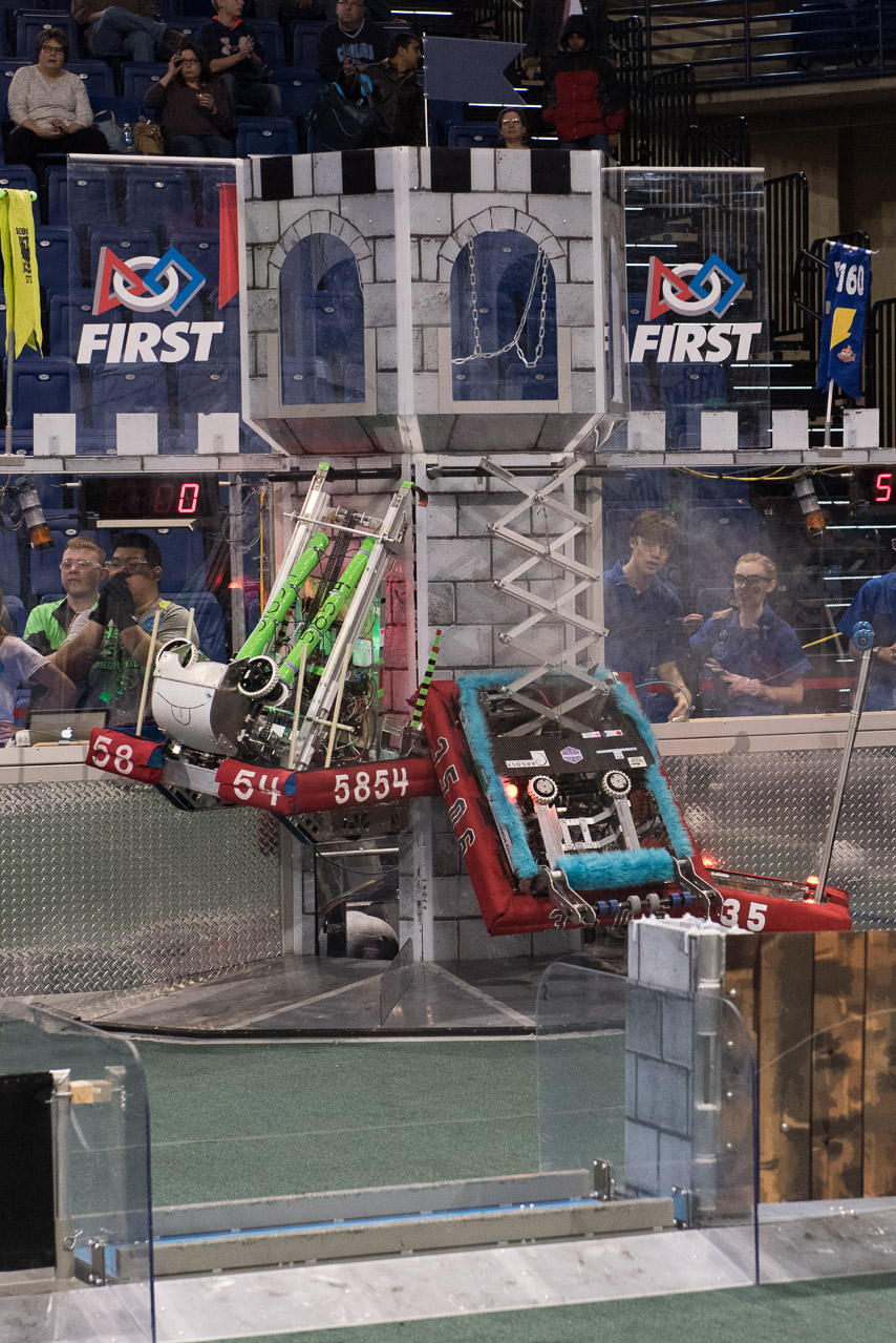

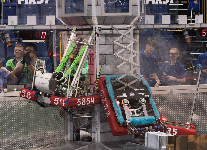

We almost scored a low goal like this, but the right side of the intake hit the main breaker. We were able to aim reasonably well with the turret bolted back on for the finals, but that robot won’t be scoring any time soon.
