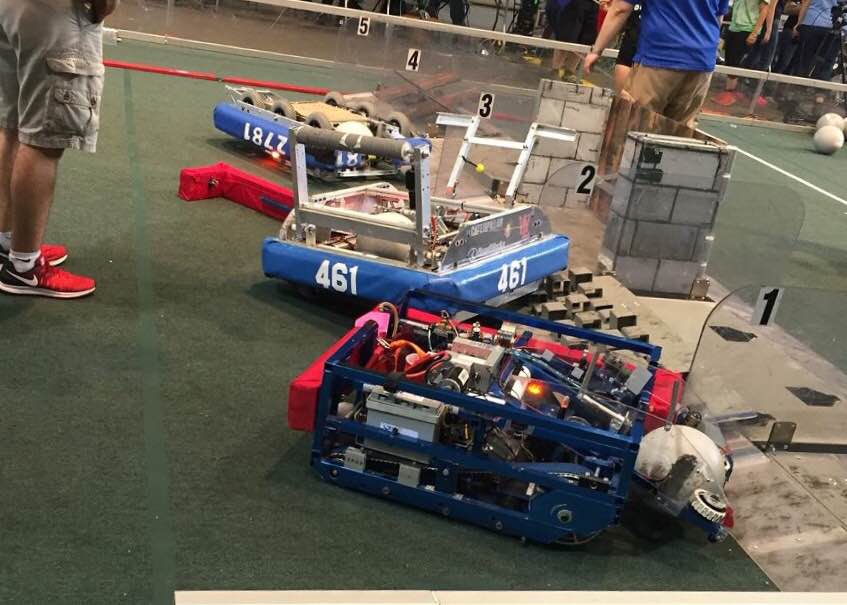

As you can see in the picture, 2781 flipped over, we (234) lost a bumper, and 461 dislodged a defense. I believe this all was in auto. Thank goodness, we were able to replay this match because of the field fault.
Edit: Also, all 3 of us are on the same alliance. This was at the off season event Boiler Bot Battle so correct colored bumpers were not required.
