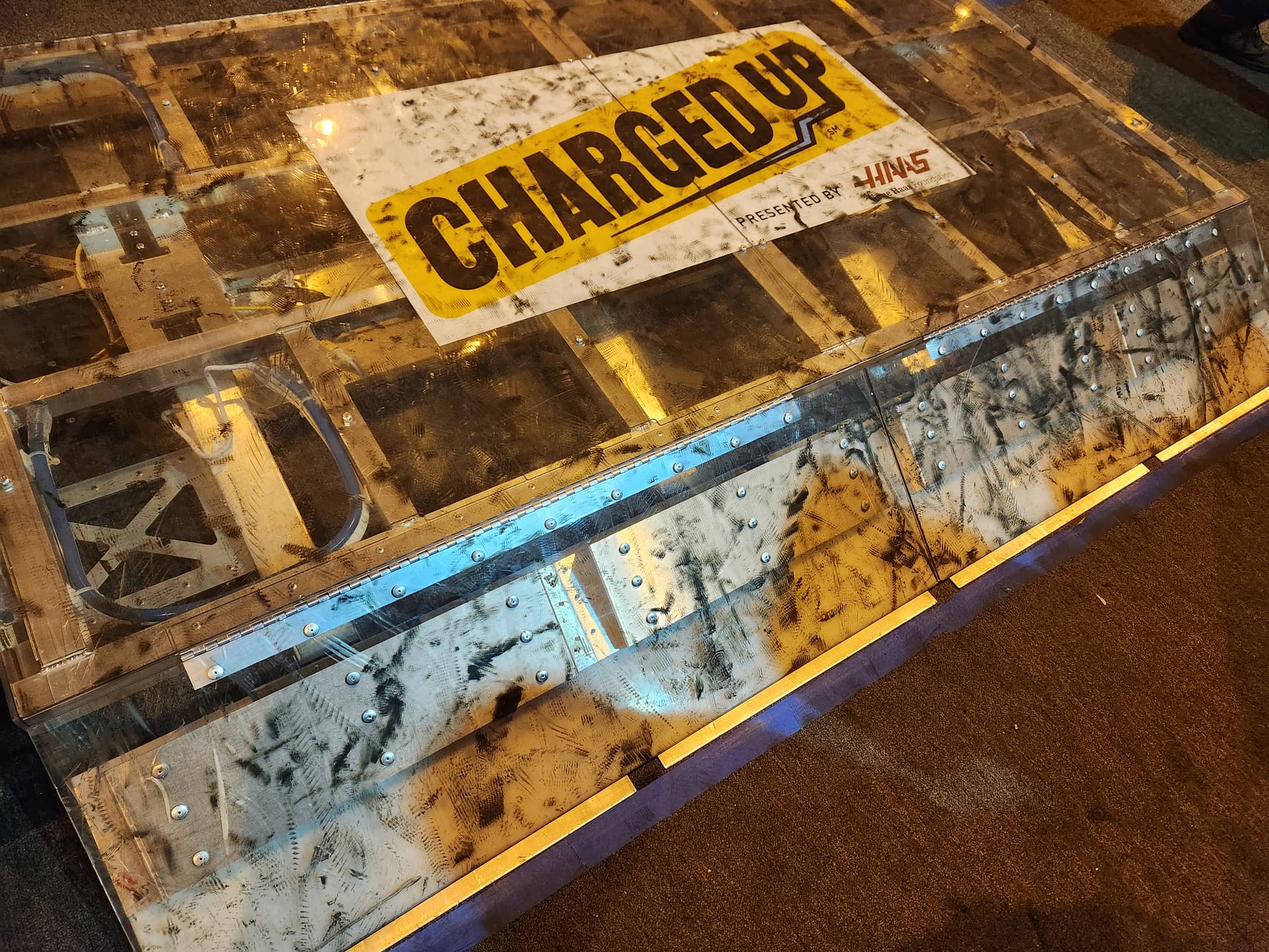

This was at the end of PRACTICE DAY at Hueneme (a week one event):
Just leaning into the Haas sponsorship and rubbering in the track.

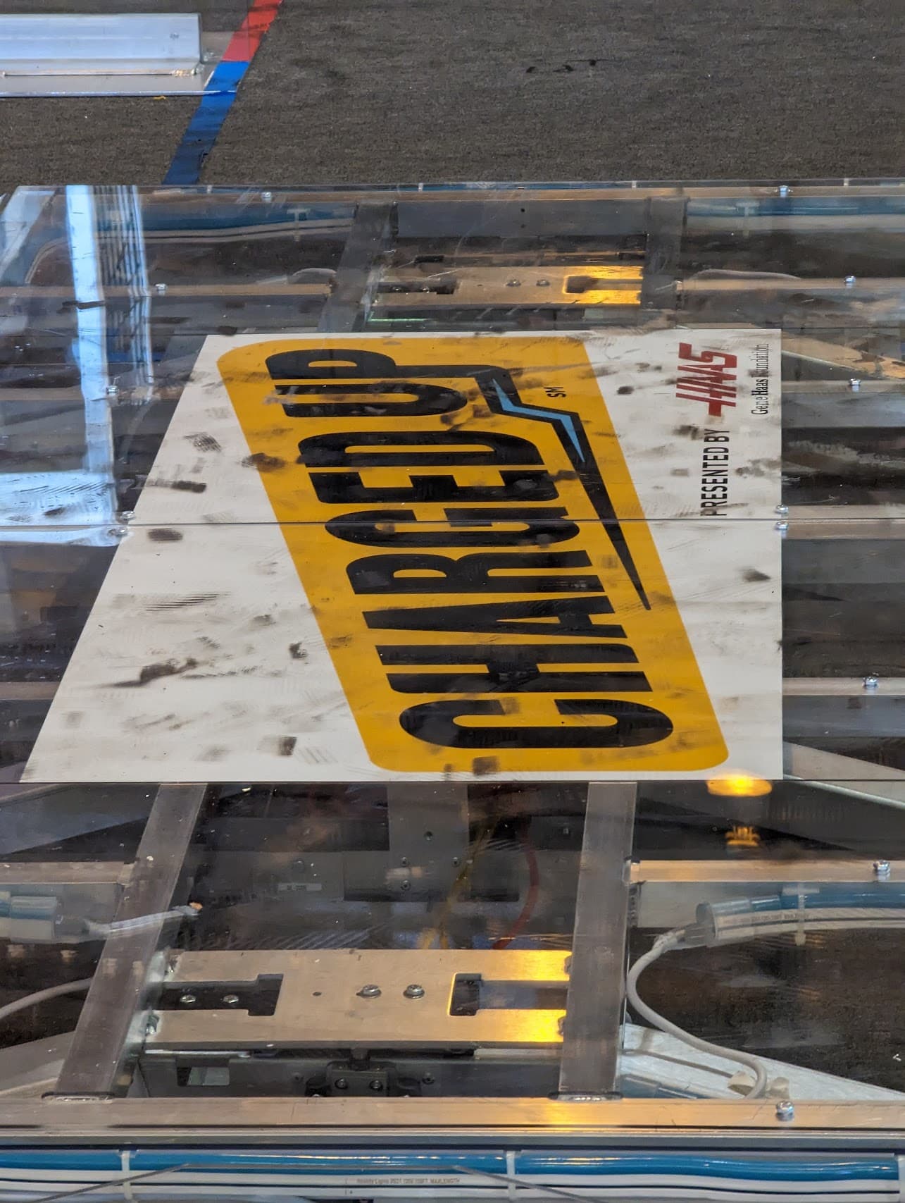

After finals, for reference.
I’ve heard that black nitrile treads are very popular in California. Actually, they are very popular in Michigan also.
Assuming that correlation is causation, I will speculate that Hueneme Port’s CS is much more blackened that Calvin University’s because of the larger number of high OPR teams at Hueneme. High OPR must correlate with aggressive driving, right? And the field at Calvin only had one team with OPR > 50, while Hueneme had five. That’s gotta be it.
So to save the CS artwork, we need all teams to dial back their OPR.
/sarcasm
