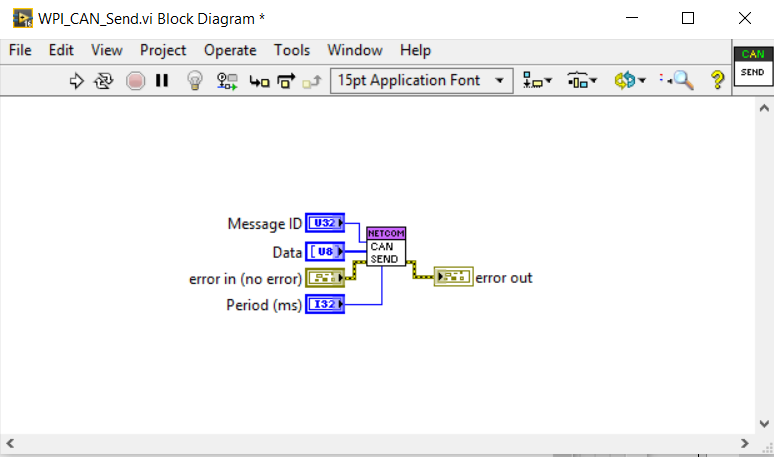

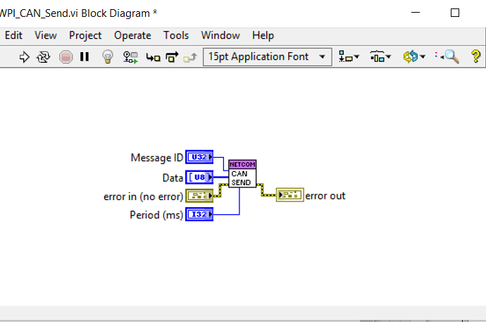

I was looking through the WPI library for LabVIEW, and I didn’t see anything that references CANopen. The context help for the WPI_CAN_Send.vi mentions that the VI only supports extended frames (so it should be using the Extended Frame Format).

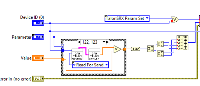

In terms of implementation, the WPI CAN VIs look pretty simple. The send VI takes an arbitration ID, an 8-byte array of data, and a period. The receive VI takes an arbitration ID and a mask for the ID, and returns an 8-byte array of data. Those two VIs, along with the VIs for the TalonSRX, use a VI called NetComm_CAN_Send (and Receive). It looks as simple as supplying an arbitration ID, the data, and timing.
