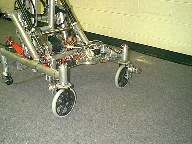

What do you think would happen if you only had 2 swerve pods and casters in the other corners? If you put two drive motors on each pod, could you get 90% of the same mobility that a normal swerve bot would have?

The main drawback would be loss of traction, since you’d be distributing your robots weight amongst 6 wheels, 4 of which would be unpowered.

I think your biggest problem would be weight distribution. With many robots already traction limited I wouldn’t want any weight going through unpowered wheels.

And traction distribution. So many times a robot has one corner on a raised section of the field, which may cause one of the two powered corners to be in mid air. Trying to move a robot with one module would be tough too.
I swear there was a bot on 2011 archimedes that had this and some omnis in kiwi-ish orientation for rotation control.

I wish I could find a photo of it but, I’m pretty sure you are describing the Chief Delphi (47) 2000 robot. If any of us old timers can verify. Best I could find was a video from Champs.
