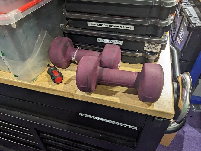

At the 2023 Western Ontario district event, a robot inspector said we could not mount a 10lb mass with 4 (four) 250 lb tensile rated zip ties. This is a factor of safety of 100x
A 600lb tensile load rated plumbing strap was offered as an alternative by the inspector. Links below to the zip ties and plumbing strap. This would work great, but would require holes to be drilled in the weight in question to use.
Is there a factor of safety that inspectors would consider safe?
I’m not trying to challenge the inspectors or be difficult, just looking to get zip ties that are correctly rated to add dead weight to underweight robots without requiring the drilling of holes in the COTS weight.

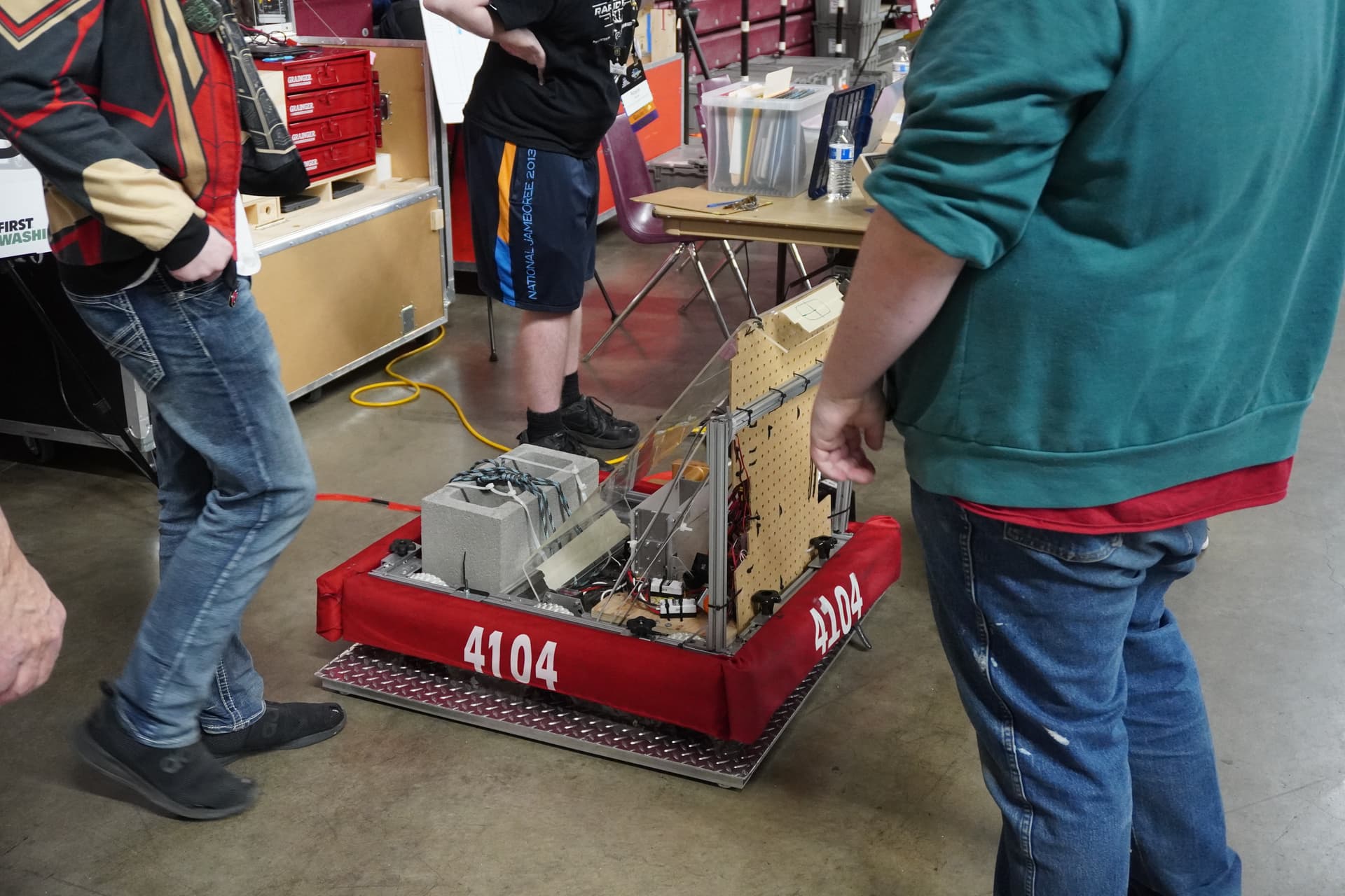

Last year, 7461 at Sundome attempted to add some ballast to their 3rd pick, 4104, using a cinderblock. While it was well secured vertically secured using zipties and rope, the inspectors had the concern that it would be able to slide out horizontally of the zipties/rope, and find its way onto the field. 4104 ultimately removed the ballast before the beginning of playoffs.

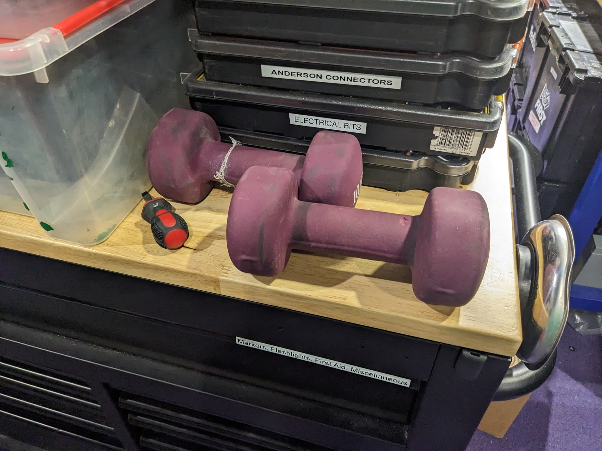

I don’t have a picture of the weights in situ, but these are the weights in question. They were planned to be mounted around a 2x1 above the kop chassis, and butted up against another frame member. One weight on each side.

Thanks for clarifying, I was picturing raw steel blocks, the weights you’ve pictured with no sharp corners those are a lot less of a concern, remaining question would be the corners on the tubing it would have gone around. With multiple zip ties that could likely have survived a match, and replace zip ties before next match if any signs of abrasion showing.
