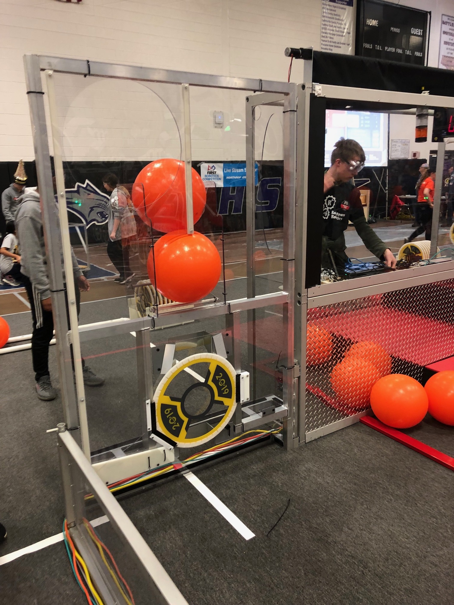

What is going to be done about this?
We had 3 separate matches (out of 9 today) in which game pieces got stuck in our loading station. Of course per the rules, the human player cannot reach in to push it through, and cannot bang on the alliance station wall to coax it out. We tried to weigh it down with a second cargo but just ended up with multiple stuck cargo.
As a non-student coach, I sent the human player to the question box, and in every instance the students reported to me that according to the FTA, “the warmer air in the gym is causing the balls to expand”. Whatever the reason may be, is something going to be done about this?
In every case the outcome of the match didn’t change so we didn’t further argue it, but I did quietly point it out to the refs every time I went out to retrieve our bot.

If the balls are expanding, you should point this out to the field reset personnel before the match so they can relieve a little air.
That’s not even remotely the point here. It shouldn’t matter if a team can pickup from the Depot. FIRST’s field should operate as intended or it should be a field fault. Make sure the Cargo Pods are the correct size, give Human Players a ram rod/stick to free the stuck Cargo or find another solution to this problem. I’ve been on the wrong end of a non-called field fault before and it sucks. I’d hate to see this field fault cost any alliance a match.

The Cargo is measured by field personnel. As for cargo or hatches getting stuck yes it can happen as anything can. There are plenty of both that go through just fine as evidenced this in weeks matches.
Sometimes the field will flex and that can unstick a hatch, as for Cargo another might save a foul if it works or perhaps takes the foul is another option as that part is harder to flex.
Things happen.
That being said yes field fault request is another option.

At Montreal they had a special tool that was basically a frisbee with a diameter of 13in with which they put the balls through and change the diameter of the ball accordingly. it’s a long process but if there were something to be done, it would most likely be this.
5690 built a mechanism to measure the cargo early in weeks 1 or 2. It seems that FIRST would have this type of mechanism on hand to measure cargo.
They do, its a set of three rings that vary in inside diameter, 12.5", 13.0", 13.5". There should be a set with every field.

Kudos to the volunteers at The Gibraltar FIM district this weekend. They used the FIRST provided gauge to frequently check the pod diameter during the competition. We did not have a single pod get stuck in the loading zone.
I believe the rules state it is up to the teams to identify oversize balls. After the first oversize ball got wedged in our ball pickup at Gibraltar, we made an aluminum jig you can drag along the ground to instantly check. Didn’t happen again. Many balls were deflated. At one point 30% of the balls on the floor had some air released.
My concern in Duluth is that the balls will arrive frozen and will need to be warmed significantly before we can inflate them. We could experience this exact same issue, inflating a ball to 13" at 30 degrees would take more pressure than at 70 degrees. So if we inflate them, then let them warm, they may all end up oversized.
If the balls really are expanded, they need to be resized to at least 13.5" diameter. The pressure is not specified, the diameter is, possibly for this exact reason

The simplest solution I can think of is a pokey-pokey stick, which can be mounted in the loading station to encourage the ball out. PVC pipe is cheap and abundant, and any event’s machine shop should be able to hole-saw the back piece of polycarbonate.
