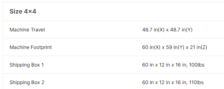

Now, I have yet to see anyone post info or experience about the 4x4 Omio that West Coast Products has.

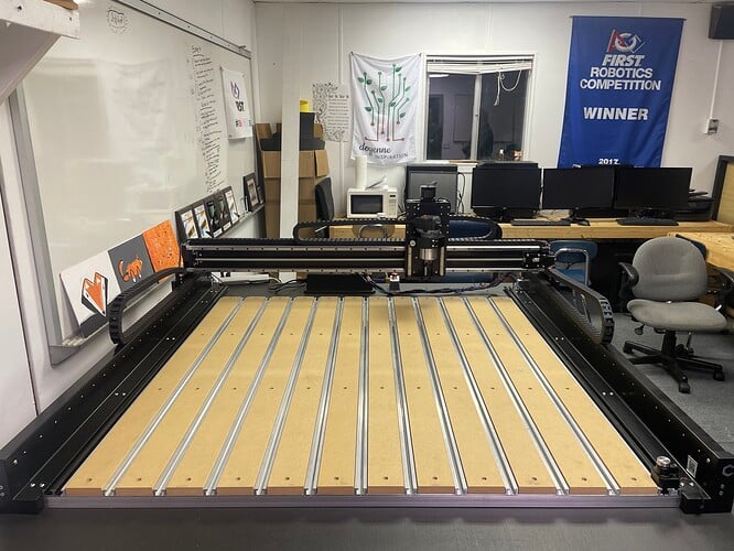

For right at 5K we got a shapeoko five that has a 4’ x 4’ bed.
How has your experience with the Shapeoko 5 Pro been? (set up, using with polycarb and aluminum , zeroing with/without the zero tool). We are planning on using Inventor CAM and Carbide Motion, but are open to alternatives. We recently bought one for our lab space and will be setting it up soon.

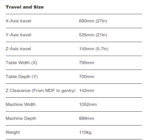

I’m starting to look at Shapeoko…their bigger machine is the HDM. Anybody know it?
We looked at the HDM but went with the 5 pro since the bed size is larger:
Shapeoko 5 Pro
https://carbide3d.com/shapeoko/shapeoko5pro-specs/
Shapeoko HDM
(under specs)
We liked the out of the box potential of the Shapeoko HDM, but decided that the set up and cost of the 5 with the spindle + Add-Ons combined with the larger bed size was better value.

Weve used the Shapeoko 3 XXL for 2? years and its been amazing for both poly and aluminum. We just set up our 5 and plan to start doing test cuts this week to test speeds/feeds and how well the zeroing actualy works and report back! (Probably on its own thread talking about why use shapeoko).
One of the big reasons for going for the 5 pro was we have a 3 XXL and we had to limit our robot design to its 18? x 20? bed which was no fun so we upgraded and are testing the newer 5 pro.
Which spindle did you get?
We got the one sold by Carbide, since it is supposed to be very close to plug and play. However if you are on a budget most routers that are 65mm seem to work per the product page.

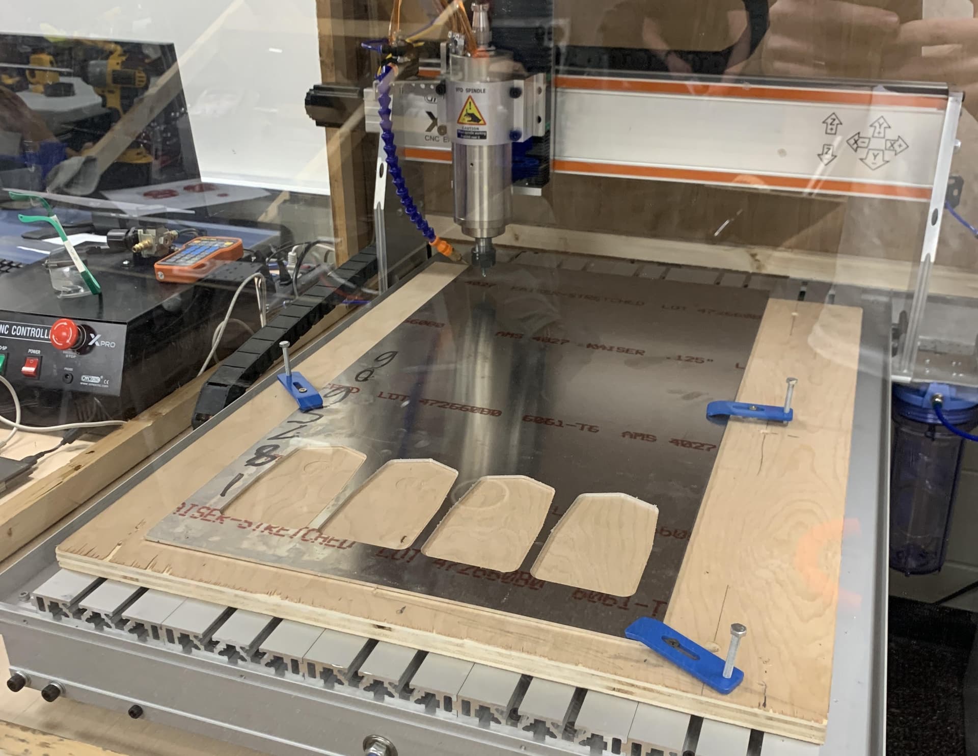

We have the smaller power route plus also. The smaller bed space requires sheets to be cut down to fit but we’ve had good quality parts out if it, both polycarb and alum. We found some runout on it doing long cuts but its likely due to the old spoil board not being flat or material held down well. I think we will try the painters tape and super glue technique instead of screws. We bought this smaller unit probably 5 years ago so I’m sure its been upgraded in many ways since. We also didn’t have a spindle (used dewalt and bosch routers), so we found alum to be slow and require quite a few slow passes. We need to fine tune our programs and can probably get more efficient but thats what we felt comfortable with last year. Polycarb was super quick though.
