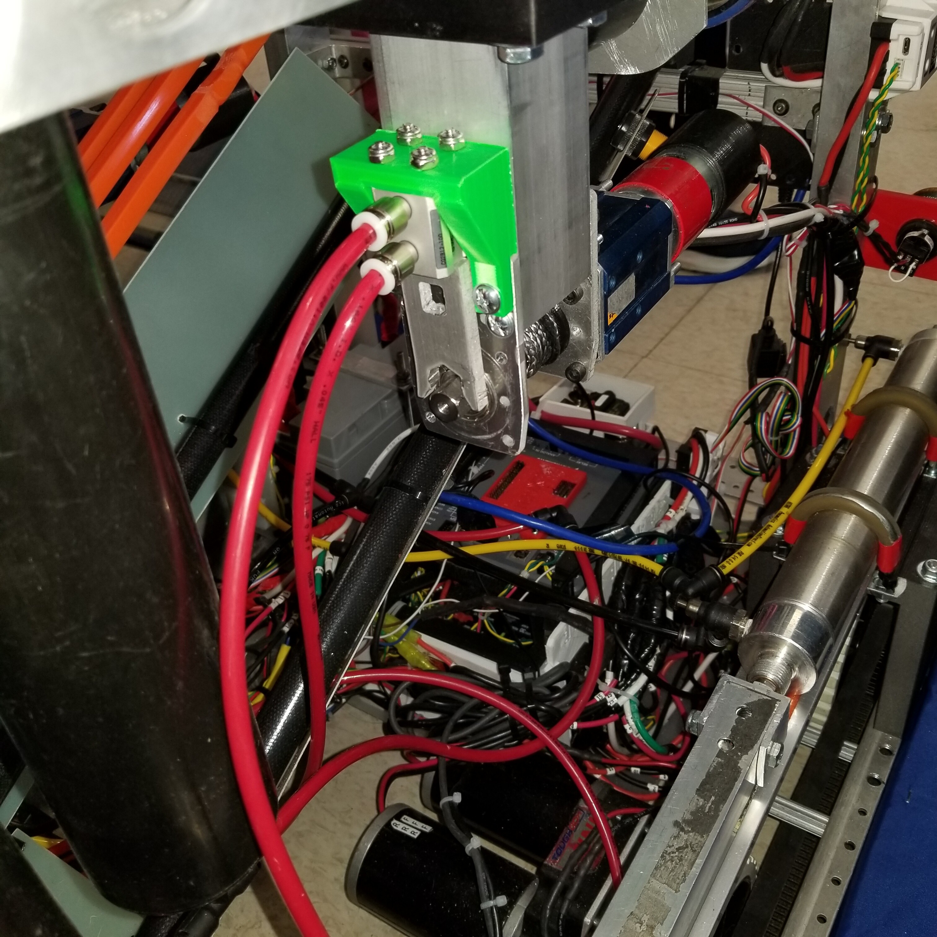

This is what we used on our Thrifty Bot climber a pancake piston and a machined out 1/4 inch 6061 aluminum slider to engage the shaft. The square hole is used to place a nut from threaded of to the piston to attach the mechanism. We custom 3d Printed the bracket to attach the bearing plate. Warning though don’t engage until you stop climbing to avoid damaging the aluminum brake. It worked very well for us at this weekends competition. The nice thing is that it is light weight and is easy to engage and disengage at any height as desired this eliminated a one way only ratchet mechanism and allowed us to make adjustments as needed to the climber height.

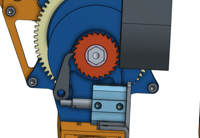

use a ratchet, ratcheting wrenches work great for this but vex also sells them to add into a versaplanetary (this one is risky as you dont get any second chances climbing, if you go too far and start driving your arm downwards before grabbing the bar you’ve missed your chance. hence you would want software control to have the arm extend to max height then stop before going back down)
to piggy bak on the ratchet you could make the ratchet actuatable by a small piston or otherwise (team 319 did this on their elevator winch in 2018 to hold position without having to stall out their 775’s, I’m sure there are other examples this is just what came to mind first)

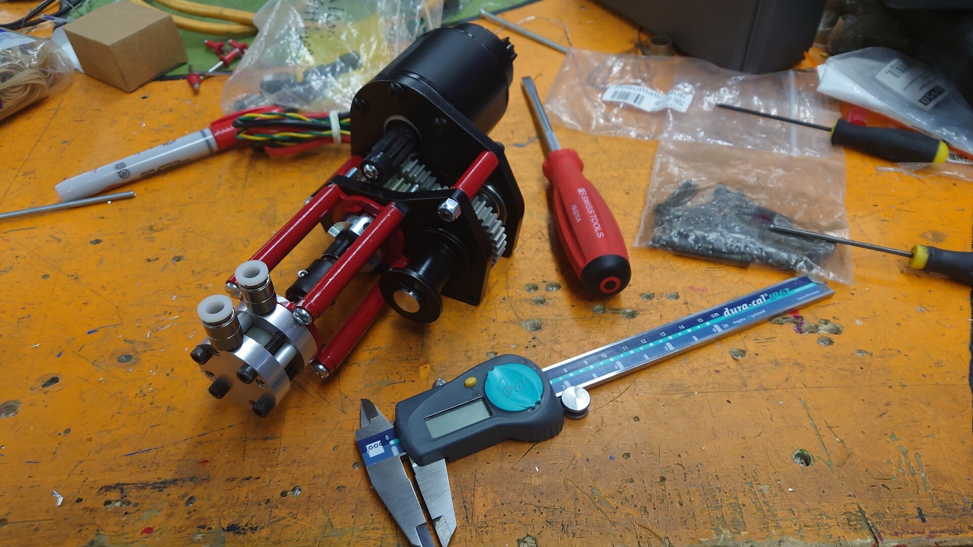

We use a Servo on a versa ratchet slice.
We have a modified WCP dog shifter shaft with a pancake cylinder that pushes the dog into a plate with the dog pattern machined into it. Fun little gearbox.

We have used pancake cylinders against gear teeth to great effect many times, but you’ve got to make sure to trigger the brake before the robot is disabled.
A single solenoid plumbed right can engage the cylinder by default. When the robot becomes disabled the brake would engage.
