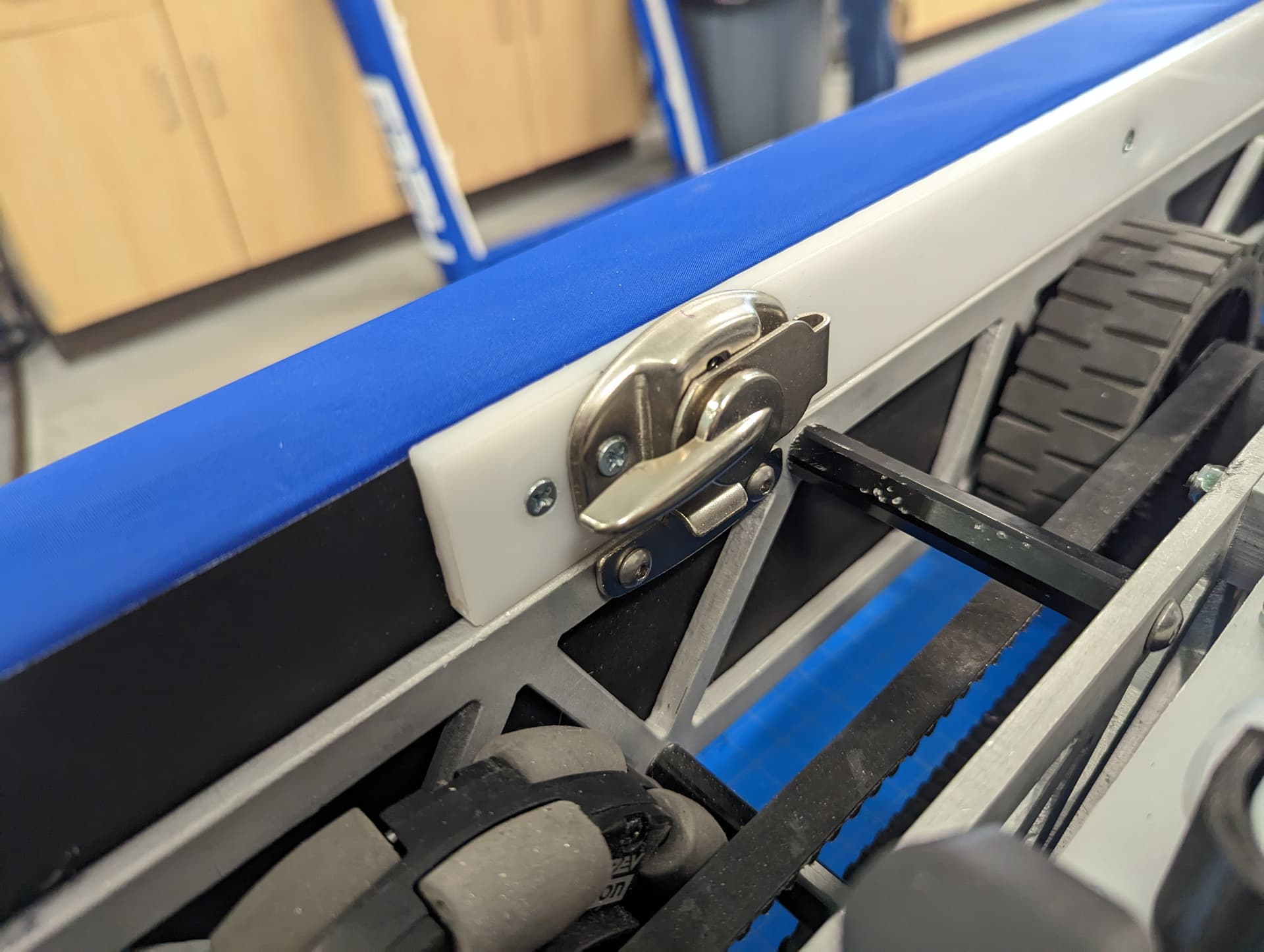

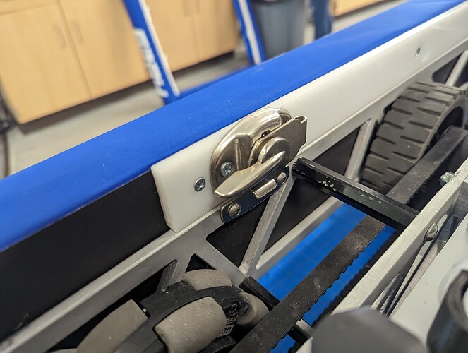

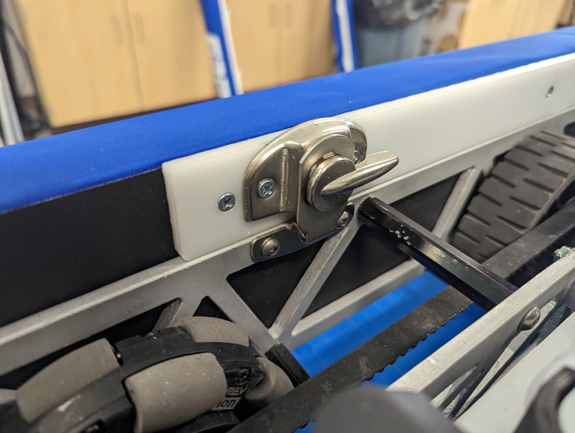

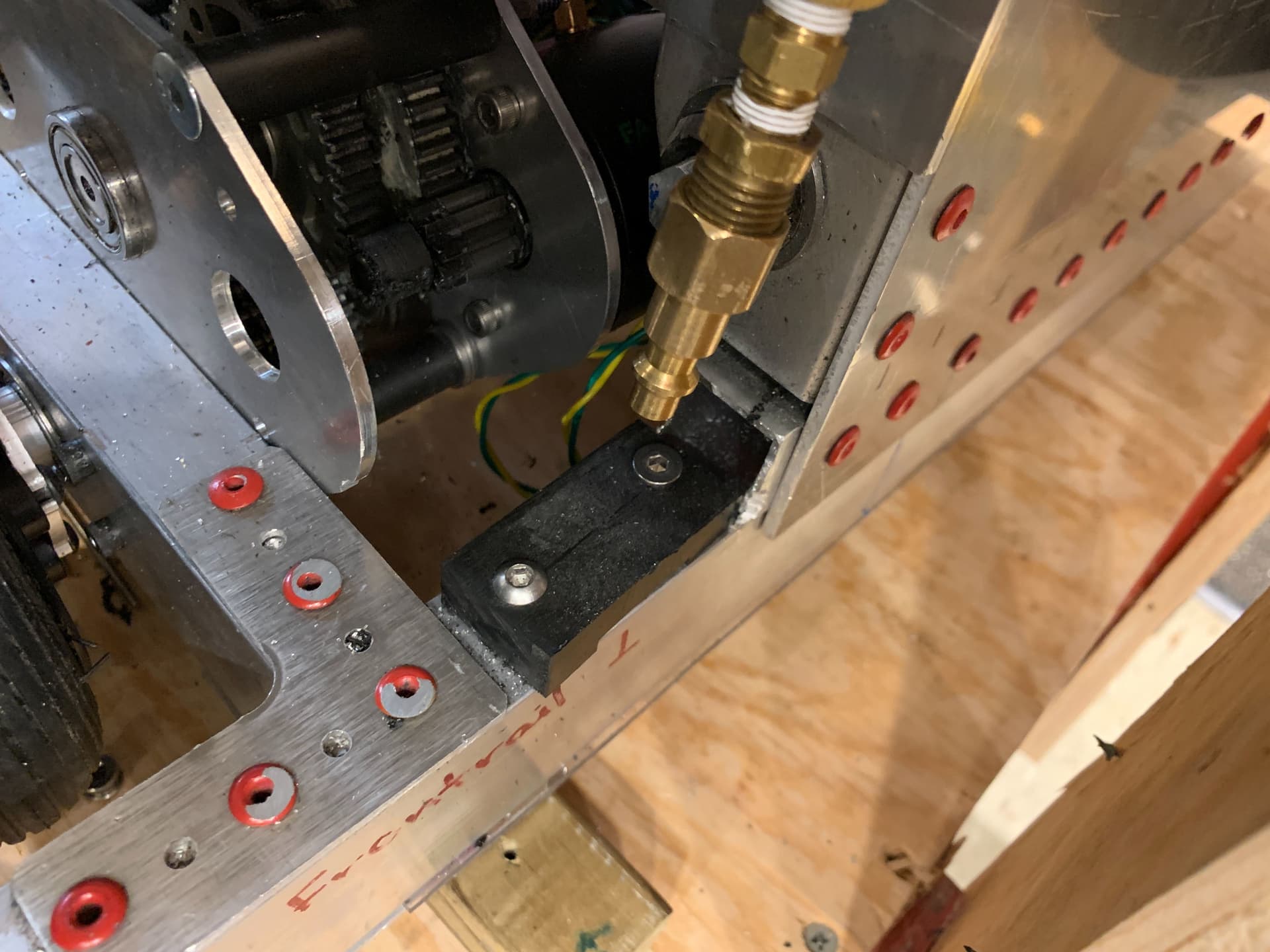

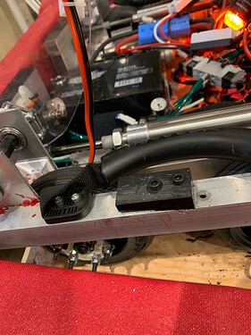

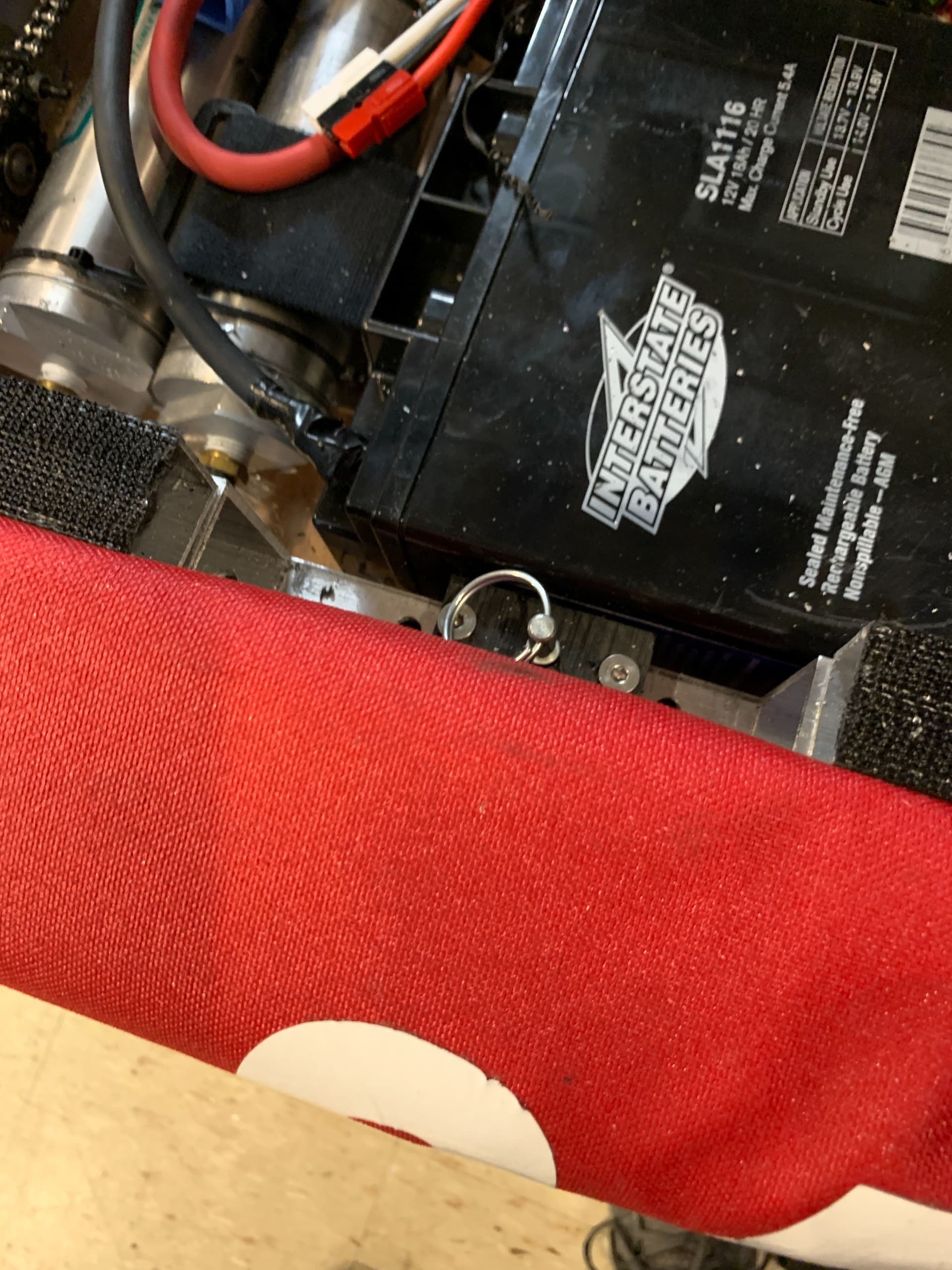

We’ve used latches for a few years with great success.
Latch open:
Latch closed:
Presumably you have these on four sides (3 per bumper if split)? Otherwise it seems like w/ that frame design a high hit could bend the bracket (eventually your chassis). Proof is in the pudding if it’s been working though!

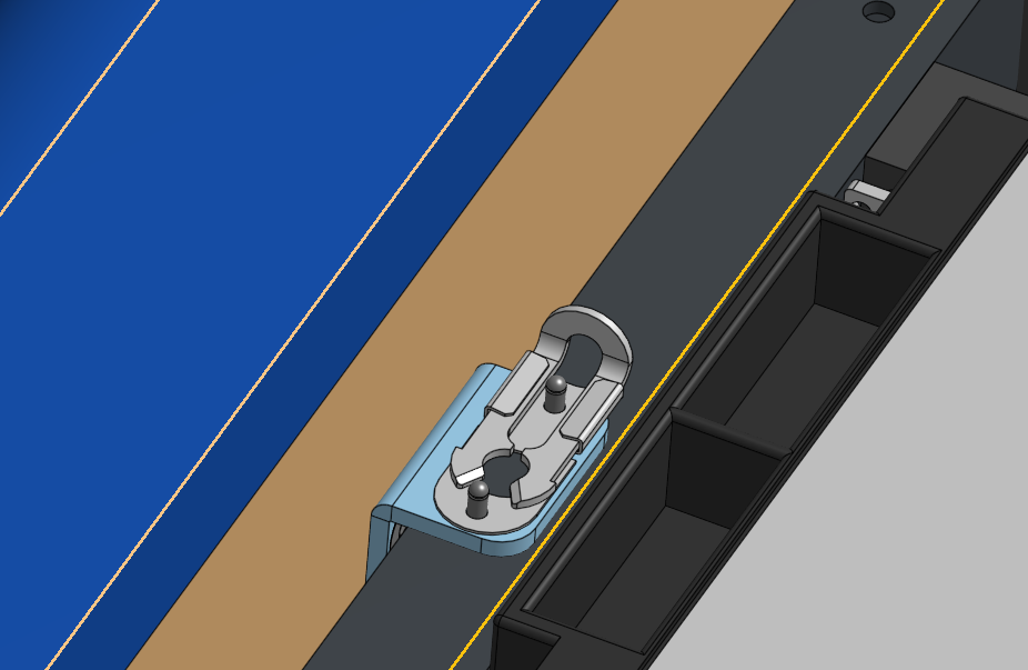

We use Dzus 1500 latches and they have worked great.
This is a solution I’ve used before that I liked. We used little delrin blocks with slots milled out of them. Then we matched drilled the holes into L-channel for a quick release pin.

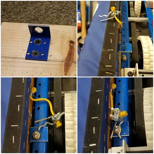

Knurled nut, bolt, and R clip. Less than $2 each
These are simple and work very well. Highly recommended.

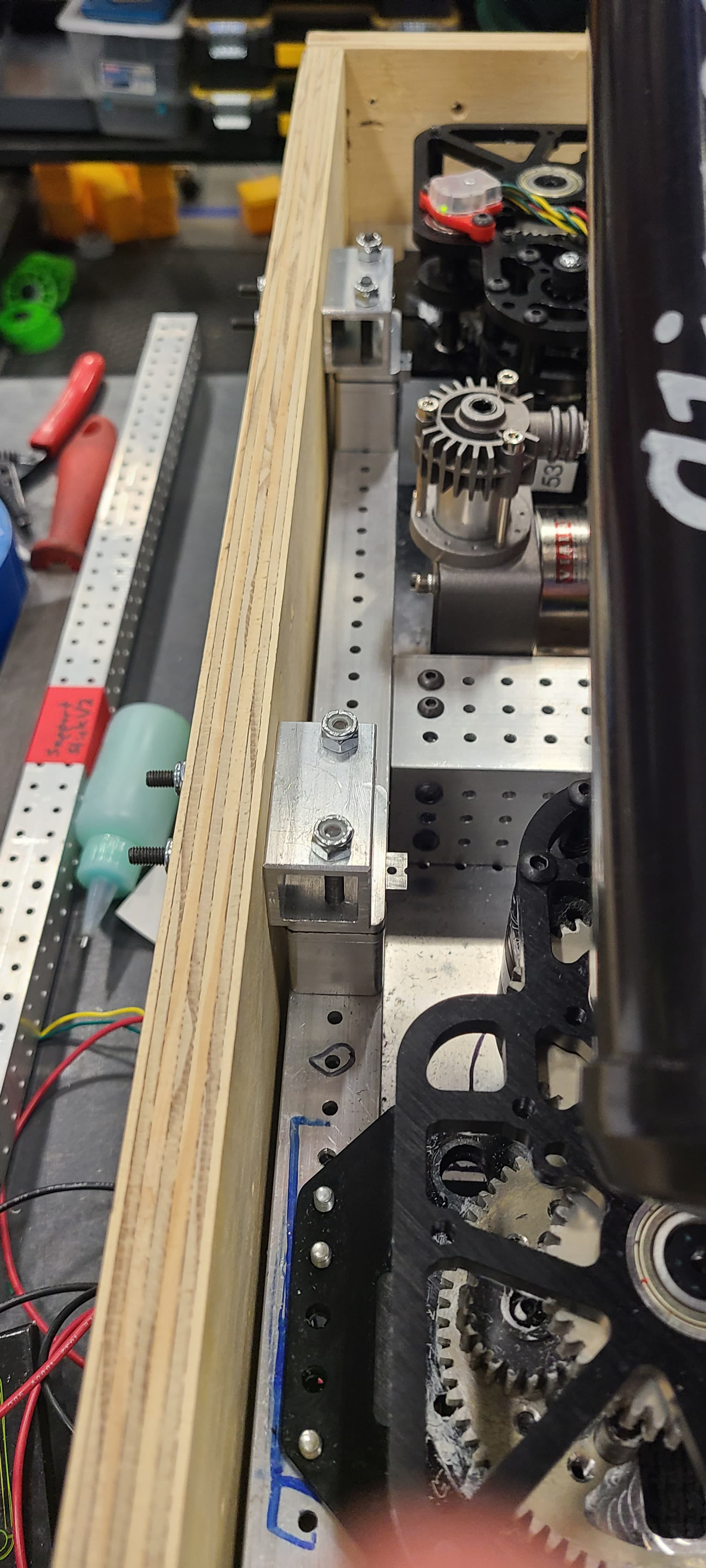

If you’re have strength or reliability problems, bolted connections will be the strongest. We bolt through plates on the bumpers into nuts captured in the drive base frame tubes.
