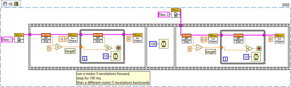

Hi!
So I have been having this issue with my autonomous code. I want to run a motor 5 revolutions forward, stop for 100 ms, then a different motor 5 revolutions backwards, but I am not quite sure how to code this. Do I use a For Loop, While Loop, and Flat Sequence Structure? Do I put my drive values on the inside if I use a Loop or the outside?
Something like this?
The motor/sensor directions may be reversed in your implementation.
Yes, this works! We used this for the arm and charge station. Thank you!
