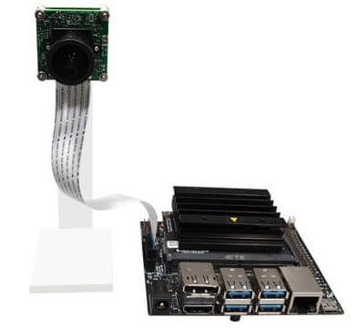

I’d also second the arducams or cameras for the rpi/Jetson nano.
econ_ecam30cunano
If you are going to do image processing you might want a coprocessor anyways and typically you get much better direct control over those ribbon cable types vs generic USB.
Arducams makes a really cool optical zoom adjustable ribbon cable camera that would really make finding long distance tags easier without losing resolution.
Livonia Warriors actually had a really great demo at their pit of their own limelight-esque solution with Jetson nano and rpi with the ribbon style cameras

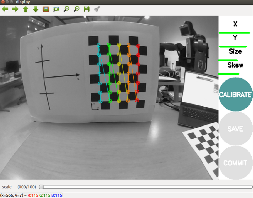

Fisheye lenses have too much distortion, and PhotonVision isn’t designed to calibrate for them correctly.
Maybe it’s time? @bankst
I have no idea what it actually takes but it seems like it would have great benefits.
ah. fair. Yeah whatever USB camera we used last year was fish eye’d like crazy. Ended up just heavily favoring odometrey
can’t imagine thats a simple calibration haha
It’s not like the current calibration algorithm was written by the PV folks
Maybe there’s already something out there
fair, i haven’t looked at the code base at all
For Duckietown and also ROS we use calibration grids to figure out the cameras properties.
Essentially by moving the grid around, skewing the grid, adjusting as it directed it can figure out the properties intrinsicly.
We need something like that for getting the properties of common FRC cameras and a way to test/cal unknowns. Maybe those existing tools are fine but limited to Linux afaik
