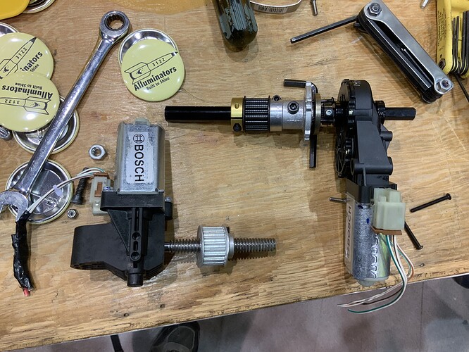

At the North Star Regional this year. Walking the pits pre-open on Saturday, and we spy an illegal motor that the inspector missed. To be fair to the inspector, it was a Bosch seat motor, only it had a different gearbox on it - since the gearbox is integral to the motor, that made it illegal. Myself and another LRI spent the next 2 hours putting together a solution.
On the left is the illegal motor. On the right is a legal seat motor, broached to 3/8"hex. We didn’t have any 3/8" pulleys though, only 1/2". So, we needed an adapter. We ended up using a 3/8" female output from a VersaPlanetary, along with a carrier plate. Popped the pins out of the plate, got it drilled out for some bolts. Bolted that to an andymark 1/2" hex hub by drilling and tapping into the hub. Did the same to put a bolt through the hub into the shaft to hold the hex shaft on there, and used the set screw on the female adapter to hold the other end onto the 3/8" shaft. The whole thing was as improvised as possible, and it worked just fine for their remaining matches that morning. NOT something I would ever do if I had a chance to plan ahead!

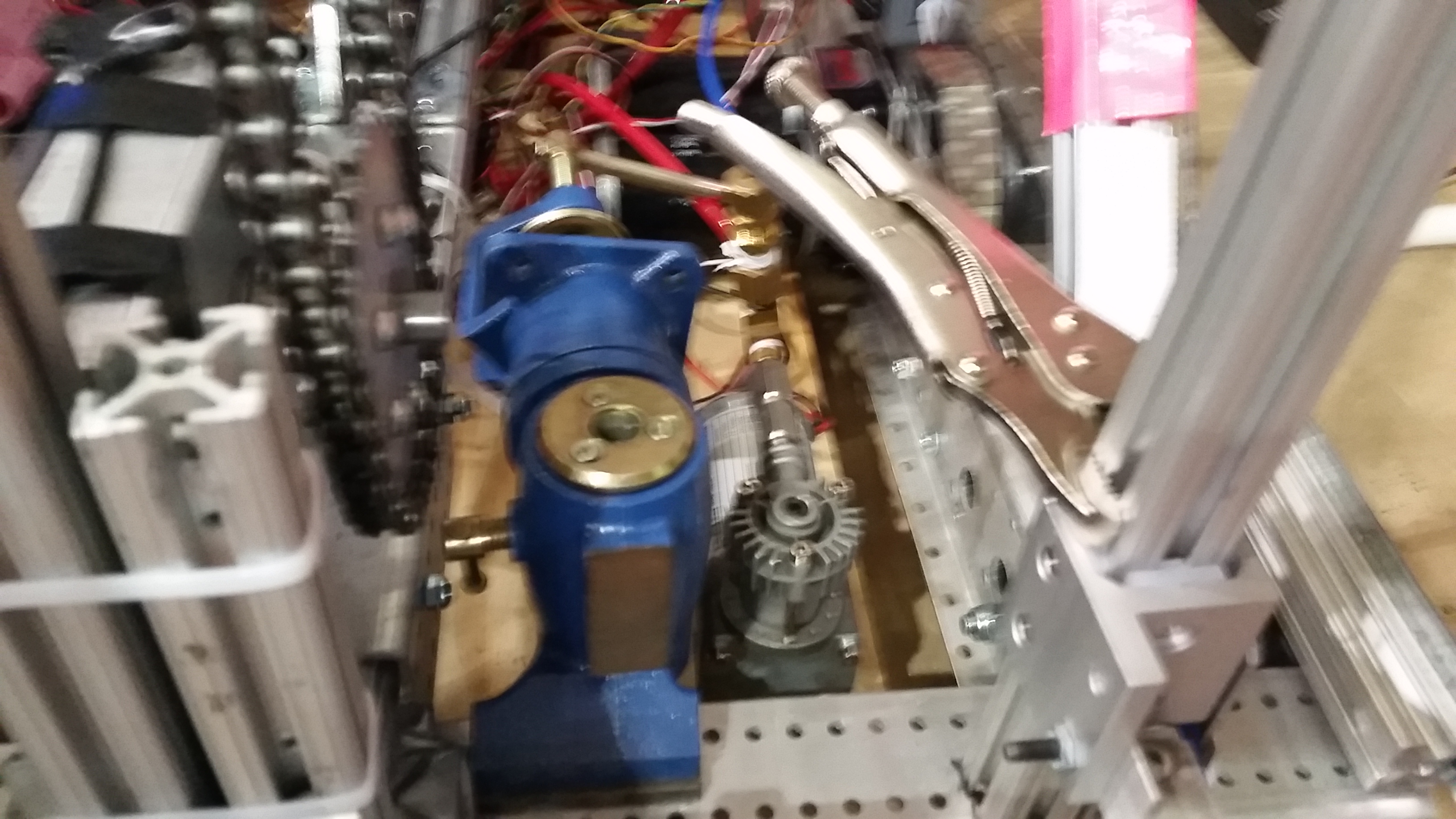

I only regret that the picture is blurry, but there is a lot going on, here. This was from the first season I was at the team, and all the kids (and me) were all FRC rookies. So we totally had no clue what we were doing. It was a terrible robot. There is a big blue vice attached to the back of the robot to counterbalance the 4-bar lift that was used to (attempt to) pick up the recycle can to place on top of a stack of tote. There is a vice that is holding the back part of the robot together, as well as a ton of zip ties and duct tape. This was at an offseason so I guess we got away with it because there wasn’t really any inspection. Boy, were we bad. :grinning:

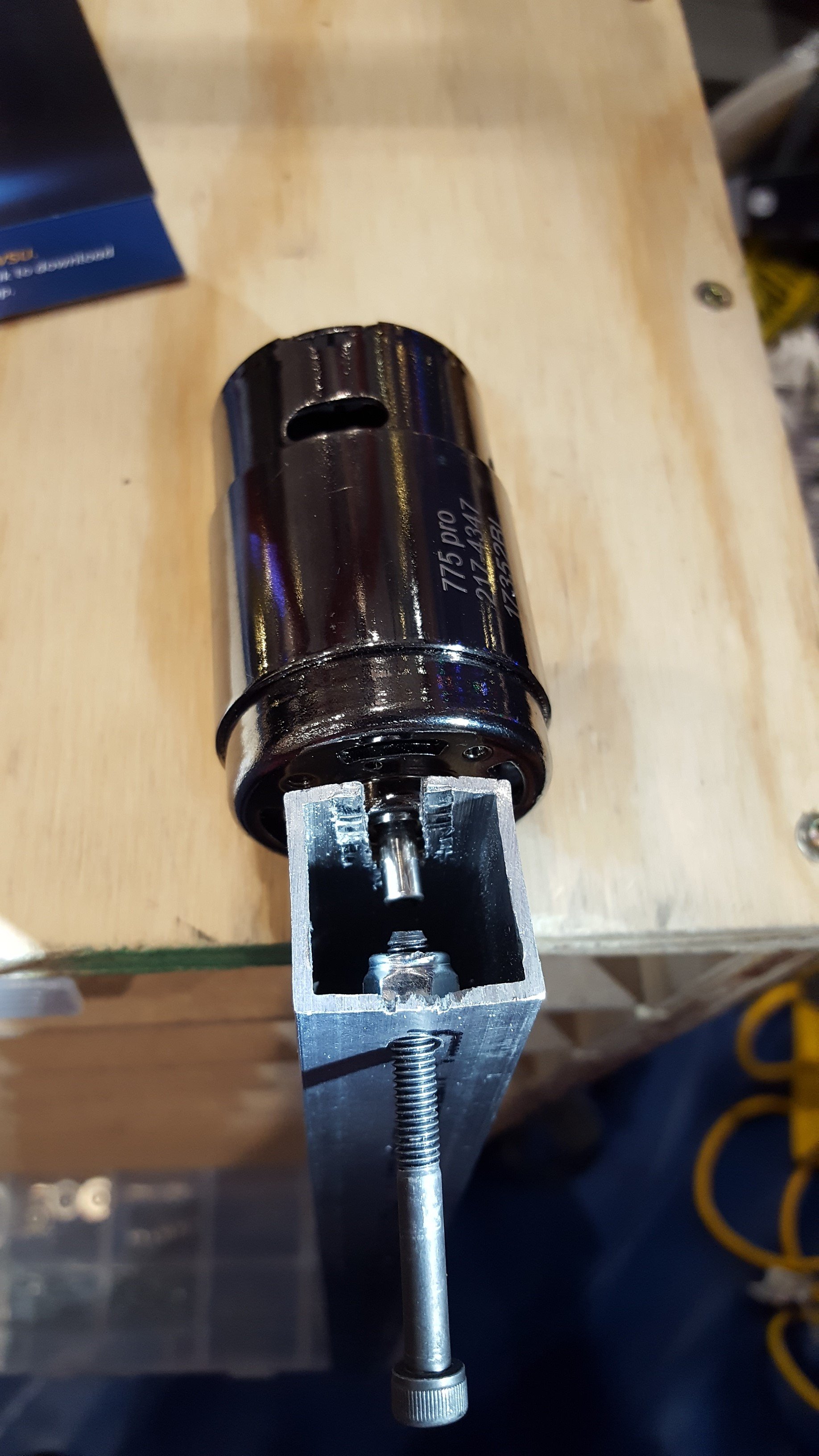

At Livonia this year, we burned out our two 775 motors powering our elevator. We had two spare motors but no spare pinions. None of the other teams had a gear puller, so I made one with a drill, hacksaw, and a hammer to persuade the motor into place. It worked great!
