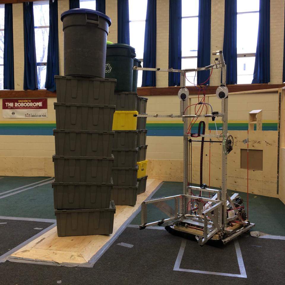

In 2015 we hacked together a practice bot with an old C-base frame. The axle spacing didn’t lend itself to 4WD very well, so we ran the chain through short lengths of pvc conduit and pulled the tubes together with duct tape to tension the chain. You can barely see it in the attached photo. Worked all season!

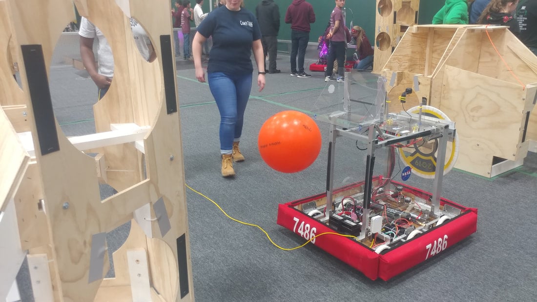

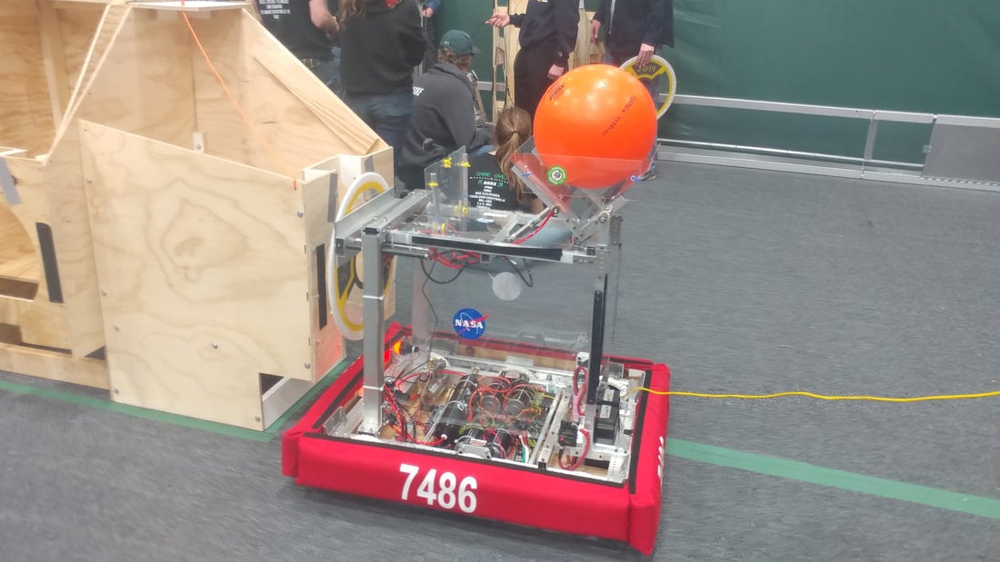

Our main jerry-rigged thing last build season was our cargo system.
We came into competition with 2 pieces of Lexan and a lot of zip ties.
We were actually able to make a functioning cargo shooter.
Also, the cameras were jerry-rigged with, you guessed it, more zip ties.

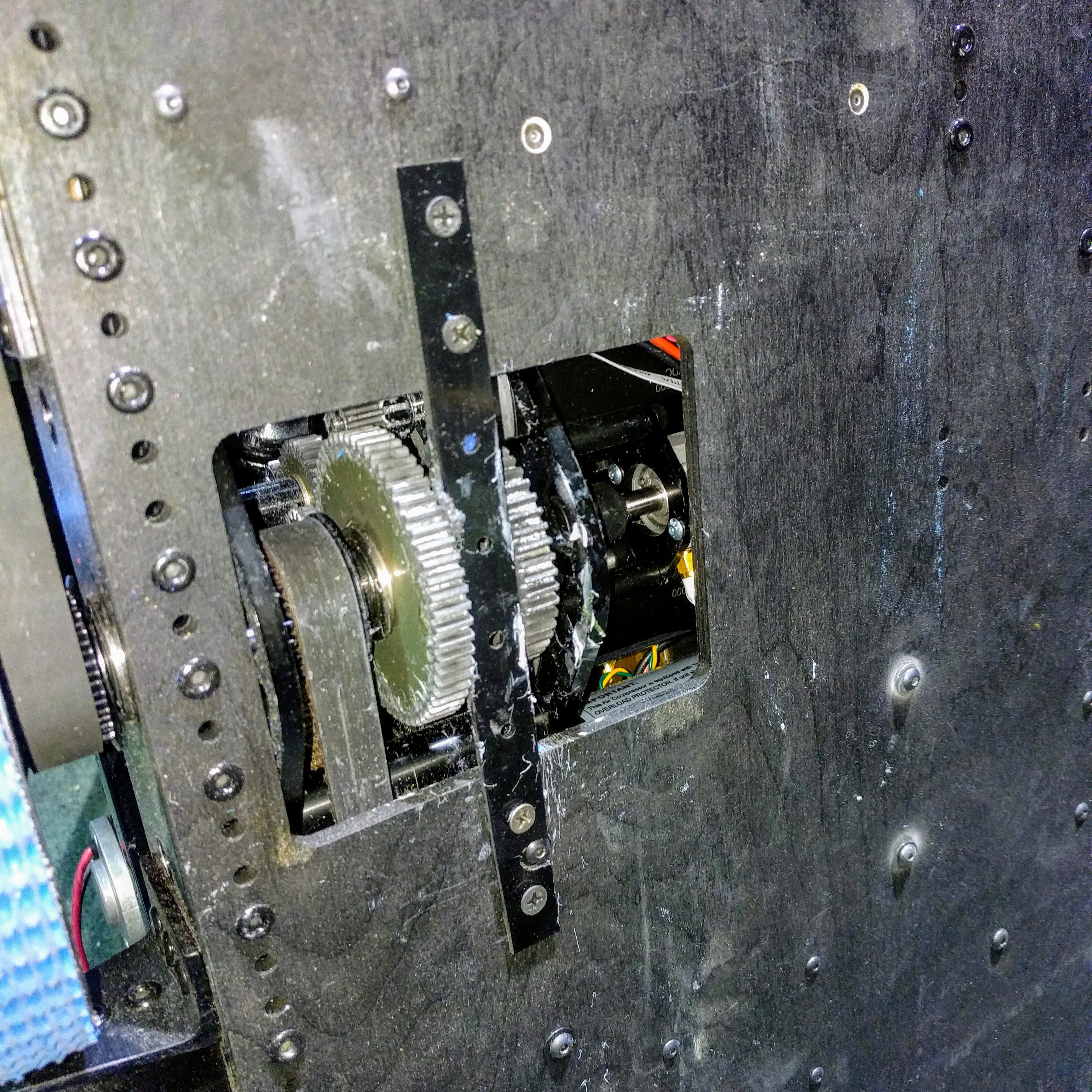

In 2018, at Pomona (LA) one of our gearbox plates got whanged and dropped a bearing out its bore, leading to a pretty chewed up gearset. We had neither the time or spares to replace the damaged parts. But we managed to get it all popped back in place and since the affected gears had almost half the teeth width damaged, we needed to guarantee the remaining good parts kept perfectly aligned. So the students quickly fabbed a polycarb spacer/bias plate and mounted it to the bellypan. I thought it was a very clean and clever “Jerry Rig”. Hardly Janky at all. It managed to survive all the way through finals - where 330 kicked our butts and won.

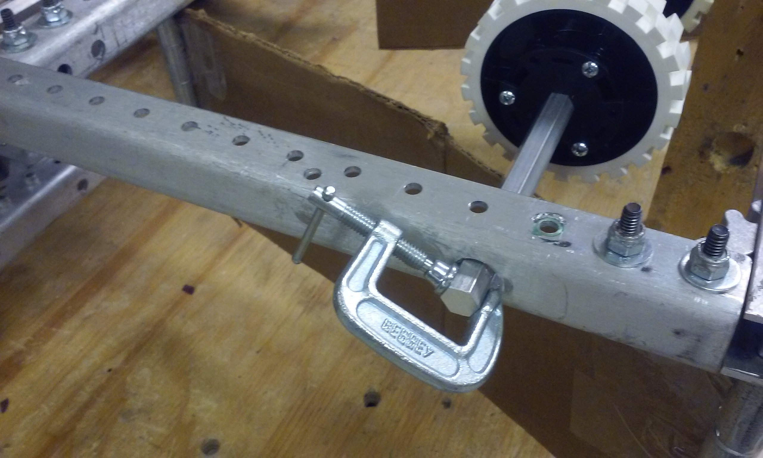

Prototype robot from 2016.
Ran out of collars, and hadn’t started tapping axle yet as a team (started doing that in 2017).
This worked for proof of concept until I could order more parts.

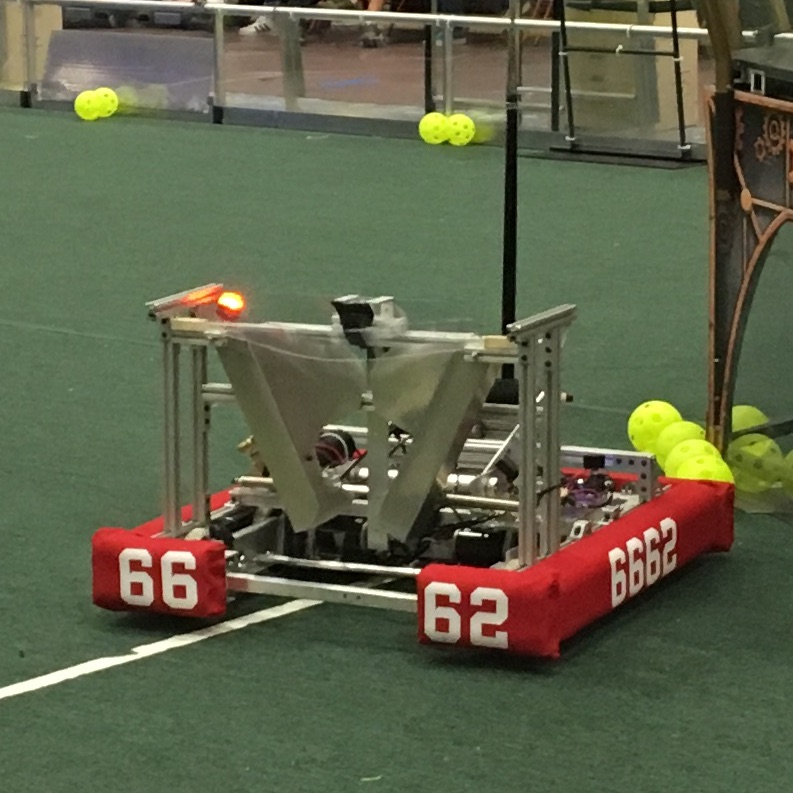

In 2017, when I was student, we realized quickly that our climber would have problems because the rope would move sideways as it wrapped around the winch drum, eventually slipping around the 1/2 in hex shaft, at which point we wouldn’t be able to climb.
So one of my teammates put pool noodles around the hex shaft and wrapped them with copious amounts of duck tape. She would wrap more duck tape around it after every match. We climbed 12/12 times in qualification matches and were an alliance captain.
You can kind of see our climber drum in this picture:
