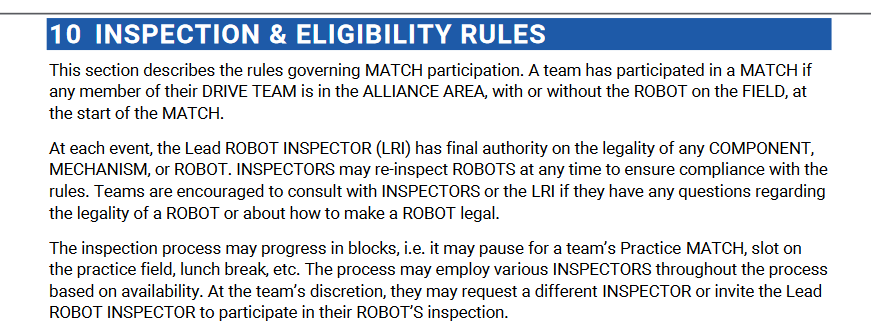

From the 2023 rules:
Last paragraph shown, emphasis mine:
At the team’s discretion, they may request a different INSPECTOR or invite the Lead
ROBOT INSPECTOR to participate in their ROBOT’S inspection.
You have rights as a team, ask for clarification, for a rule, or a different inspector. Don’t permit you or your peers to be held in limbo by non-rules at the behest of an inspector who didn’t clarify what they meant adequately.

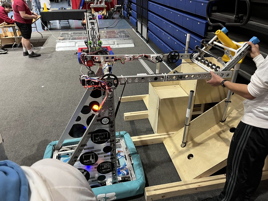

This isn’t relating specifically to bumper materials, but at States this year (FIM), our inspector warned us that in the future, the Inspectors are going to be more strict about what fonts are allowed. We passed inspection though. (This was our first year using custom numbers on our bumpers, and this surprised us because we’ve seen plenty of teams do similar things with their branding in the past.) Has anyone else heard this, is this something they’re considering changing in the rules next year?
For reference, these were our bumpers on our robot. (Red and blue are identical besides the color)
At a week 4 event we were shown examples of fonts that were considered acceptable and a bunch that were not. Your numbers would have been solidly in the acceptable group.
Yes. They have made a number of teams change their fonts. They are getting far more strict with it. For instance 33 no longer does the border around theirs. We were told the crosshair in the center of our “8” is no longer allowed, so we kept a paint pen on hand to color it in if they demanded it.
At the Great Northern Regional, we were told our numbers weren’t allowed because they weren’t solid. We had to use a paint pen to fill in our gaps. It definitely does say “solid numbers” in the rules but we thought it was pretty obvious what our numbers were. Lesson learned.
