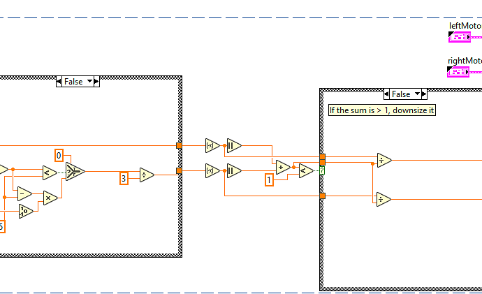

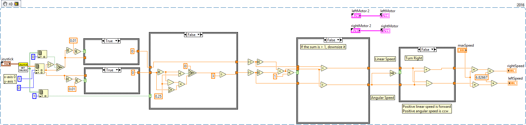

I can put up our actual arcade drive code - we actually utilized this to limit sideways motion. It was interesting, as our joysticks were square, and they needed to be normalized to a diamond of values (just linearly divide to get the point on the edge of the diamond with the same linear/rotational relationship).
We also did use deadbands (0.25) for the turning when going at full speed. When using our 1/3 speed, turning had no deadband. All of this was tuned from constant feedback from our driver, which made it perfect for him to drive. But I’m getting off track…
