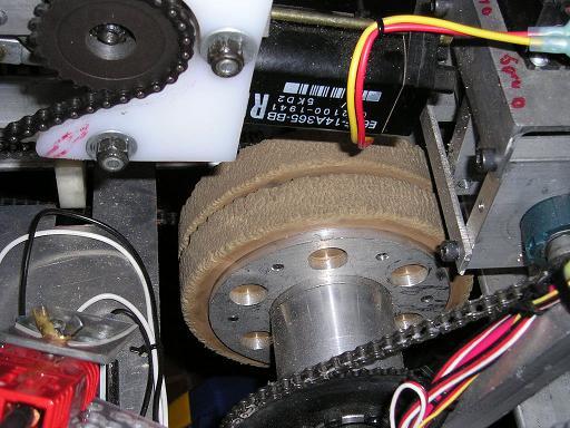

In 2003 we made our own 6’’ dual gum rubber wheels and they proved to be competitive to say the least! :ahh:

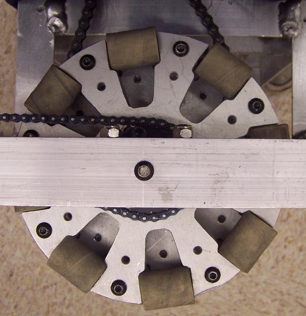

In 2005 we used two different types of wheels. We made our own gum rubber Omni-wheels for the back of our robot and we purchased 8’’ x 1.25’’ pneumatic castors for the front.

Just adding to his post… those wheels worked great. Here are some pictures.
http://www.sigmacatrobotics.com/images/gallery/albums/14.jpg
http://www.sigmacatrobotics.com/images/gallery/albums/2.jpg
http://www.sigmacatrobotics.com/images/gallery/albums/7.jpg
