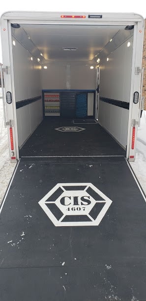

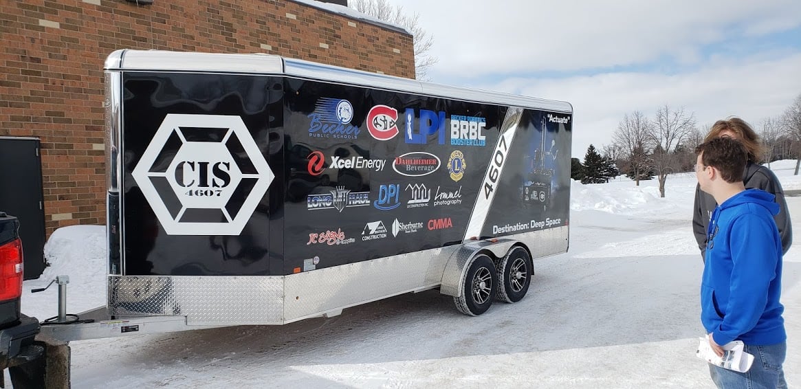

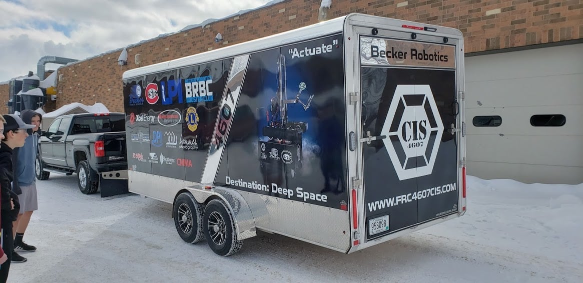

Can’t answer that specific question for you, but I can highly recommend R & R Trailers out of Three Rivers, MI. We purchased our new one from there a little over a year ago. To get the Force Elite customized was cheaper than purchasing a stock trailer from a dealer around here (MN). We added all the extras needed for hauling robots and our pit including an additional 6" height - well worth the money.
Here it is in all of it’s glory:
