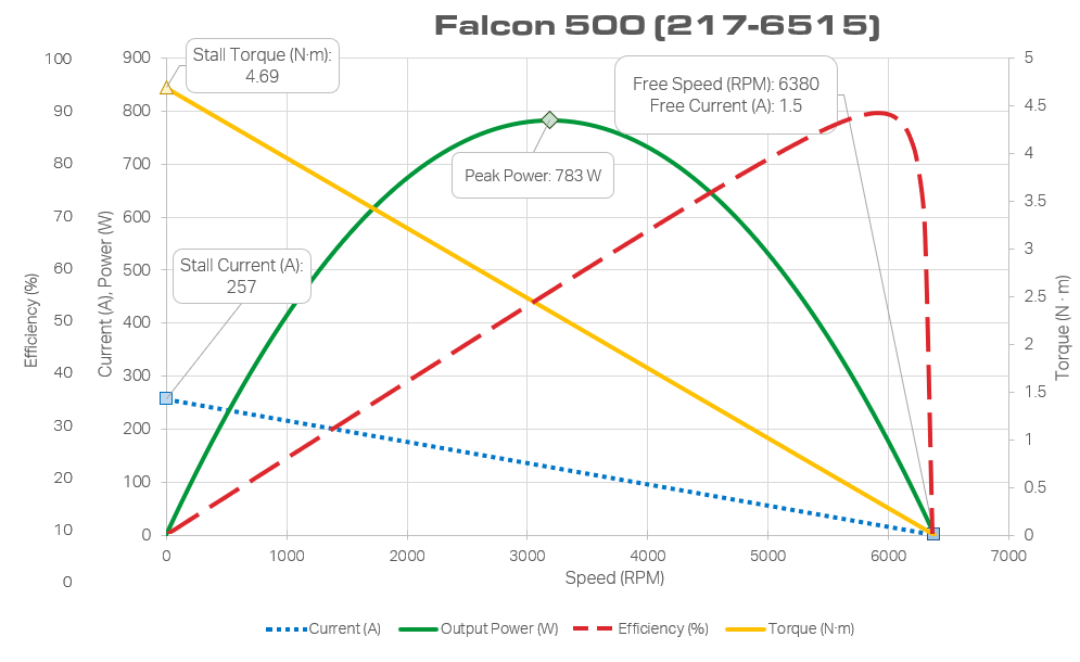

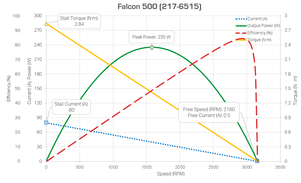

it’s not a brute force solution . it has to do with efficiency. this was heavily discussed and data was provided leading to the conclusion that “They were really whipin”
my understanding is It has to do with duty cycle and efficiencies of the falcons and torque per amp at different duty cycles. they found a way to significantly increases efficiency of the drive system. it starts to makes sense when you look at falcon motor curves at lower voltages, my understanding is 50% duty cycle corresponds to 50% of vbus when looking at motor efficiency curves . same total current draw for there drive system accelerates faster.
12v 1500 rpm ~3.6 NM ~200 amp draw .018 NM PER AMP
6v 1500 rpm ~1.5 nm ~36 amp draw .0416 NM per AMP
I’m not here to argue. Noones going to agree with me. In my opinion you are chasing efficiency you do not need. I guess brute force isn’t the best term as it clearly improves the efficiency of their swerve systems… but why. You can already drive at such a high rate of speed is my only point.
