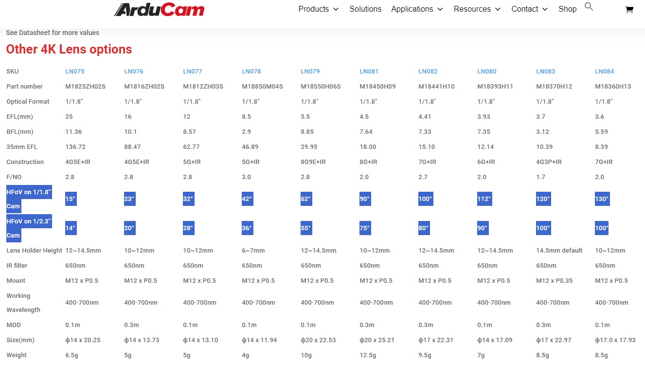

From your great suggestion specifically a list of resources would be very helpful to beginners that want to understand their selection of hardware.
A small example would be this M12 mount lens chart from ArduCam showing the Field Of View (fov) for different sensors (highlighted) and different focal lengths (higher up in the table).
How to read specs is a good skill to have and a tutorial on that would be helpful. What is the size of a sensor? What’s hFoV, VFoV, and FoV? Tutorial on how to read the specs would be helpful.
