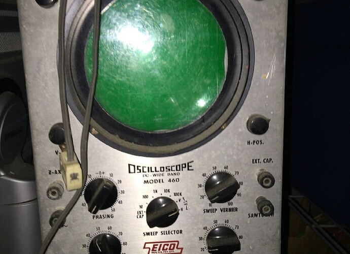

*Here’s a weird coincidence. The day after I started this thread a friend stopped by for a visit. During the conversation, and without my asking, he said he was going to have an auction to clean out the basement, and he had an oscilloscope he had inherited. That really piqued my interest so I asked him what brand and model. He didn’t know, but he texted me a picture later that afternoon.
Delightfully nostalgic, but not quite what I had in mind :frowning:
Tis a thing of beauty, all valves as well. Would most likely need the caps replacing, but she could run again.
I hope it ends up in a good home.
I found a scan of the original manual if anyone is interested: http://bama.edebris.com/manuals/eico/460/
If you happen to find out what he would ask for it (shipping to VA included), please PM the answer to me.
Oh boy, those are the kind of scopes most guys give away for free or very cheap at ham radio flea markets (hamfests). Actually I’ve seen that exact one before. It WILL need caps replaced on it. I can guarantee that. That would make a nice boat anchor scope to add to your collection.
