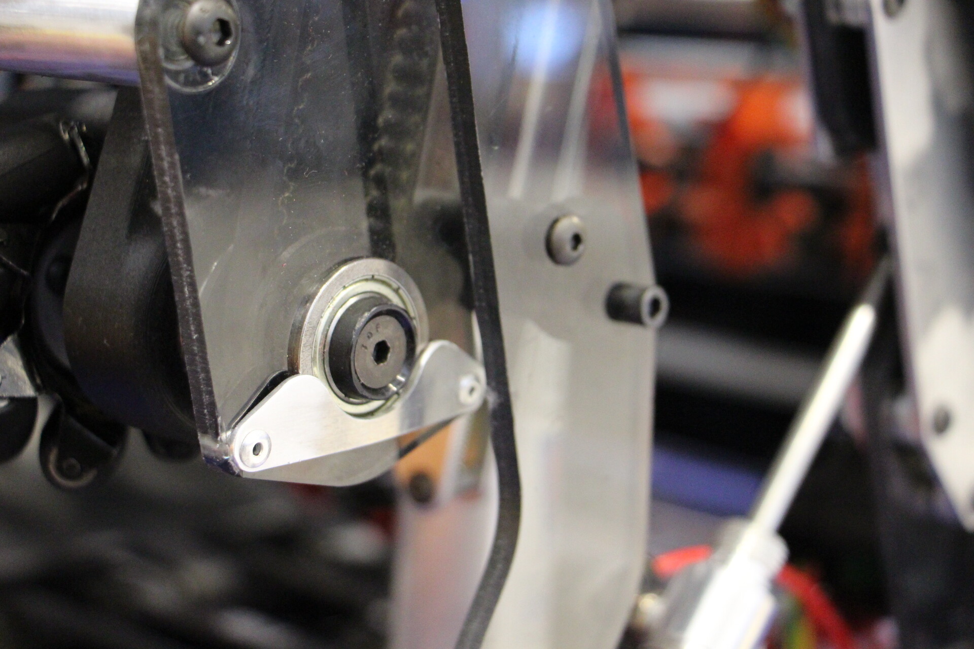

Bearing retainer for when you can’t have the rivets right next to the bearing flange due to what is on the back side of the plate.

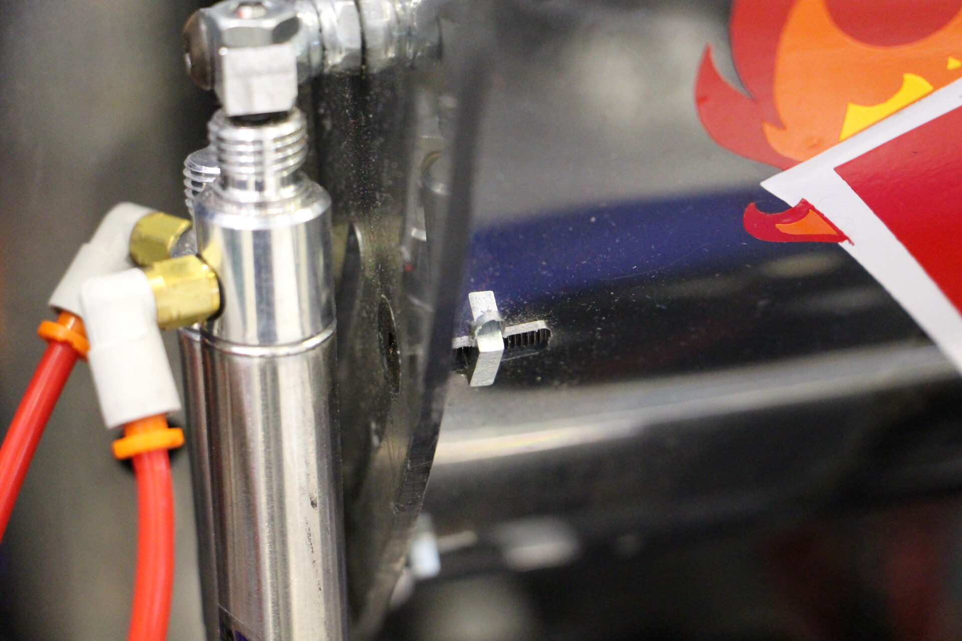

Square nuts and tight pockets so you don’t have to use 90* brackets to attach two perpendicular plates. This goes well with tab and slot construction.

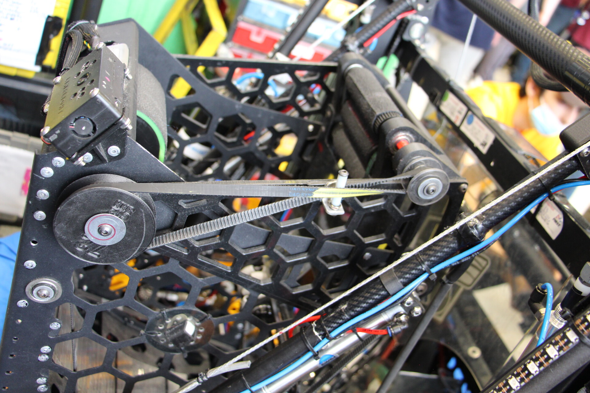

I have seen 67 do this multiple times for 90* power transfer, but this is the first time seeing it used for a full 180*. This is 33 fyi.
Interesting. I’ve seen this is polycord, but never with a timing belt. I’m curious how they determined the center distance belt length. Can it be calculated or do you just iterate through different tooth counts until it is right?
Curious about the method for getting the tooth count/center distance correct too. We did something very similar on our 2020 robot, but went about it through trial and error.
We did this on the 2020 intake using a pin separator like what 33 is doing. Center to center was trial and error.

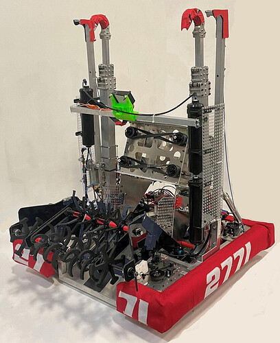

2771 did it on their shooter with larger belts an NO pin separator with no reported issues.
I wonder if they had any jumping issues with that belt, that pin might also work as a tensioner to make the center to center easier
