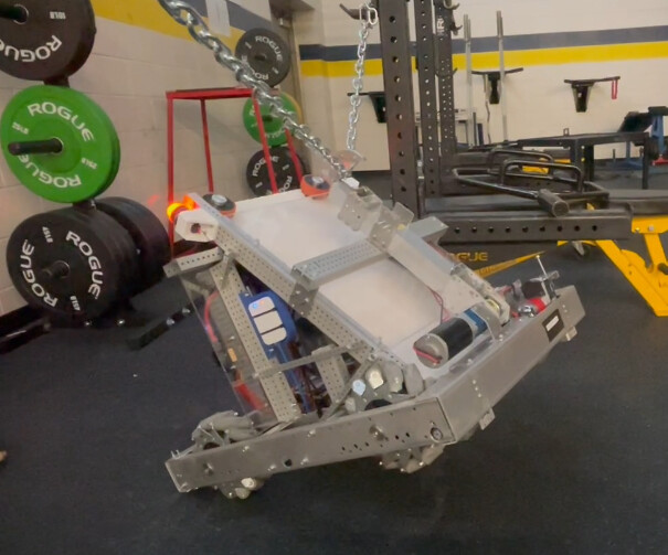

Currently our bot doesn’t get off the ground, our arm is too off center for a pivot point and there is too much weight on one side for it to climb as is. I’m wondering if it would be best to put two arms in the center going straight up vs our current arm which is aligned next to the bumper and at a 55 degree angle. I feel like we could fit 2 going at 90 degrees and keep them perfectly in the center
Can you climb to one side and use “lean against the truss to balance the robot”? That does require a higher reach to get to the chain…

It’s hard to give a really technical explanation without a picture or more information on the robot. But as a very, very broad generalization, your robot is going to “rotate” around the point of contact with the chain until the center of gravity is under the chain, unless the robot contacts something to brace upon first.
Do you have a picture or drawing you could share?
Also requires a hook that locks on to one of the links in the chain, especially if doing harmony.
