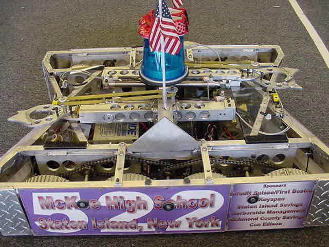

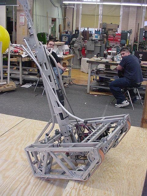

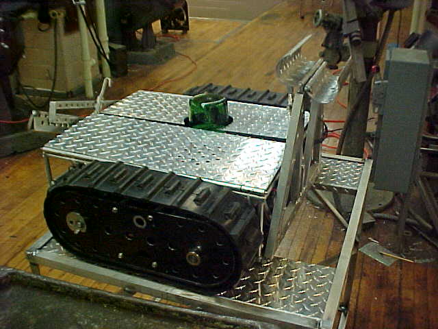

Team 522 also has used belt drive in 3 out of the 4 years of their exsistance and found it to be quite dominating if you use the right belt for the right game for the right surface the robot was running on:
2001 - Their robot used belt drive
Pros: it was superior for pushing a disabled robot to the end zone for pts.
Cons: it appeared they had some issues but not major ones when the robot was run in reverse.
2003 - Their robot used belt drive
Pros: it was superior for traction & as well as being immovable when it came time to be king or in the robots case “QUEEN” of the hill.
Cons: Non really noticeable A job well done by that time.
2004 - Their robot used belt drive
Pros: same as above & it was superior for climbing capability
Cons: same as above
C:\ START RANT HERE
Some teams have their different opinions about belts: belts are good for one thing but have their defects. I would choose belt over chain any day
  1. belts won’t damage the playing surface but will pop the balls due to friction unlike chains which can either scratch / tear the playing surface and possible pop the balls.
  2. Traction - Different belts give you different traction capability unlike chain
  3. I personally think that belts are quicker to change then chain
    3a) if the robot is designed a certain way the chain may not fit the same way when you first put it on - almost as if it changed its size magically - this statement is just off of speculation and not an actual fact
    3b) you have to fiddle with getting the half / master link on
    3c) there’s the slight off set that you could lose a part critical to keeping the chain in one piece
    3d) for belt drive if the robot is designed a certain way the pulley / sprocket systems can be un - bolted and removed so that you just drop the belt ride in place and bolt everything up.
    3e) as said before the belt is in one piece already
    3f) a part lost on the floor for a belt system can easily be spotted / replaced
Attached at the bottom are some pics i found on delphi of team 522’s robots.
