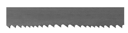

You ideally want variable pitch/variable set blades. These help lower vibration and cut more smoothly. You can see below how the teeth are at different pitch between teeth as well as the root of the teeth are at different heights.
a 10-14 variable pitch/set blade is going to be good from ~0.25" to 1.25" but its sweet spot is going to be closer to the middle of that range. For a vertical bandsaw and FRC materials that is probably actually a little too coarse and 14-18 would be better.

with 10-14 TPI the teeth will be .10"- .07" apart so if you’re using stock with .063" or thinner walls or plate the stock can actually fit into the gullet instead of scrape along the surface of the cut. When your stock falls into the gullet of the teeth you will get very high chip load resulting in reduced the life of the blade and quality of the cut, and increased vibration and noise.
