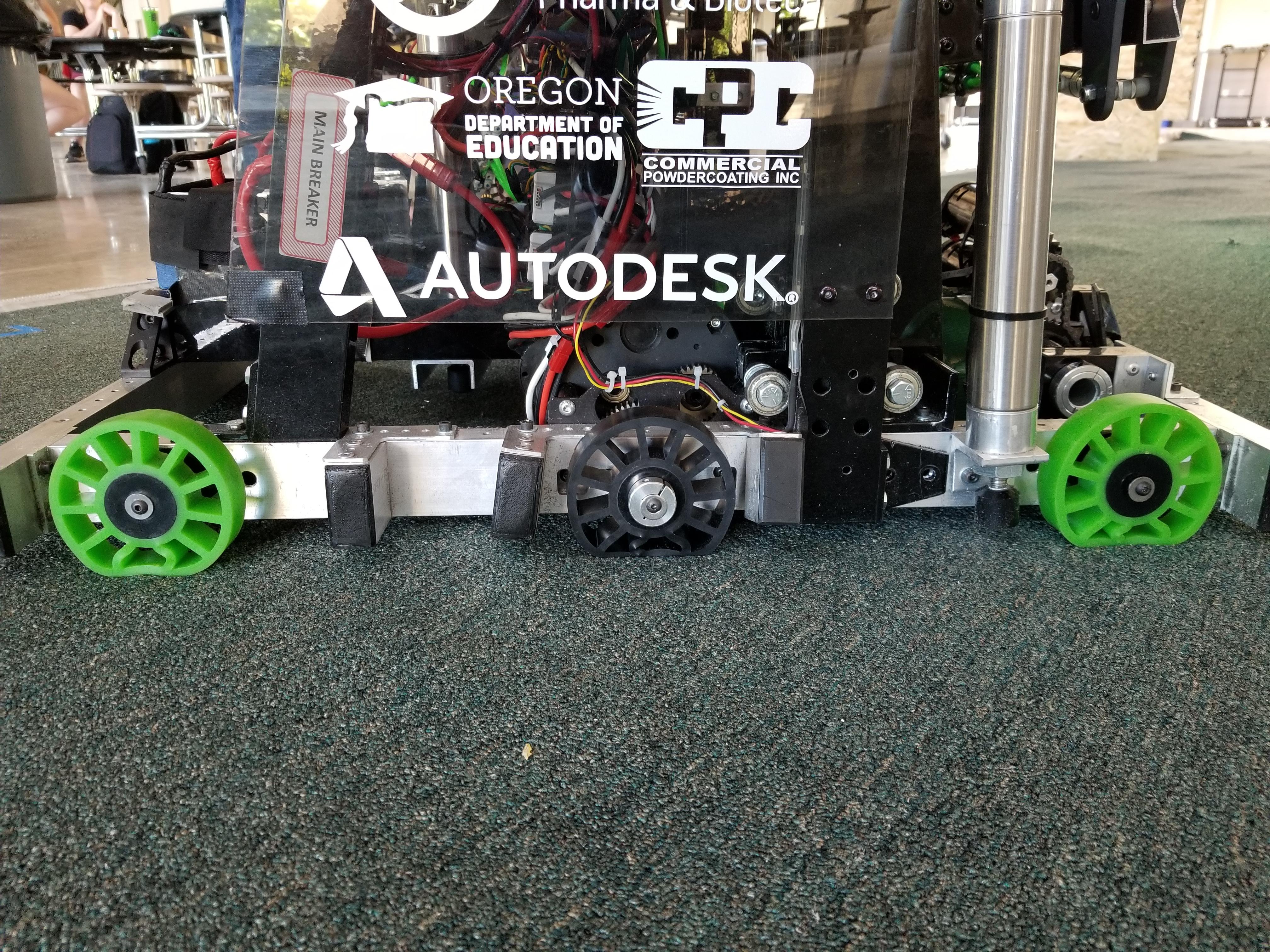

Zoinks Scoob
As much as 6% error according to our tests caused by carpet nap which is too bad, we loved the Colsons but have moved on…
If it wasn’t for that, Colsons are great.
It drove too.
Credit to 5468, it’s their 2017 robot they slapped the wheels on.
Wow, that’s amazing. I didn’t think it was anywhere near that bad.
