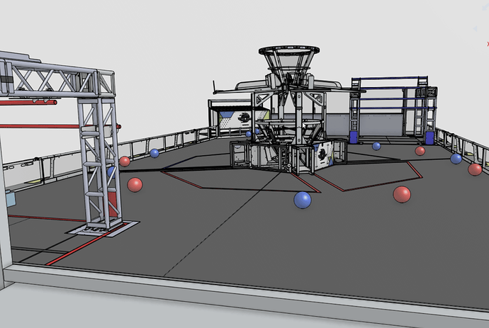

I think people are dramatically underestimating how hard cycles will be this year.
  • Game pieces will be in completely unknown locations on the field, making it significantly harder to practice for
  • Balls will be constantly moving/bouncing from:
    • Coming out of the goal
    • Teams shooting and missing
    • Teams intentionally shooting the opponent balls in random directions
  • It will be a super defense heavy game:
    • The only safe zone on the field is very far back from the goal
    • Teams can pick up all balls they see and shoot it at the goal or away from it based on the color, for turreted robots this is even easier
    • Combination of the above two means for the first time it’s feasible that all 3 robots on an alliance play defense in some form or another
  • The vast majority of teams will never practice under any realistic conditions:
    • 6 robots, 22 balls, balls bouncing everywhere and congestion on the field are totally different from a single robot lining up to shoot
    • With omicron many teams will find it even harder to meet/practice
  • It’s one of the most driver/coach skill dependent games ever, similar to 2014 but with a more complex game
There will be some very high scoring matches from elite teams, but I don’t see teams maintaining high averages
